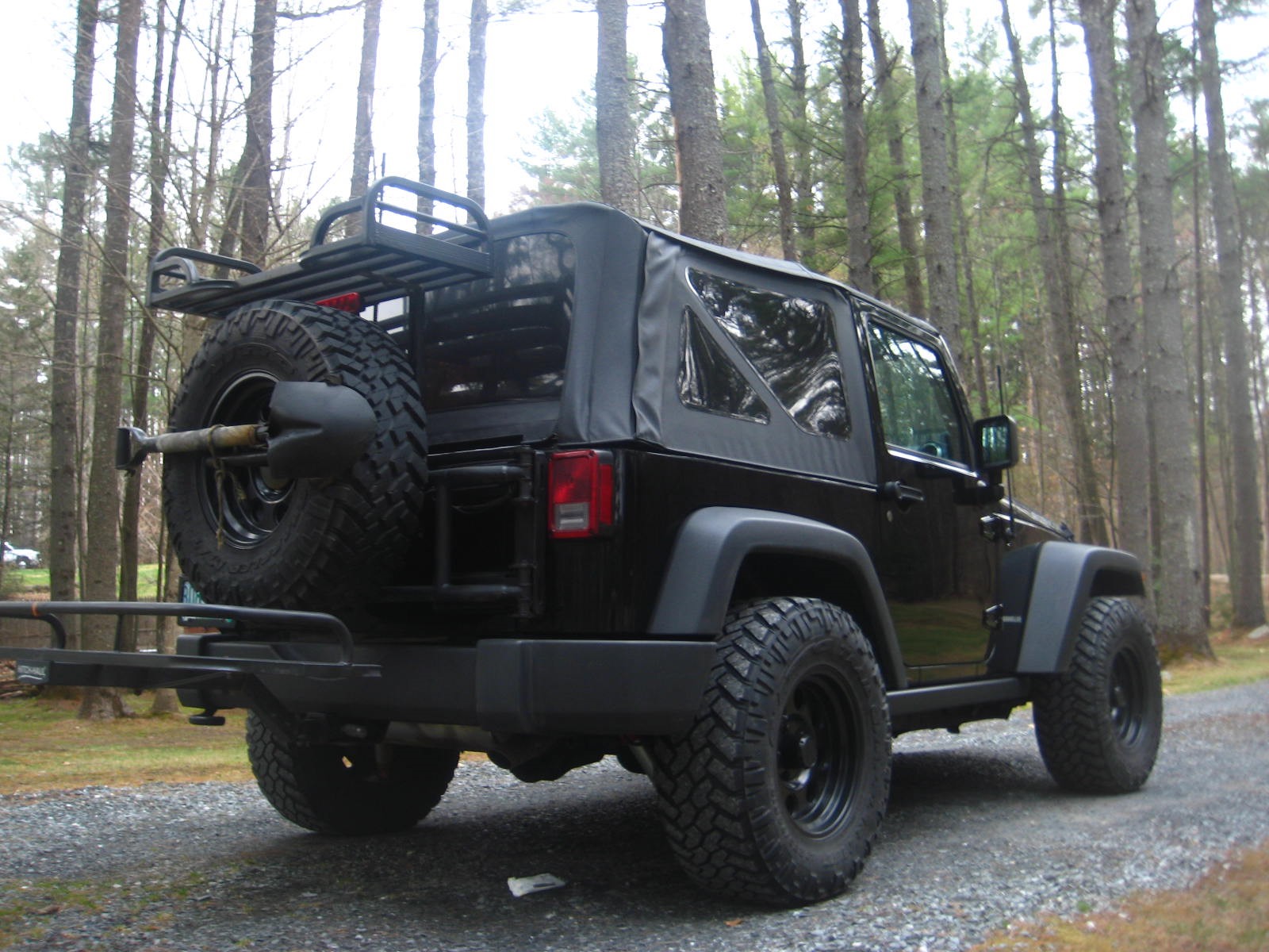

Default id def concider getting one for the rear of mine
any idea of cost for one of these little buggers ? btw will they come with a cover shield (plastic) ?

I do have an idea of the price they might sell for, but it's not my place to announce that - I'll let the company annouce that when they're ready. I'll repeat what I said the other day though...
Originally Posted by jscherb
These pods compare very favorably with the KC Flex LEDs on a spec basis, but at the price the supplier charges for them they should be able to retail for a fraction of the KC lights
An optional plastic cover is not part of the initial launch.
