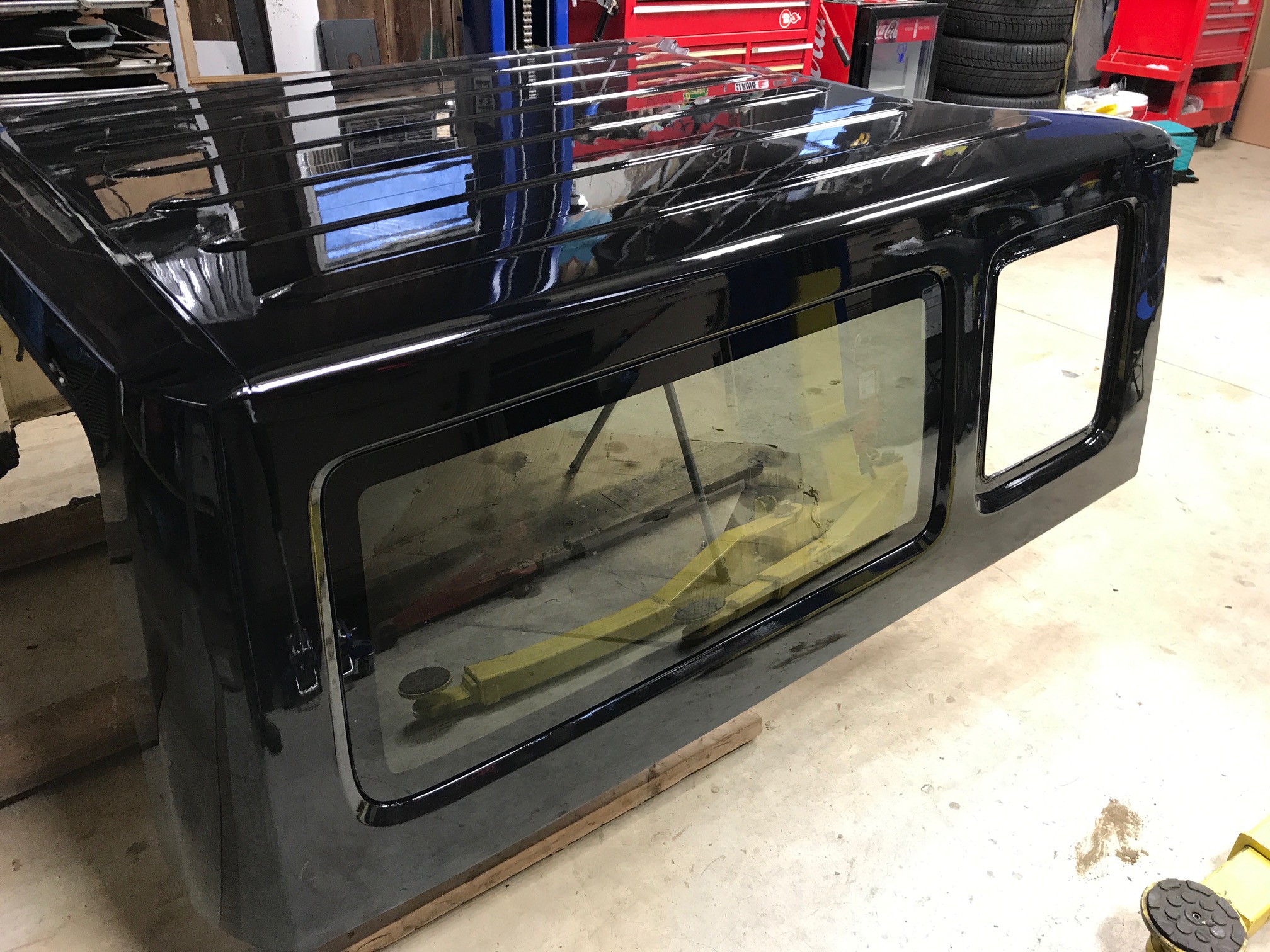

I installed the new skylight hinges yesterday and they checked out fine - fit is great and they seem to spring back and hold their shape. The photo below is a quick shot showing the full set of preproduction hardware in place (ignore the lights in the ceiling of the room this hardtop is set up in ).
Now that I've got the final hardware, I'll install a skylight in another Freedom Panel, photographing and documenting each step of the installation in preparation for writing the instructions for the kit.
Jeff, I finally got back onto my JK* project and just had it painted. Can you tell me where you sourced you hinges and latch. I have decided to make the windows vent rather then having them in the fixed position. I was looking at the way the FJfreedom pop out widow kit worked and I thought it would be nice to have the window removable. Unfortunately they have not responded to my email or phone calls. How did you fasten the hinges to the shell? I will have to bond a mounting plate to the inside because that part of the top is single ply. Thanks for any help you can provide.Click image for larger version
