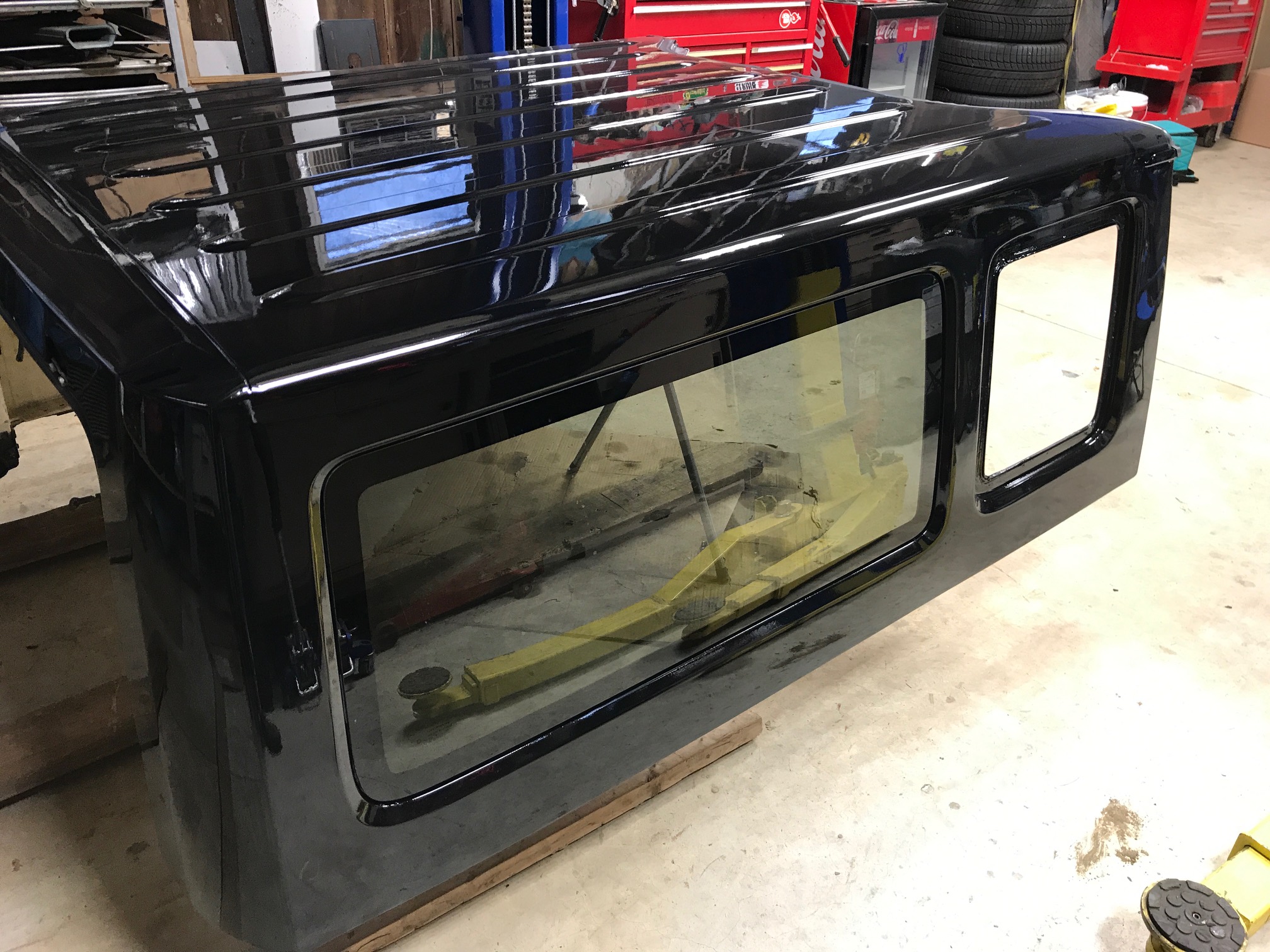

Jeff, I finally got back onto my JK* project and just had it painted. Can you tell me where you sourced you hinges and latch. I have decided to make the windows vent rather then having them in the fixed position. I was looking at the way the FJfreedom pop out widow kit worked and I thought it would be nice to have the window removable. Unfortunately they have not responded to my email or phone calls. How did you fasten the hinges to the shell? I will have to bond a mounting plate to the inside because that part of the top is single ply. Thanks for any help you can provide.Attachment 676392
For a one-off project like yours, if there's a u-pull junkyard near you a visit there may turn up parts you can use. Check out the pop-out windows on minivans and extended-cab pickups, chances are you'll find something that will work.
I sourced the parts for the powered pop-out vent windows of my JK Safari Cab at the local u-pull; the motors and related hardware came from a Chevy Venture minivan; the hinges are from a late 70's FJ40 hardtop and the power switches are from a Land Rover Discovery. The glass I had custom made and tempered.

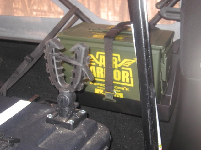

i guess the air armor 240 has a 20 min cycle
it fills a 35 in under 5 min
mine are 33s so i havent needed to go beyond that time line of 20 min
i do like the portability of it in the ammo can .
its worked out well for me seeing i dont run it over that 20 min time period anyway.
i do like its rugged construction and components ( A worthy investment) for the average
daily driver weekend trail type drivers. for the price , i think its well worth it, but obviously its not arb twins onboard
I do prefer the rubber 25 ' hose over coil type just because those are a pita usually from my experience

Jeff, I ended up putting the windows in fixed and not operable. Installed the top last night with my son and it turned out great. The next part of the project will be to make some insulating panels for the new top. It was too cold to wash the Jeep so a final pic will have to wait. I can't thank you enough for your help and all that you share on the forum. I would never have taken this on without the info you have shared with your builds. Thanks again.Attached Thumbnails
