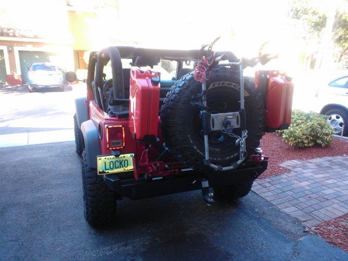

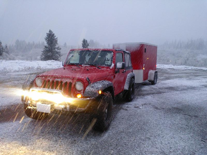

Default my expedition wrangler!
Name:	ready for more travel.jpg
ID:	390957Click image for larger version
being to all the states in my sig with it !

How did you manage to skip Washington state?

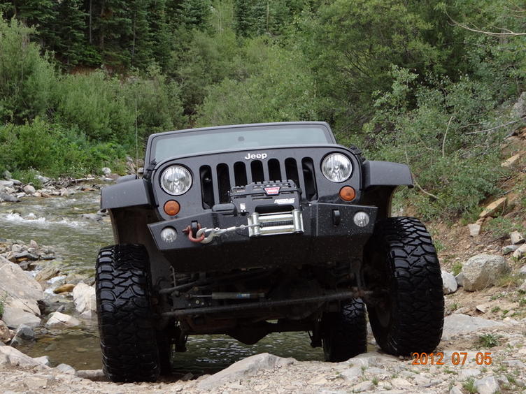

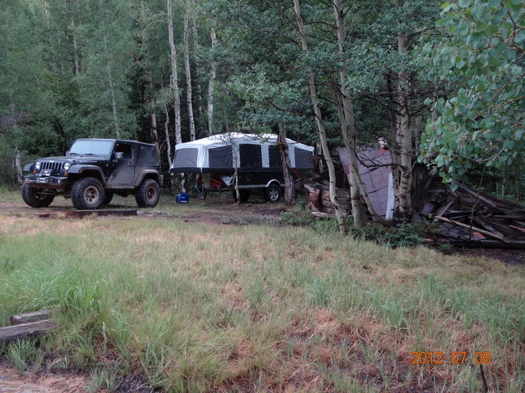

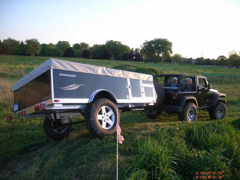

Default my expedition rig

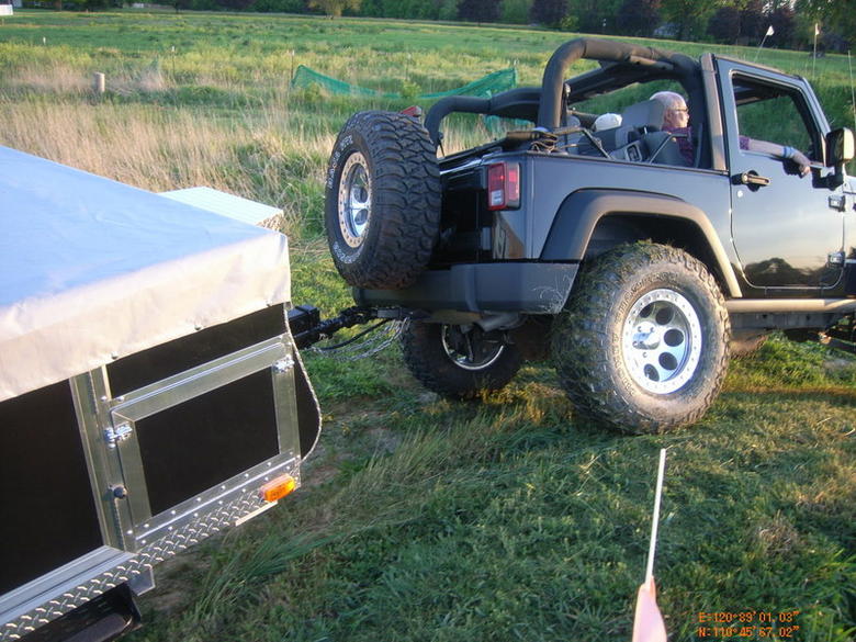

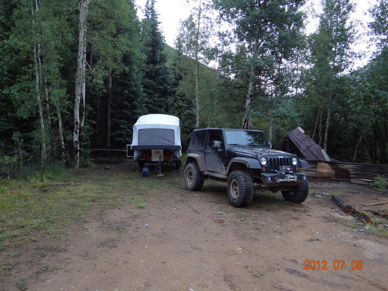

3.5" AEV RS lift, 35" Mickey Thompson MTZ on 17" Mickey Thompson classic 2 with OMF beadlock rims, Warn 12,000 lb powerplant dual force winch , Nemesis Odyssey aluninum front bumper, Road Armor trail doors. Trailer-Livin Lite 10.0 aluminum offroad pop up 2.25 lift custom built by RDH475, full articulation hitch built by RDH475, two 5 gal jerry cans mounted to diamond plate tool box on tongue, custom fold down spare tire rack, Yamaha generator

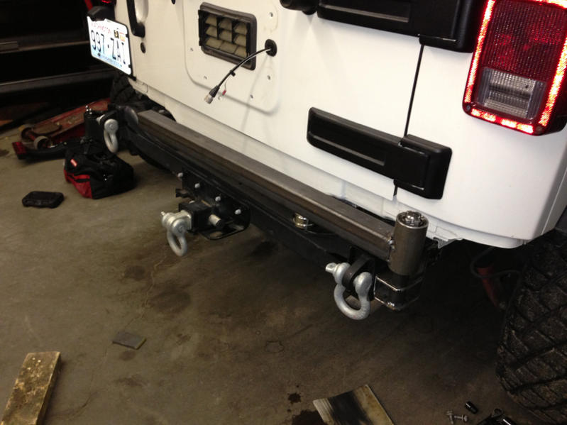

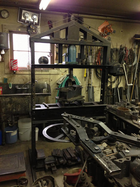

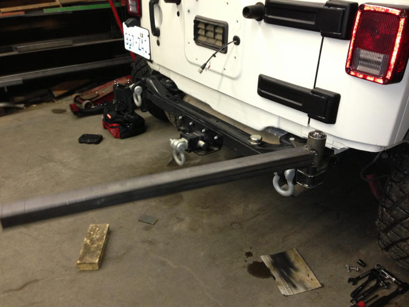

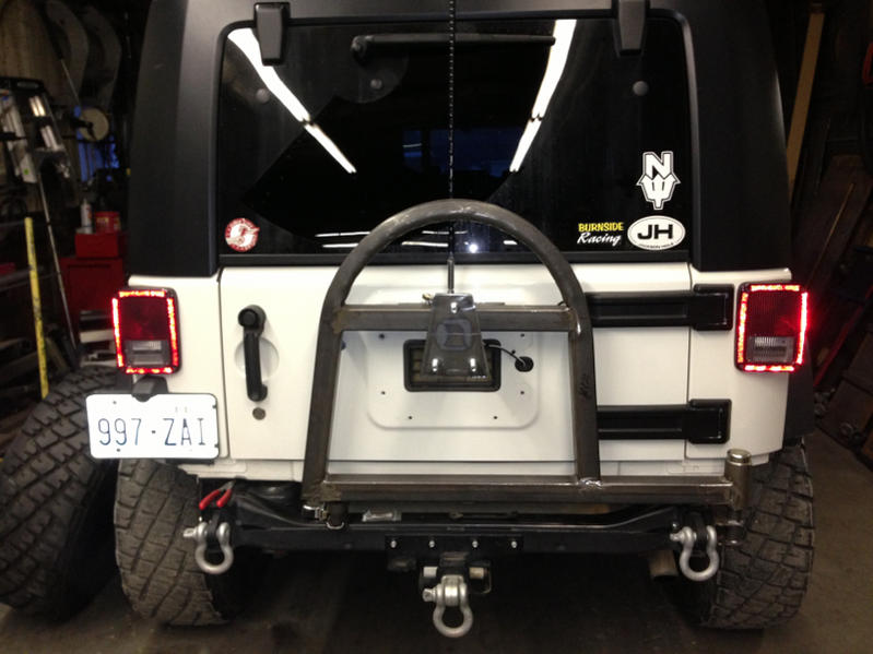

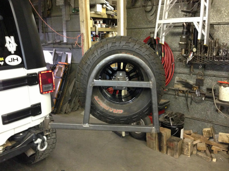

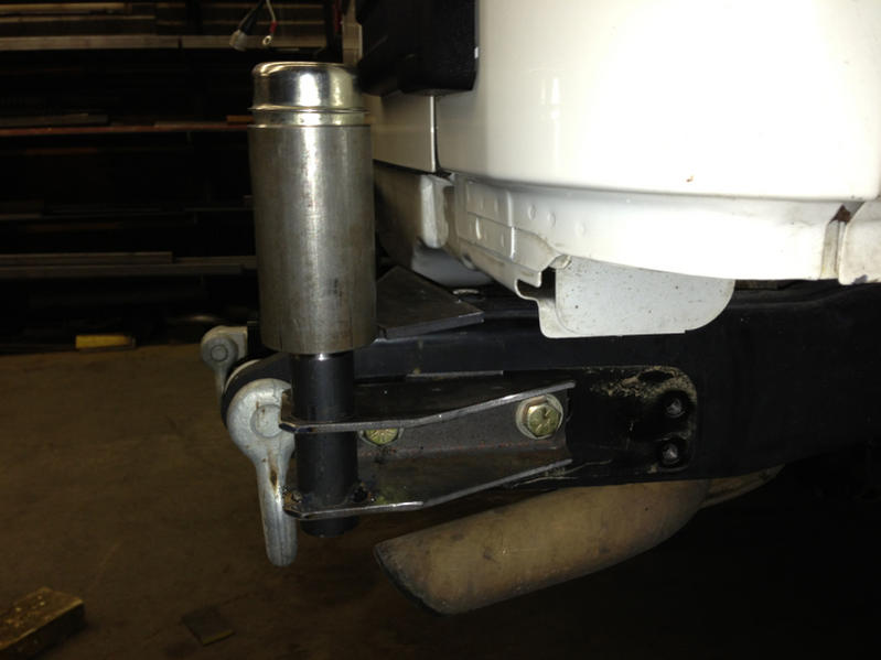

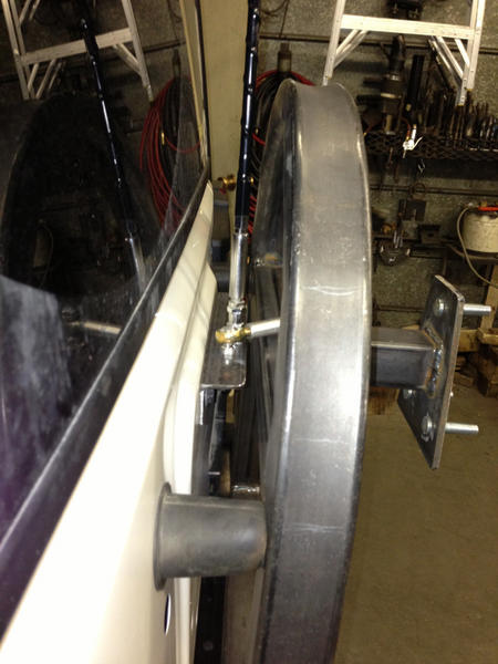

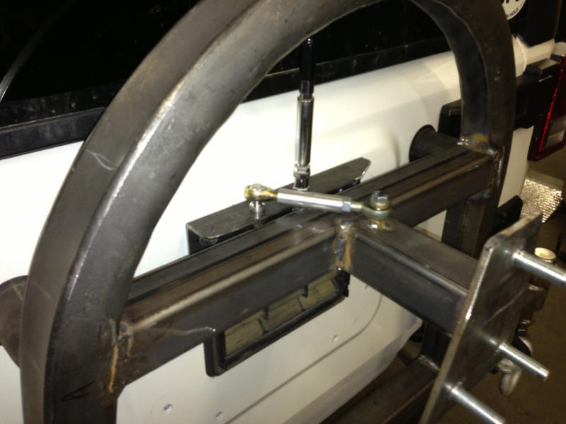

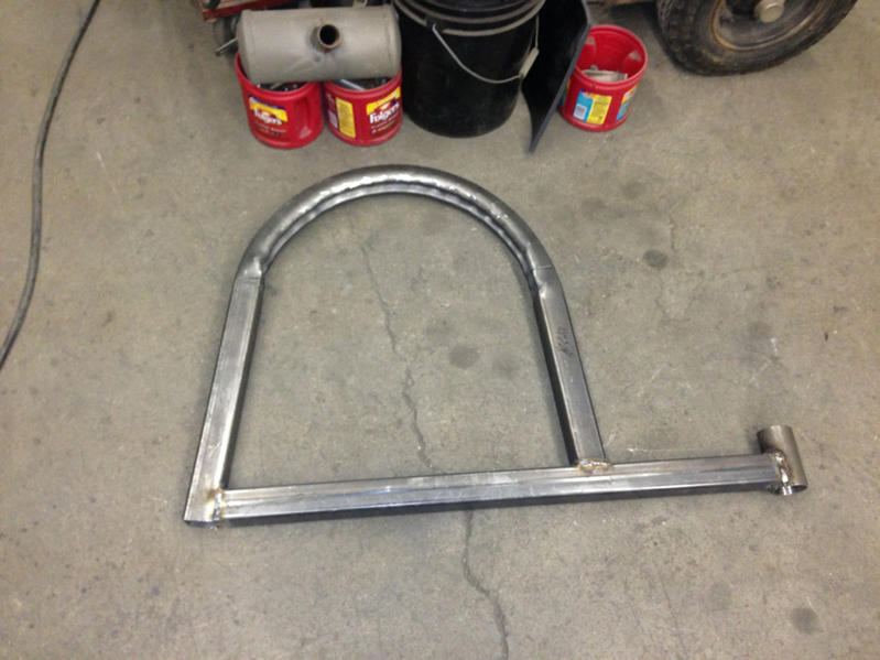

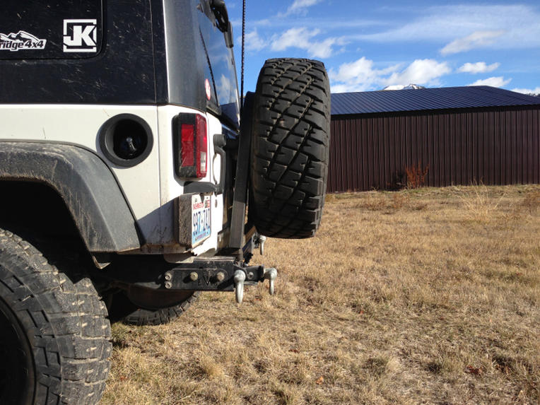

While I'm in Wyo. for Thanksgiving I took advantage of my dad and grandpa's shop and fabbed up a tire swing. The rear door had developed a squeak and rattle. I moved the tire up 3" and in 3" and I'm pretty happy with how it came out. The hoop we made took about 4 hours to bend. We did a majority of it in the press, little by little.

Sweet! Nice job!

Extremely well done...
