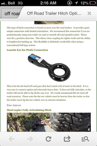

Do u guys use pintle hitches for all you're army trailers ???
Yes sir!

Originally Posted by xerofall
Yes sir!
Can u tell me pros and cons of using them?
Old Feb 6, 2013 | 08:35 PM
  #2276
xerofall's Avatar
Joined: Jul 2008
Posts: 2,088
From: Tooele (two-willa), Utah
Pros:
Not many thieves have a pintle hitch, so I don't need to worry about someone hooking it up and driving away.
Won't pop off while off roading. I was towing a U-Haul trailer in a car once and it popped off the ball hitch. Destroyed my car and everything in the trailer. The U-Haul people said THEY had to hook it up to my car for insurance purposes, yet when it failed they denied the claim saying I didn't purchase the correct insurance to begin with.
Cons:
Not many cons yet, but perhaps resale, like I said not many people have a pintle hitch unless they buy one or you include one if you were to ever resell the trailer. The one I bought cost me $100 bucks total and I had to go to three different places to get all the pieces.
They sell linkage hitches specifically for off roading that have super articulation.
Pros:
Cons:
I heard they are noisy??? And clanky???
A pintle hitch would probably be cheaper that a specially built offroading hitch , expechially if u won't be going "too extreme " pulling a trailer
My friend with the Rover and JKU has a pintle hitch on his trailer. It is noisy and for that reason he is going to replace it. If you want the (limited) security that a unique trailer hitch can provide, you might contact Adventure Trailers in Prescott, AZ. Their unique hitch allows full rotation of the attached trailer. Which means if you pull this number, you won't mangle a lot of sheetmetal and really have a problem getting the trailer out of wherever you're at ...
