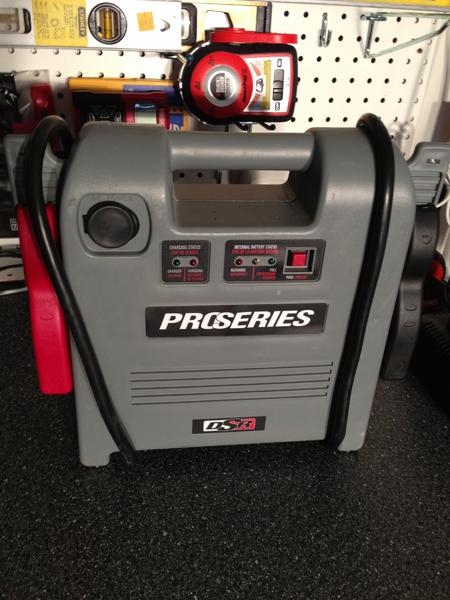

Not a battery per se, but I got one of these as backup. It has served well so far. I am very tight under the hood with supercharger, relays, etc. so this was a good alternative for me.

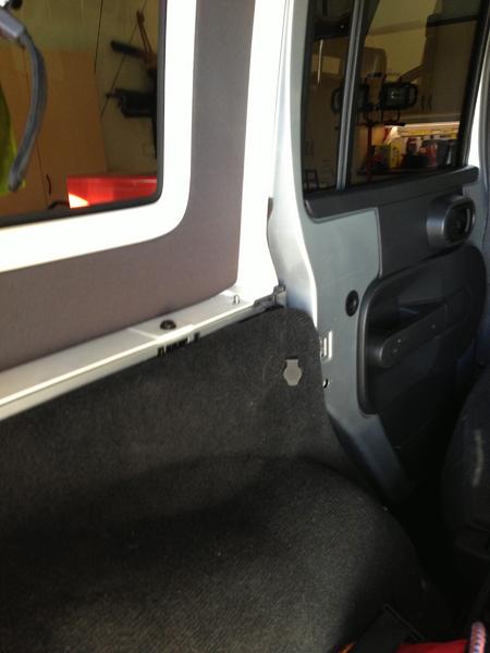

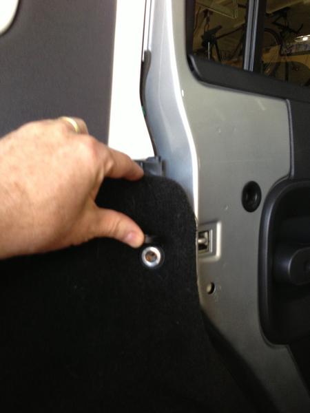

I also invested in (not an inaccurate term for what they charge for it) the ARB wiring harness for the fridge. It eliminated the goofy cut off problems I had using lighter gauge wiring. I installed it direct to battery and put the outlet here:
ID:	407449Click image for larger version

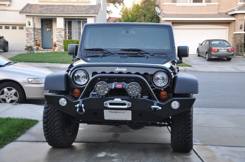

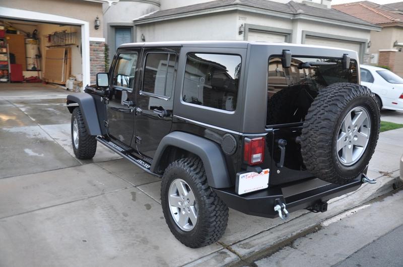

Here is the begining of my Overland/Expedition build (2012 JKUR, Auto, 4.10 gears):
ID:	407552Click image for larger version
ID:	407553Click image for larger version
ID:	407554Click image for larger version
ID:	407555Click image for larger version
Completed mods:
  • Expedition One Front/Rear bumpers + RubiSkid plate + Rockrails.
  • EVO Skid plates.
  • Warn 9000lbs Winch & Dual beam lights (mounted to front bumper).
  • ARB 50qt. fridge/Freezer & ARB On-Board Air System (CKMTA12) mounted under passenger seat.
  • H3R Performance HalGuard 2.5lb. Premium Fire Extinguisher mounted on rear roll bar.
  • Tuffy JK Conceal Carry Security Drawer + MAG light mounted to side of driver seat.
I am currently working on a custom dual battery tray with Sears Diehard Platinum batteries and Blue Sea Systems ML-Series Heavy Duty Automatic Charging Relay.
