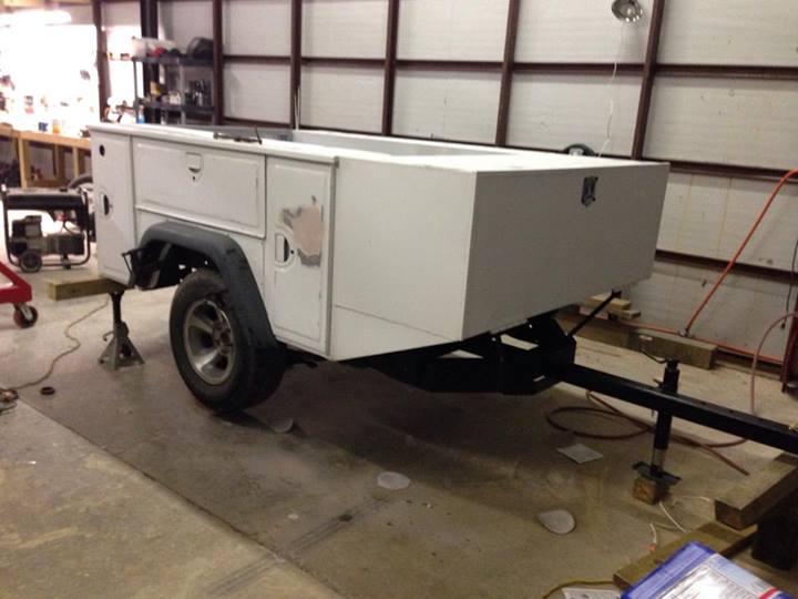

It had this camper top on it when I purchased it but I've since pulled it off.. Its a really cool setup but I can't hardly set that monstrosity up by myself in the wind or rain and It keeps me from being able to haul my mountain bikes with me. (its for sale $300)..
My 10a and expo trailer project. Its a utility bed from a chevy s-10. Its in the body shop now being lifted 4", matching wheels/tires, cargo rack and color matched rhino liner. Been on the fence forever about using an RTT or not and decided to just use a 5x8 tent on top instead. A little more versatile than an RTT I think.
The lift is almost done now. It still has the chevy axle under it but I decided to pull it and install a 3500# regular axle kit. This is temporary as I plan on building a new frame for it and getting rid of the (VERY) heavy chevy frame that's under it now. Weight savings is the name of the game here.. On the new frame I'll put a timbren axleless system under it.

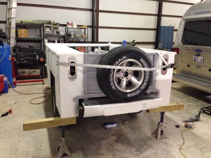

Installed a set of TJ fender flares to give it a little more rugged look and trying to figure out how to fab up a rear spare tire carrier. I need a little more weight on the rear since the front box is super heavy duty. It's all I can do to lift the hitch up now. With the camper top on it, it was very balanced, about 150# of tongue weight. Now its considerably higher.
