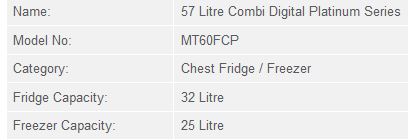

Originally Posted by GJeep
Ah... It may be fridge OR freezer, because they don't specify separate volumes for each.
Yes, they do...

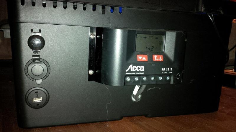

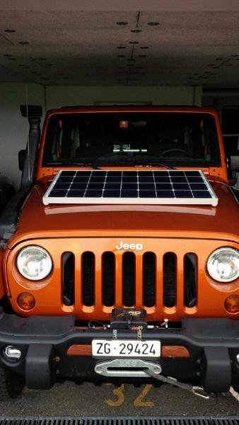

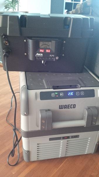

Originally Posted by kevjeep
I think of my days of boat ownership and using a house battery to charge and run multiple accessories (including a fridge) for a day or two at a time without charging or shore power. I'm trying to think through the ramifications/issues of doing something similar in the trailer configuration.
Thanks in advance for all your input and opinions.
Some carry solar cells, which are better for those who stay awhile in one place.
Solar guy here.
Don't have a trailer, but I do power my 35l fridge with a 75Ah battery that gets it's charge from a 100W solar panel.
I can run that fridge and charge phones and GPS for 4-5 days without sun. When it's sunny the battery is always full.

Originally Posted by crusaderJK
Yes, they do...
Attachment 605597
Oh, thanks !
That's good, because I consider the Engel, and the ARB as second in priority.
(just didn't delve into the specs/models yet.)
Everyone I know are using either the ARB or Engel, for years, without any problem. I was the only one with a cheaper fridge, which eventually quit working for good...
The way I'd use it is to fill most of the freezer with ice packs. In case the batteries run low, because of much winch use or whatever, I can pull out the divider plate, shut it off, and let the ice keep it cold until the batteries are fully charged.

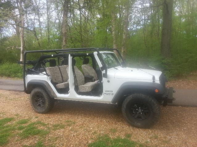

Got my new rig started. Now to get on a trail!
Attachment 605686
I see you have the Bestop tailgate rack. Did you already have it on your previous JK and can tell how sturdy it is?
Yes, it was on my other JK. I think it is rated for about 75lbs. I use it for camp chairs and other camping gear that is either dirty or stuff that can get wet.
