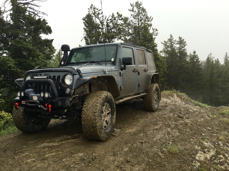

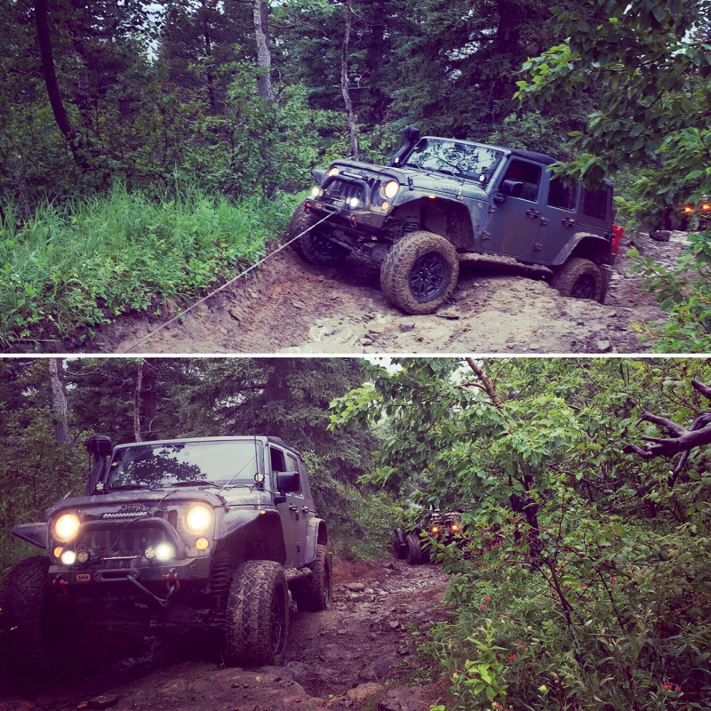

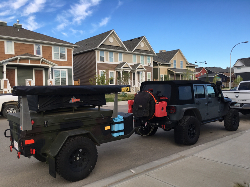

Here is our jeep...built for overlanding and still have good off-road use.
Next on the list of to do's is a slide for the new ARB fridge in the back and a drawer system for storage.

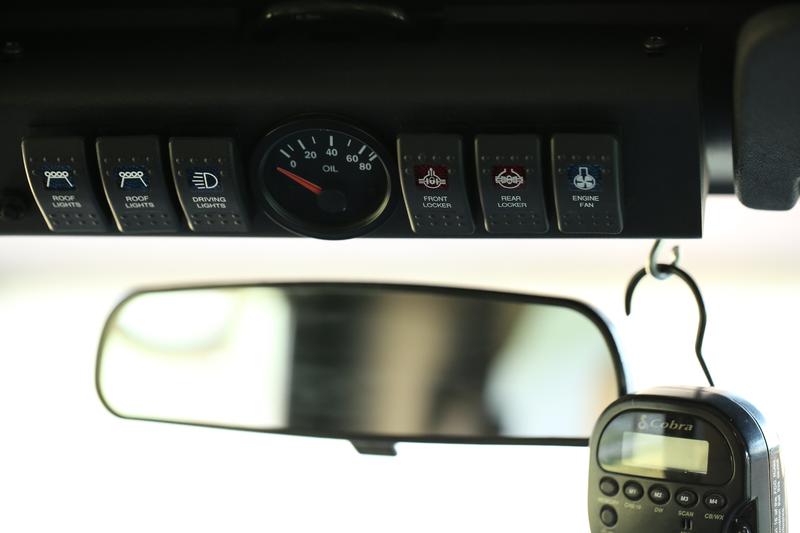

Just received an e-mail from OTRATTW where I bought the custom toggles for my sPOD controller. It appears that he has restocked some of the colors he was out of. This applies only to the Contura II toggles--Contura V toggles he laser-engraves on demand. The Contura II toggles are silk-screened, so won't backlight like the Contura V. But, they look more consistent with the older JK interior ...

I will be switching out the roof and driving lights toggles for amber.
Hey Mark,
First off, huge fan of your videos, and I loved your most recent Alaska trip!
Secondly, I know this is an old post, but I was wondering if you could explain a few things about your sPod set up (or if you've changed it)
I noticed you have an Engine fan switch, do you have a secondary fan installed if not what is the reason for that switch?
Also, the Oil gauge, is that an Engine Oil pressure gauge? Because if it is I would love to know how you set that up, or if you could point me to a write up so I can look into having a pressure gauge installed.
Thanks!

The engine fan switch is for the OEM fan. A friend used my design and added one to his Pentastar and says it works fine (3.6s have an extra fan wire). I have shared the wiring diagram on JKF, but if you can't find it, let me know and I'll dig it up from my desktop 'puter.
The oil pressure is engine oil. Added a sandwich plate between oil filter and block, which is doable on 3.8s, but not 3.6s with a cartridge filter. On them maybe a brass splitter/T-fitting could be used at oil pressure switch. VDO has a nice gauge that barely fits into sPOD controller (depth is very tight), and that matches OEM gauges nicely. Wiring was added for dash dimmer control of the backlighting for the gauge and switch toggles. 14Sport maintains a nice thread here on JKF that discusses all options for adding backlighting.
