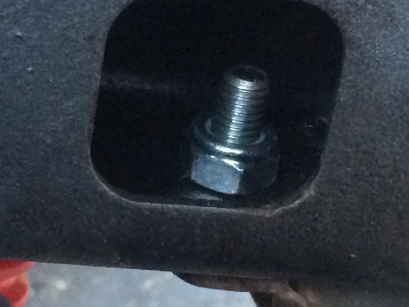

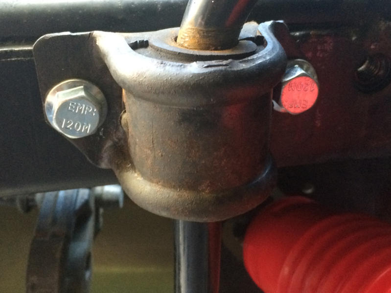

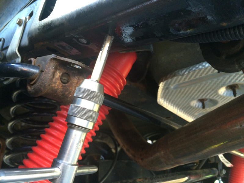

Thanks. Now the next question. After installing new control arms, I noticed that the sway bar end links are hitting. Is the best fix for this to move the sway bar mounts on the frame back an inch or so?
Old Apr 25, 2015 | 04:14 PM
Haha I just did This today. I moved it so the new front bolt is inbetween the 2 original bolts. I'd say .5-.75 back. The x-factor kit includes 4 self threading bolts and says to move it back 1". Drill a 5/16 hole and run the bolts through. I actually used a tap. I also used a nut on the front bolt for insurance.
Ok, that is what I was thinking. I have been upgrading from the mid flex kit so no directions. Thanks for info.
