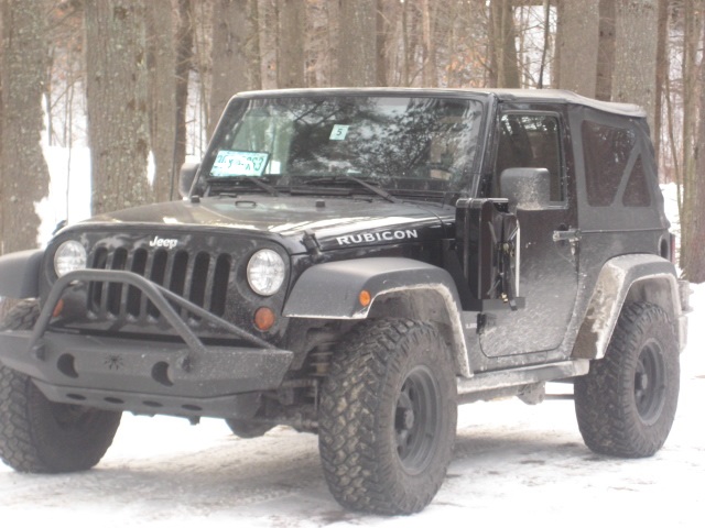

looks great , nice photo./ the drivers side should be in soon right ?
i think they kick @$$ filled mine up half way,i want to get a (super siphon) and see if it can be left in place and just siphoned from can to tank with out removing the can from the holder .

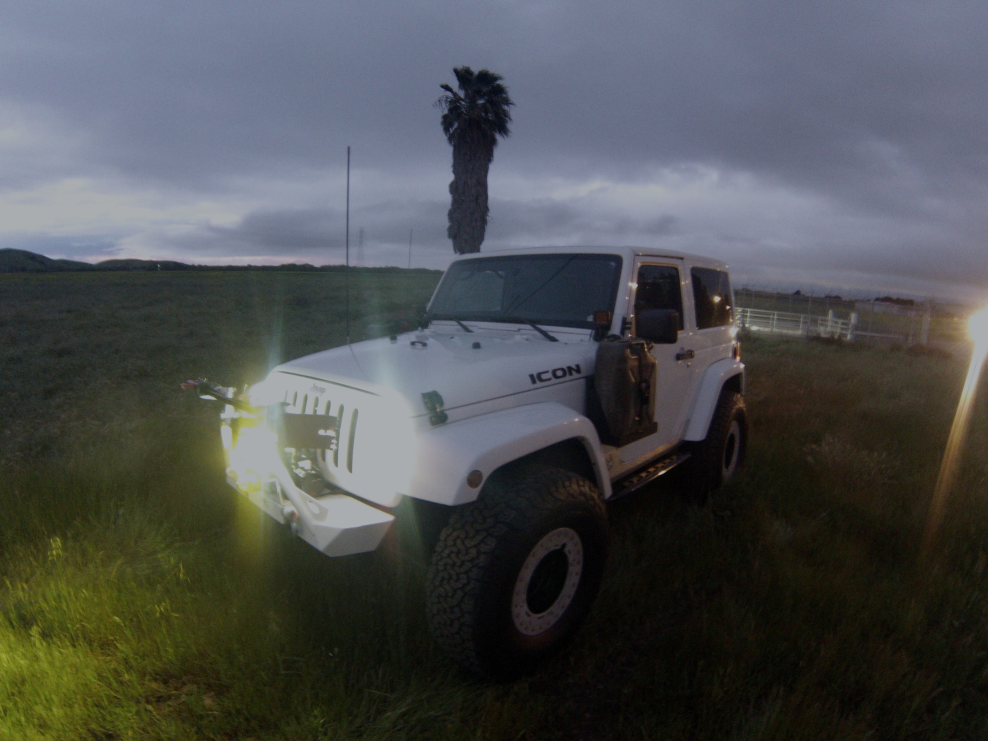

Both are on. This one fit 100x better and installed 100x faster. Amazing how fast it'll go on assuming you don't receive one with a bent door hinge bracket
I left both the stock ratchets on. If either starts to show rusty springs then I'll change them out but everything else looked to have a decent zinc coating on them.
Might get a chance to see how much clearance I actually have going through some tighter trails/brush soon. Wheels and sliders are out far enough so I'm thinking I'll be good unless I really get off camber but theoretically I'm thinking (and hoping) that the scepters will serve as pillar sliders if worse comes to worse.

what sliders did you use ? Hard to see in the photo here but looks good to go those beadlocks locks look slick too did you buy them after or with wheel set up.

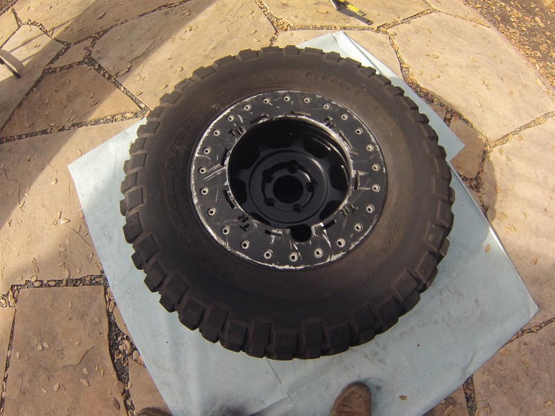

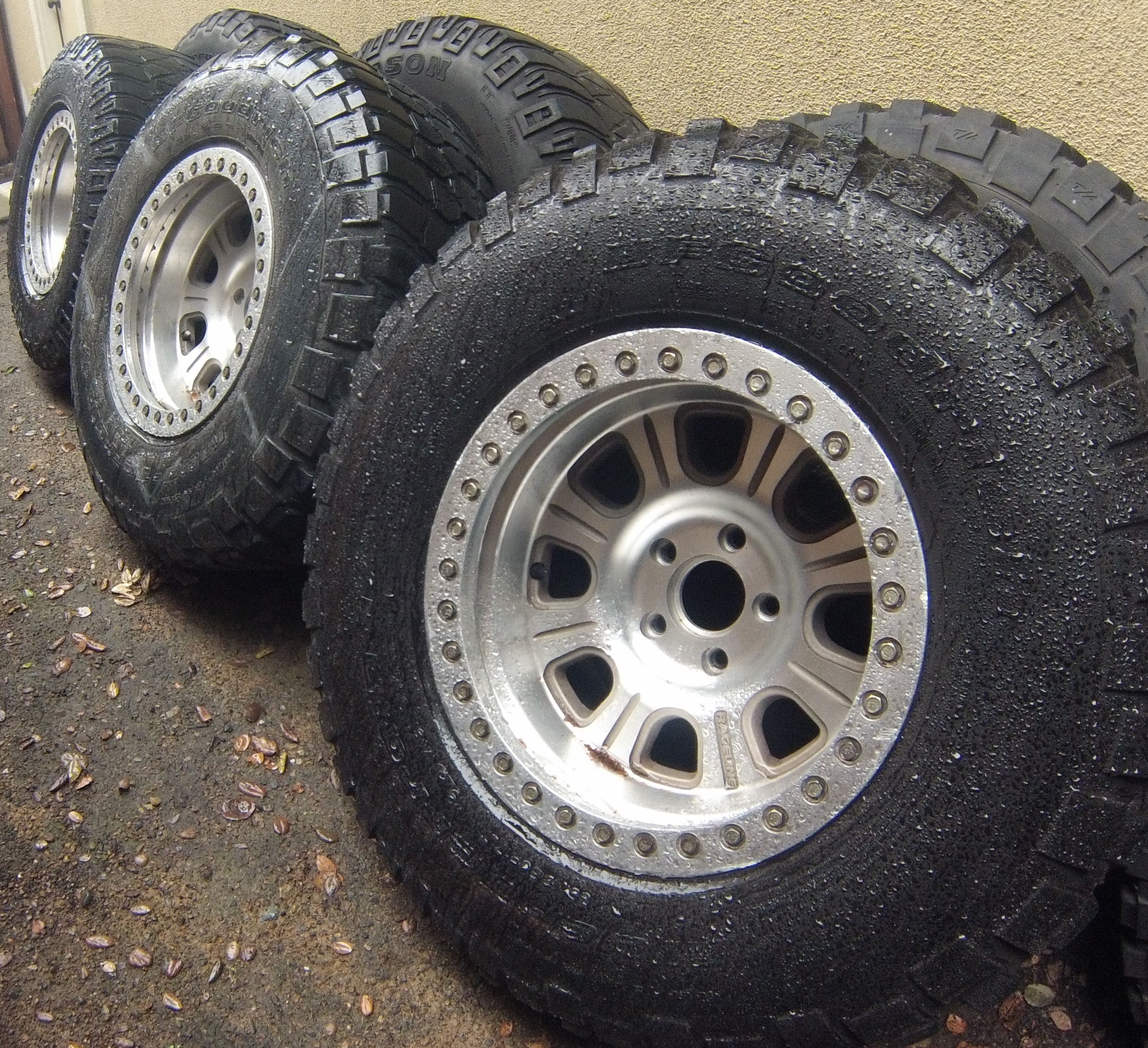

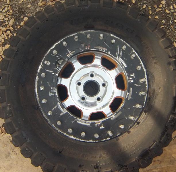

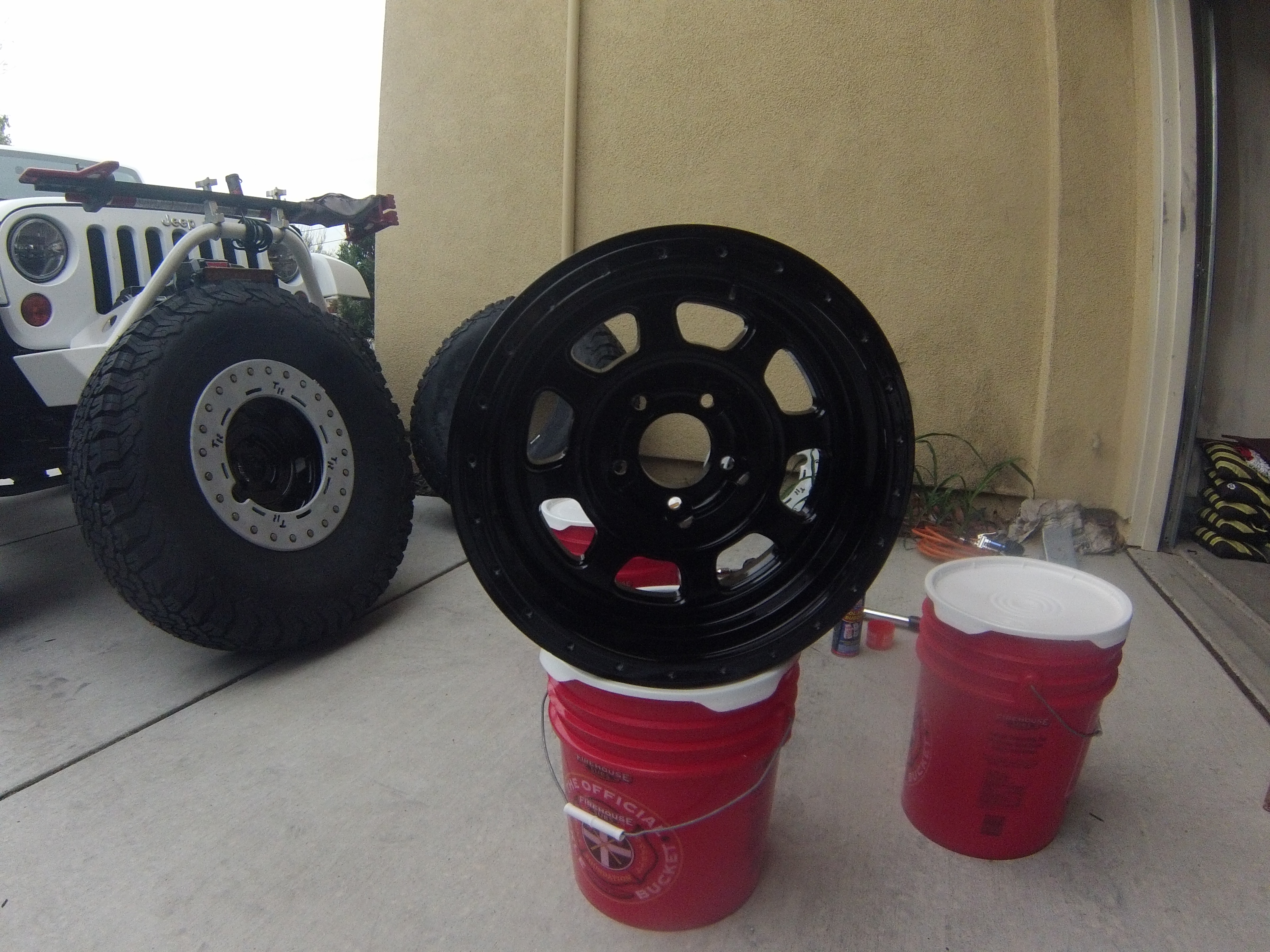

Thanks mojo
VKS pre-runner sliders + Evo aluminum rockers.
Trailready HD17's beadlocks.....I've had them for over about 15 months now. I just refinished them about a month ago since the paint job I did last summer on them was half-ass and started flaking. You really have to go powder coat if you want to do wheels correctly. Then I got the rings blasted and cleared them to match all the other aluminum bits that's on the rig. I slapped on KO2s in a size 37. Currently an AEV 2.5" lift....

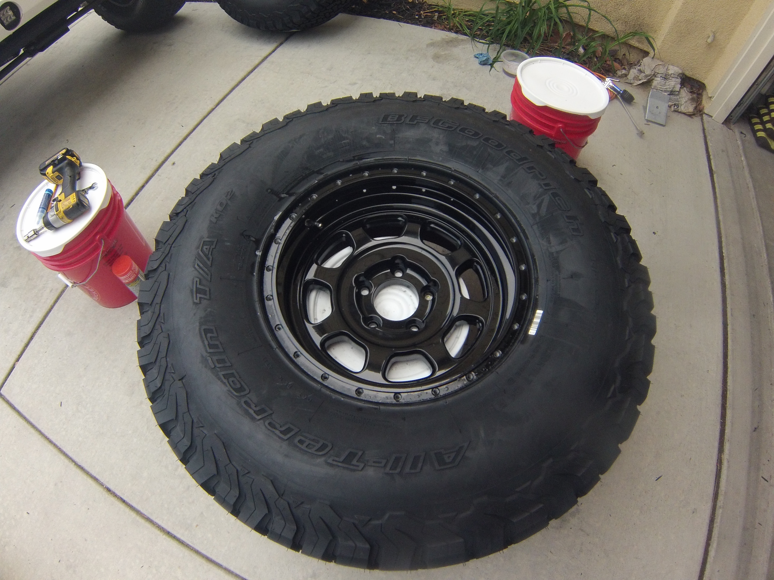

No issues with steering on the streets. Very slight rubbing if I take a tightly turned on-ramp at 45mph. They are a 36.5" tire but where I have them aired at brings them down to about a 35.5".
The nice thing about BFG is that they are the lightest weight heavy duty (in the realm of JKs) tire on the market. These 37 KO2s only weigh 2 lbs more than my KM2s that are 35s. 71lbs versus 69bls so I'm not too concerned about the axles/unit bearings.
The 37s haven't been Rubicon trail offroad yet but only muddy service roads & ruts. Probably won't really test them out until I get the front dana60 in hopefully by this summer. Still awaiting specs/field tests on a suspension I'm looking at before the axle upgrade goes in. In the meantime just running a sleeved, gusseted, upgraded ball-jointed, and diff slider protected D30 lol.
If I'm going to hit some mild/hard trails then I'll swap in the Racelines with the 35s back on....
