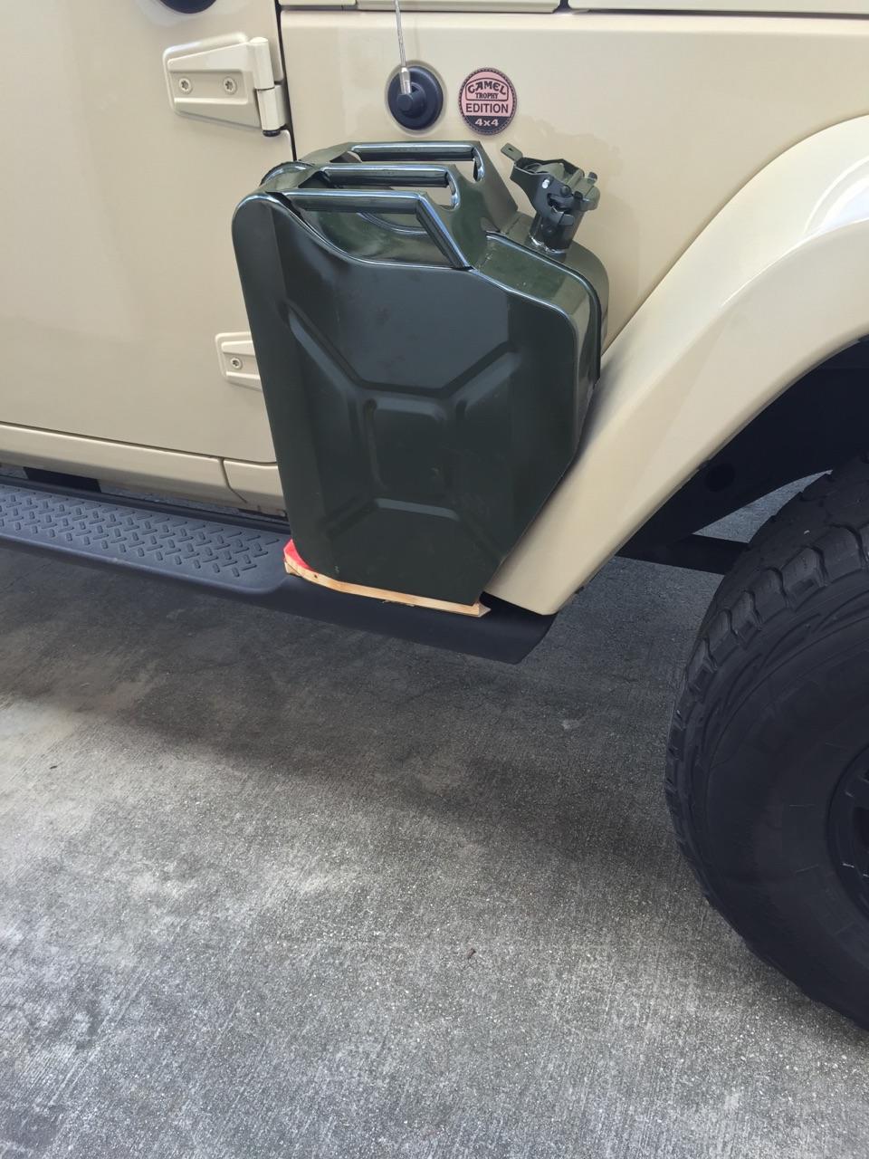

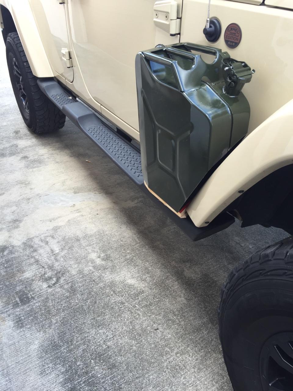

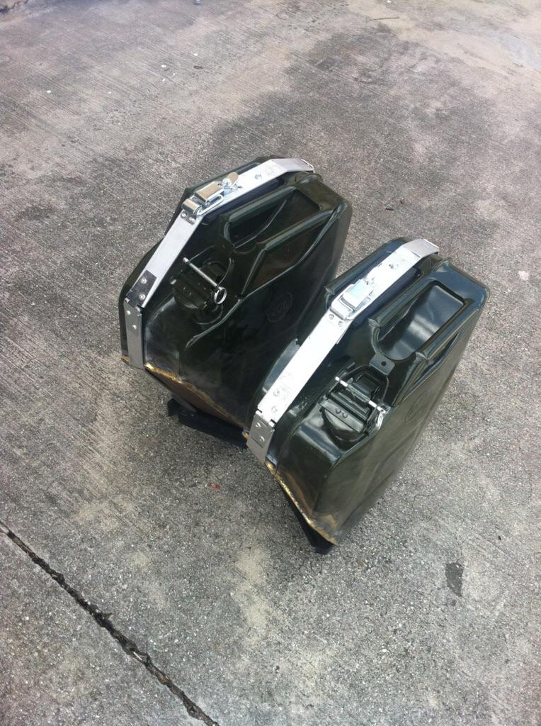

Update from Robert at 4x4tabs... mocked up pics . cans were headed to paint as of a few days ago. Should have them soon!
Those are looking great! What color is your Jeep?

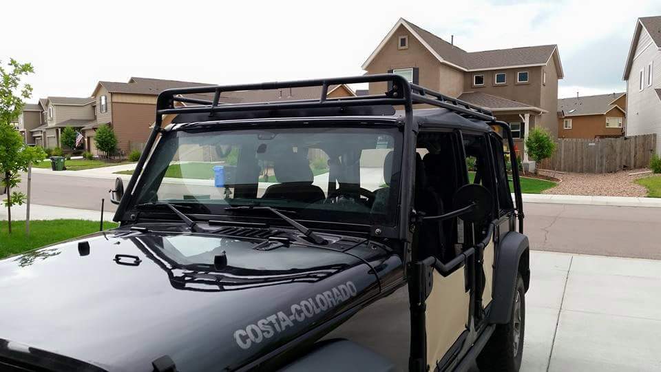

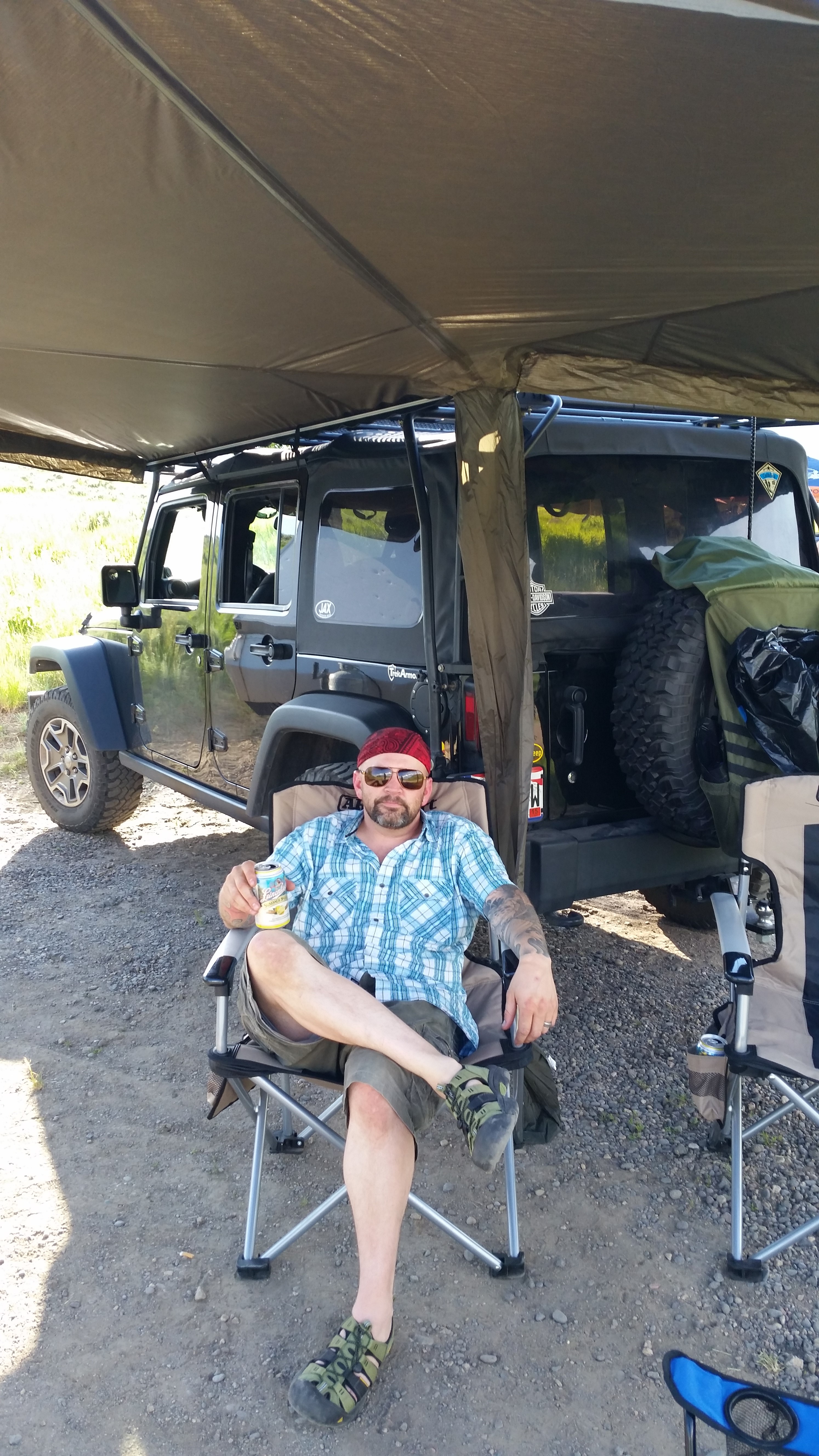

CURRENTLY black.
ID:	640449Click image for larger version
ID:	640450But am playing with the idea of a tan. I would LOVE to find out the paint used on the new Crew Chief concept.

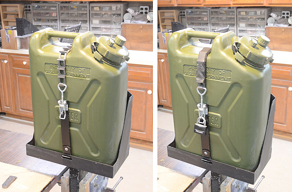

Default This looks like the way it should have gone through
a fair set up ,for $159.00 as seen in this photo below with strap & the added lower rubber grommet added before it went into full production but prob wasnt a foreseen issue .

jdapp: thanks for the warning wonderfull !

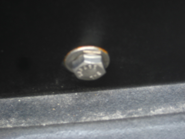

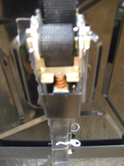

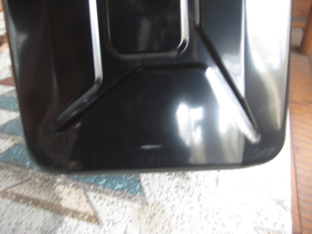

Default Another forewarning not mentioned
just to let others know . Just found out today
The bottom clip of the strap will also damage your paint on the jerry can , so it will either hit the bolts on that hold the plate on or the clip on strap either way is subject to abrasive hardware *Also though the bolts look to be stainless steel, but they are not and have rusted after only a few weeks of being on my jeep ! Obviously lead to rust problems and corrosion ! I put gorilla tape on the can to see if this helps stop the issue from getting worse to my Can investment , and i think its clear that under the ratchet itself needs something to prevent rubbing on that area as well and ratchet is rusted quite a bit in only a few weeks not exactly 5 ***** star trail rated package .
As With : Erok and JDapp had their own issue
... i think its clear that under the ratchet itself needs something to prevent rubbing on that area as well and ratchet is rusted quite a bit in only a few weeks not exactly 5 ***** star trail rated package .
Upon assembly, I actually wondered about the bolts and the ratchet. Even though the side-mount is made in the USA was wondering if the ratchets were also. Looks like I'm changing those out....
https://www.ratchetstraps.com/usa-tie-downs
https://www.ratchetstraps.com/2-ratc...rap-flat-hooks
Having said that, that's why I can't recommend the Sceptor cans enough. Scratches/paint is a non-issue unless you're looking to build a show car. Once you start banging up against tree branches and rocks on the trail, all the good looks go out the window.
