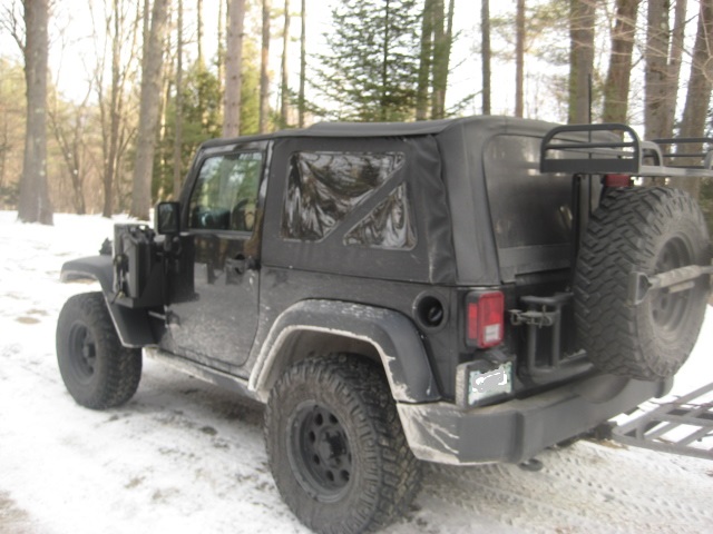

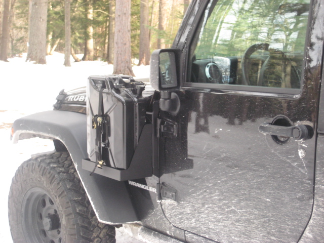

noise as far as a whistle ? that i cant tell its to cold out to have a window down
but this system is pretty solid so as long as its not going anywhere , and it cant !
* Im thrilled with it / it complements the jeep i feel
so a thanks jscherb / morryde / Retro offroad

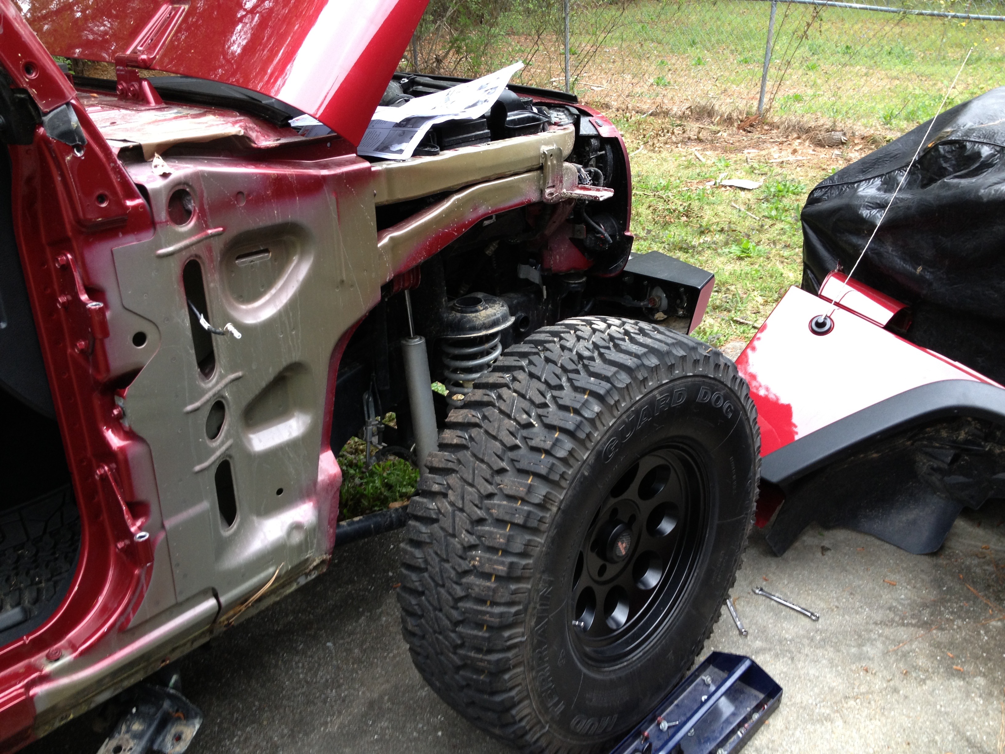

I think I'm going to do the side rear hinge mount over mounting to that weak sheet metal on the side of the Jeep. I had to take off the side with the antenna to install my snorkel and I have to say that metal for the front corner panel is some 12 gauge crappy sheet metal. Once I get my Teraflex hinge I'll get the RotoPaX mount add on they sell.
Here is a picture of the panel off.

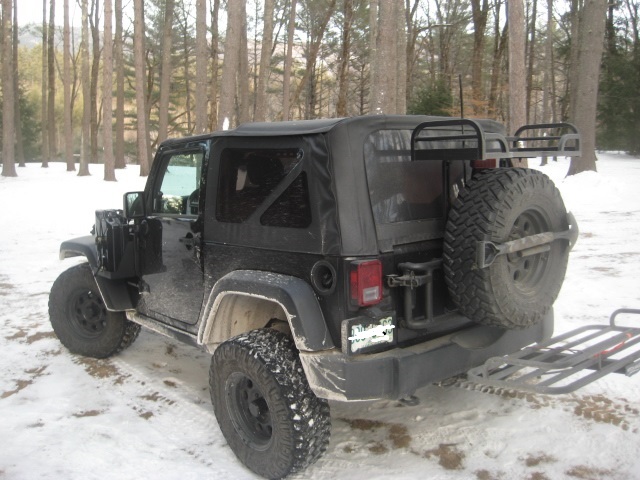

Default just to clarify the side mount
is supported by the tub door frame then the upper window frame and then one 3/8 bolt under hood on side panel ( not the weak sheet metal really )
you could prob jump on it , not that id try that but that side mount is as solid as a rock . If your talking about impact by a tree ? The side veiw mirror would be gone too thats attached to the flimsy doors im not playing in big boulders or trying to fit between trees so tight i can barely fit your fender would have to be tearing off as well . mounting the 2 cans in the back of my jeep would have been very simple as well . But i really liked the look of the side mount holder . it was my preference after a great deal of time & thinking it through .

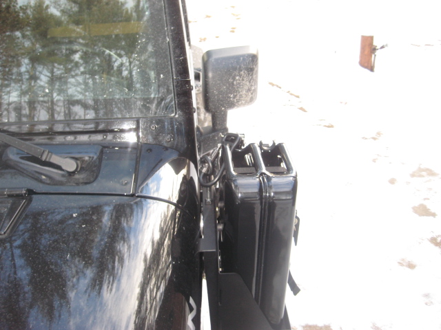

Originally Posted by jeepmojo
is supported by the tub door frame then the upper window frame and then a double wall supported side bolt 3/8 i believe it is ( not the weak sheet metal )
in fact it dosent touch the sheet metal as you can see in side veiw
Jeepmojo is correct, the side mount isn't supported by the sheet metal, it's supported by the door frame (where the door hinge bolts), the windshield frame mounting bolts, and the core support braces under the hood. No weight or stress on the fender sheet metal at all. They're very sturdy.
But the hinge-mounts for Rotopax containers are very sturdy as well, it bolts to the HD hinges .

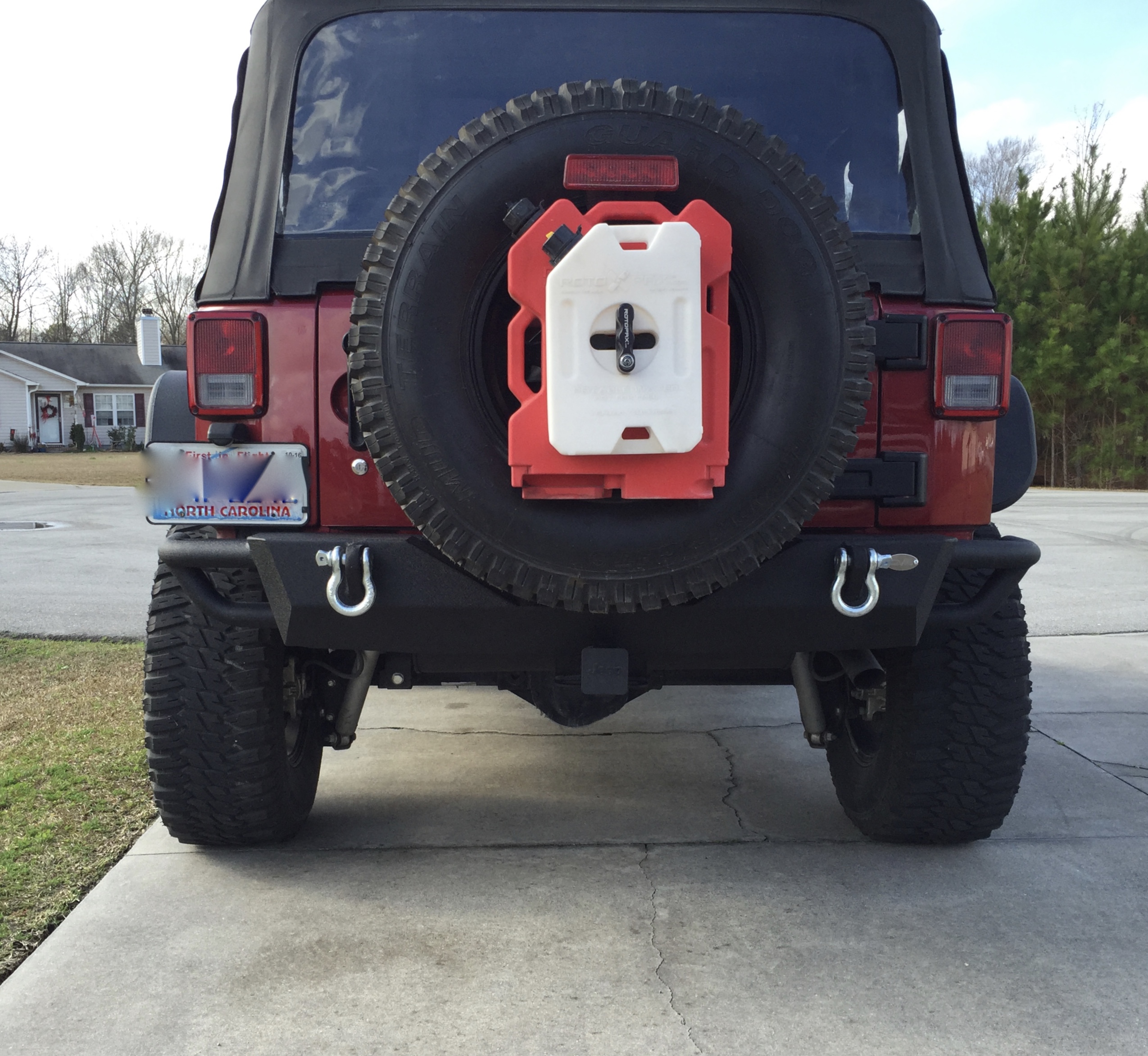

is supported by the tub door frame then the upper window frame and then a double wall supported side bolt 3/8 i believe it is ( not the weal sheet metal )
Just watched the video and now I see what your talking about. Its inside the door. Yep your probably could stand on that mount. Initially I thought it was just held by some bolts and nuts/washers through the front quarter panel. I Personally like the rear mount. Once I get the hinge I can probably double stack two 4 gallon RotoPax containers for a total of 8 gallons. Right now I have 3 gallons on the back.

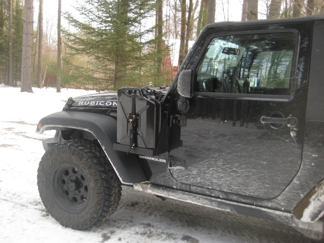

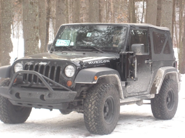

Default actually my or fab tire carrier will take that
mount for roto pax as well i believe just bolt it on right side of spare tire
if i had the need for carrying water in rotopax endless possibilities but i dont need to go overboard right now im just showin off the ballzee looks of the side mount

Default im so glad i chose the side mount
This is really is a great product & looks fabulous also morryde has a awesome customer service dept, as well.
Id have never been as thrilled if i had added the cans on the back plus it would have obstructed vision as well ,
