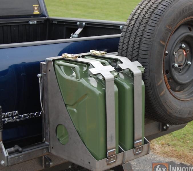

Thanks for all the input. The real question for me is whether or not it would be worth it to manufacture a new locking strap. The answer to that I guess would be partly based on whether or not there are already solutions on the market that work in this application. I like the locking jerry can straps I've got, but they don't work with NATO or Sceptre cans, and I haven't yet found compatible solutions for those cans. So I may just design one myself that's "universal" - it would work with jerry, NATO and Sceptre, and it would work with the can tray I've used on the prototype, and with traditional Blitz trays. It would also be adjustable so you could snug down on a can enough so the can wouldn't move or rattle. I'm surprised there isn't anything like that on the market, seems like a simple enough set of requirements that should have been met by now. Oh well, I'll keep looking and probably design one of my own soon.

Your input got me thinking, and this morning I worked up a design for a "universal" adjustable, locking metal strap. It'll work with jerry, NATO and Sceptre cans, and it's adjustable and flexible enough that it could also be used to secure something like an ammo can in the tray as well. It'll also work with traditional Blitz/military style jerry can trays, and probably a few other aftermarket types, I'll have to check around for some others and do some testing. I've ordered a some parts I'll need to make up a few, so as soon as they arrive I'll make up a couple of sets for testing and post photos.

Here's the idea I've been working on an idea for a locking strap to secure jerry, NATO and Sceptre cans - I made up a prototype today.
My goal was to come up with one strap that would work with all types of cans that would be locking and secure, and adjustable so the can could be snugged down tight enough to eliminate can movement or rattles. I also wanted the strap to be flexible to deal with the different can shapes, particularly the rounder shape of the Sceptre cans.
Today I made up a prototype, here are a few photos showing it with jerry and NATO cans. Unfortunately I don't have a Sceptre can here to try it with.
The tray hooks at the bottom ends of the strap swivel, so the strap can be used either to secure only the can (left photo), or it can be angled to also secure the cap (middle). NATO cans have caps on the ends of a spout so they can't easily be secured that way.
Adjustments are done by means of the adjustable latch (3/4" range), and the removeable-link chain (1.5" each link). The math works out to basically infinite adjustment - if the adjustment on the latch isn't enough, remove or add one or more links and start with the other end of the range of the latch adjustment.
The strap is all metal, so it's pretty secure. Here's a photo of the strap on the workbench; a few extra links are in the photo as well. BTW it takes one more link to go over the jerry can cap than it does to go through the handle.
One more refinement is to encase the link portion in a flexible plastic sleeve so the links don't scratch metal cans:
The retail cost of buying the materials to make this prototype was less than $10. This is a proof-of-concept prototype, so there are a few refinements I'd add, but it definitely meets the requirements I defined for it. I have no idea if this would make sense as a commercial product, I just designed and built this one because it was an interesting design challenge and I wanted straps like this for my own use.
