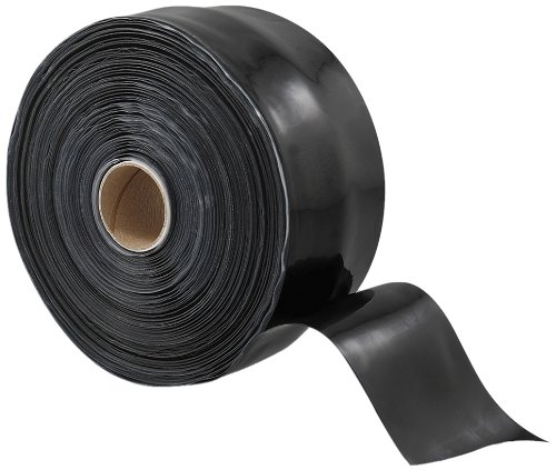

To prevent the lock from rattling, you may want to consider a Silicone Self Fusing Tape.
It's much more durable than Velcro under extreme temperatures, water mud & dirt, and would never slide off.
If stretched a bit while wrapping (3~4 layers), it sticks to itself so well that you can't peel it off, you have to cut it.
Link - http://www.amazon.com/X-Treme-Tape-T...lf+fusing+tape
This one is 2" wide, also available in 1" width.
Attachment 623957

I've had no trouble with the Velcro One-wrap coming loose in any kind of weather, including Alaskan snowstorms on the Dalton Highway and long interstate runs at high speed in the heat of summer. Silicone self-fusing tape is great and has lots of uses, but I wouldn't want to use something that required that you cut it to get the lock off.
