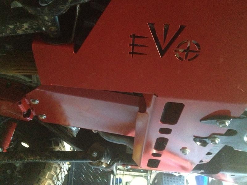

EVO Skid plates are now installed. A two hour job in a home garage, working alone. I painted them red because,...... well just because.

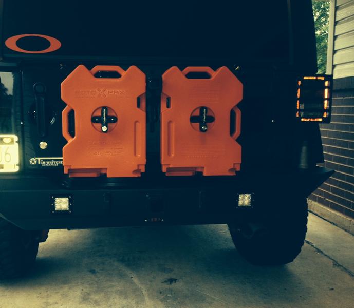

Default Knuckles Off Road (KOR) front and rear bumpers and Rigid Ind
Picked up my KOR bumpers this past weekend and got them installed throughout the week. I also put a set of Rigid Duallys in the front and rear and Rotopax system with the backplate from KOR. Still have to install the tire carrier and Warn Zeon 8.
Lift, wheels and tires in the future...Click image for larger version

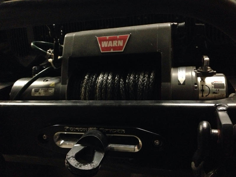

Replaced my wire winch line with 100' rope, viking safety thimble, and poison spyder brushed aluminum fairlead.

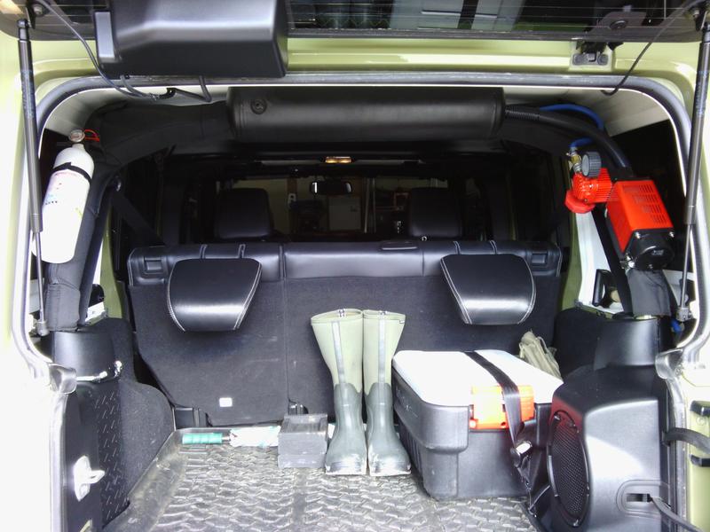

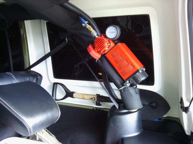

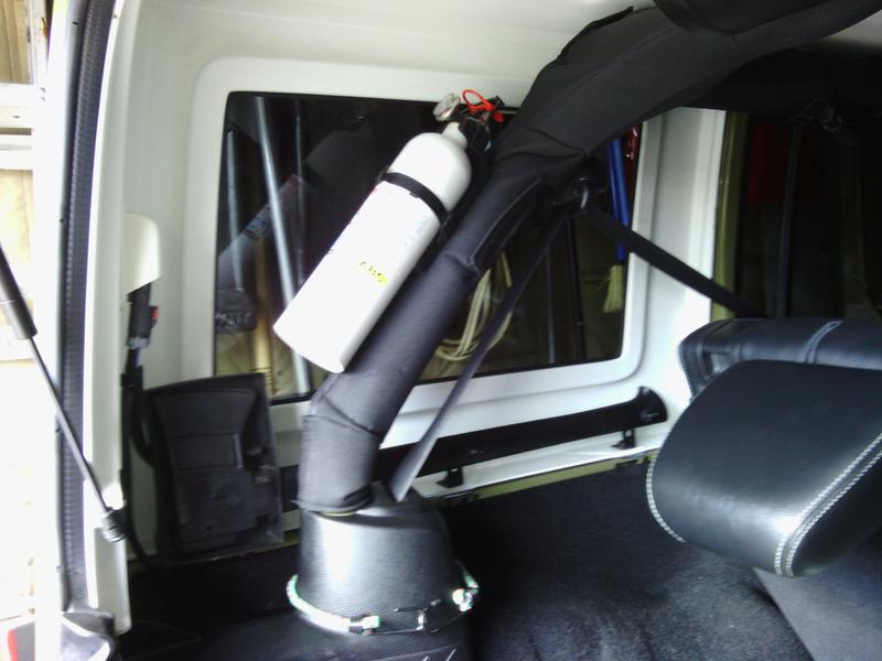

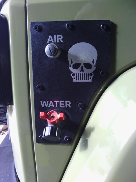

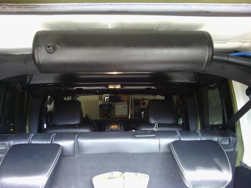

Onboard air and water. Water held in stock bumper with RV water pump mounted under. Q Industries MV50 Air Compressor with 2.5 Gallon tank mounted on rollbar in cargo area. Removed spring from rear headrests so they stay down for better rear visibility. Fire ext., axe, shovel, and air comp. all mounted in cargo area. Axe and shovel mounted on "L" brackets using hardtop bolts. Panel on side for air and water made of sheet steel from Home Depot. I painted it w/ rust proofing paint and then Plasti Dip'd it, rubber mat under to help seal against body. Vinyl stickers came from Moyer Custom Vinyl Decals. <img src="https://www.jk-forum.com/forums/attachment.php?attachmentid=506006"/><img src="https://www.jk-forum.com/forums/attachment.php?attachmentid=506007"/><img src="https://www.jk-forum.com/forums/attachment.php?attachmentid=506008"/><img src="https://www.jk-forum.com/forums/attachment.php?attachmentid=506009"/><img src="https://www.jk-forum.com/forums/attachment.php?attachmentid=506010"/>
That's a really great setup for the air tank. Think I'll steel it. LoL

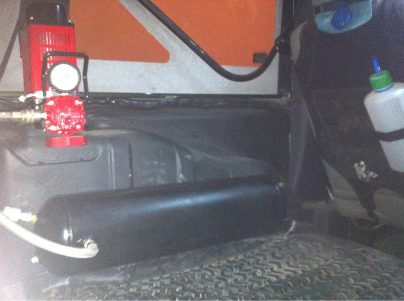

I've got a very similar air set up. Works great! Same pump and tank.

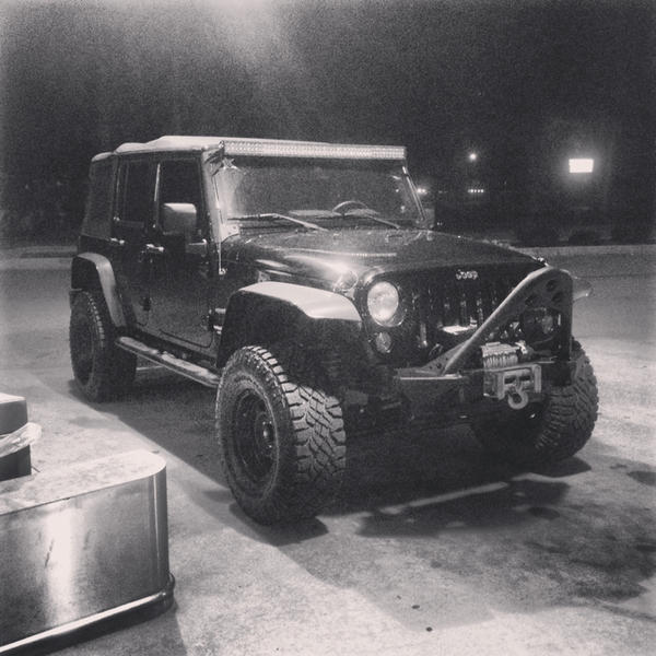

Smittybilt src stinger and drake hood latches
Attachment 506006Attachment 506007Attachment 506008Attachment 506009Attachment 506010
Really nice work! Did you rotate the head of the compressor?
