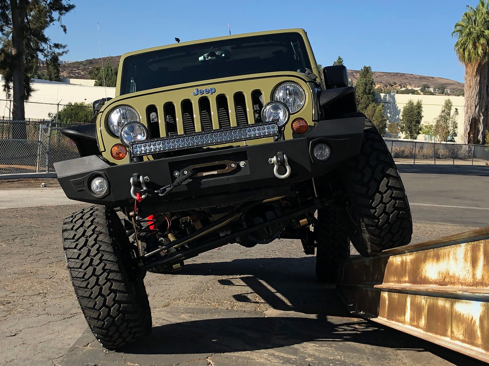

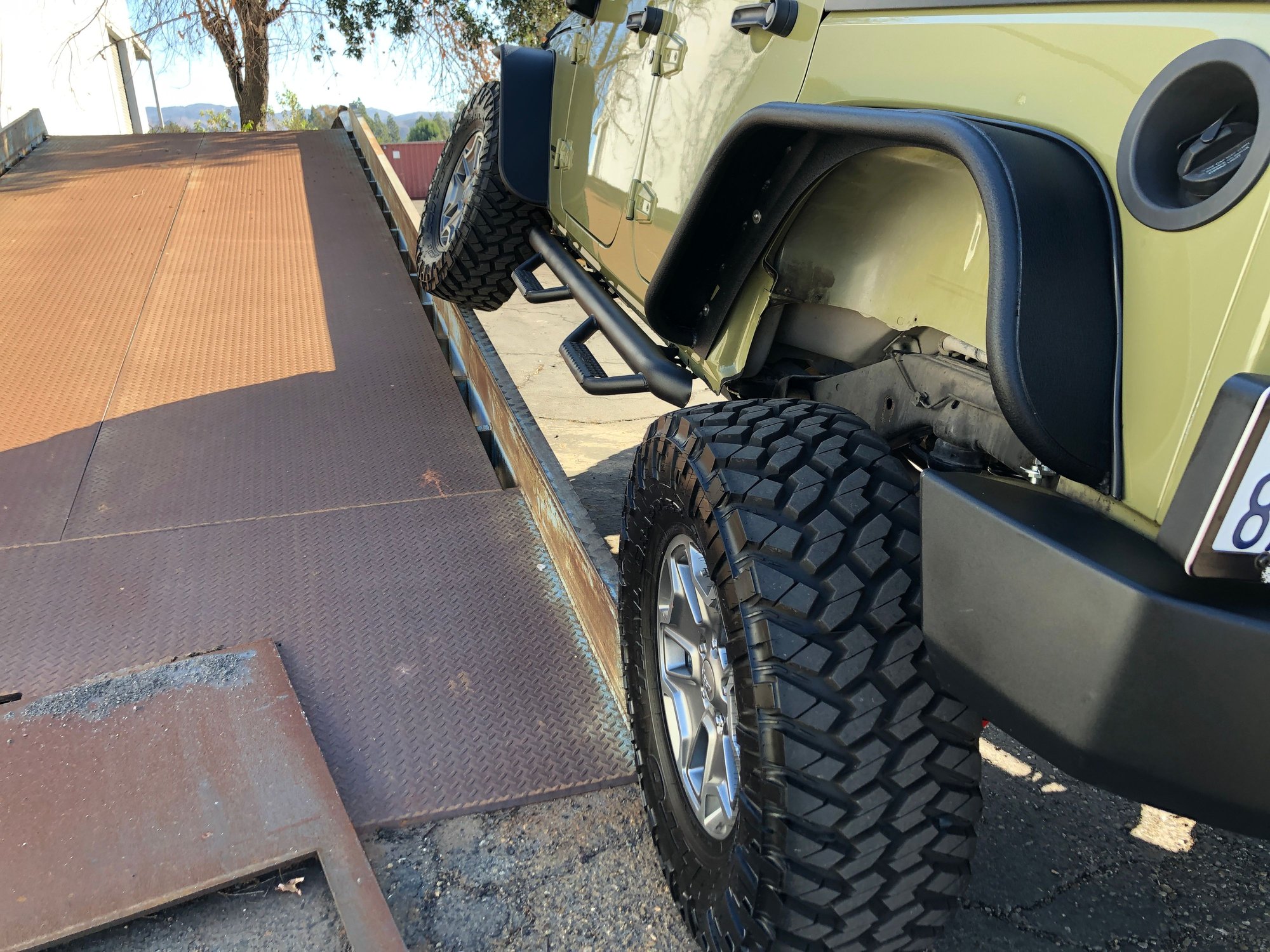

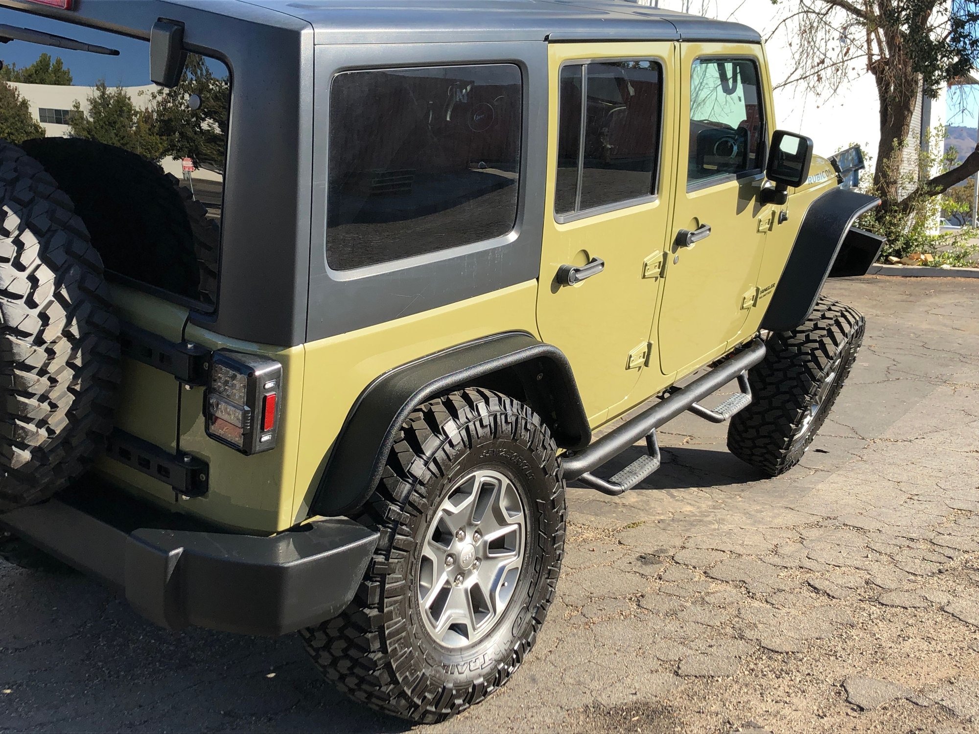

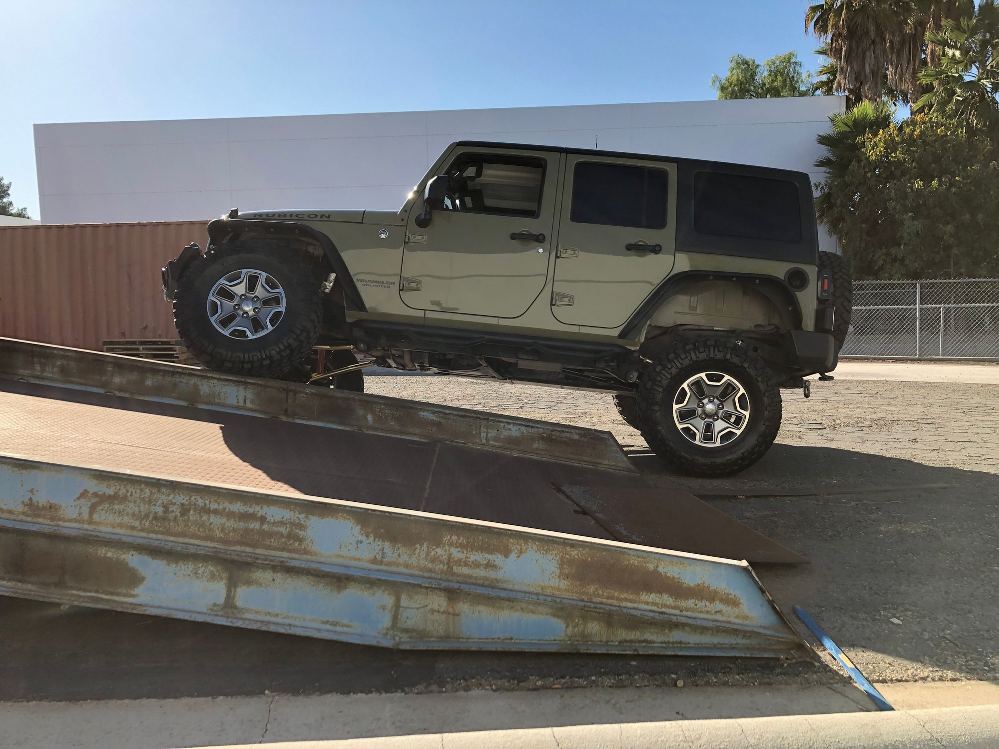

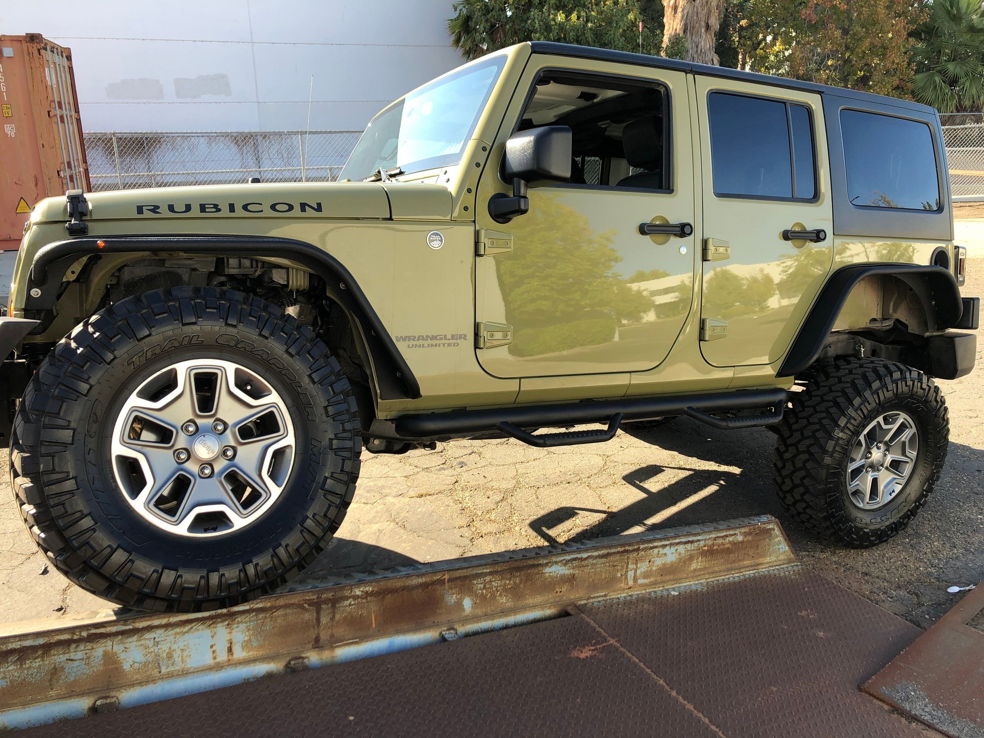

MetalCLoak 2.5"Gamechanger lift DONE! Dual-rate coil springs, new, longer shocks, super flexy joints, super strong control arms. Very happy with the articulation. Nicely capable. Will easily tackle the mountains of skulls when Skynet starts eliminating humans.

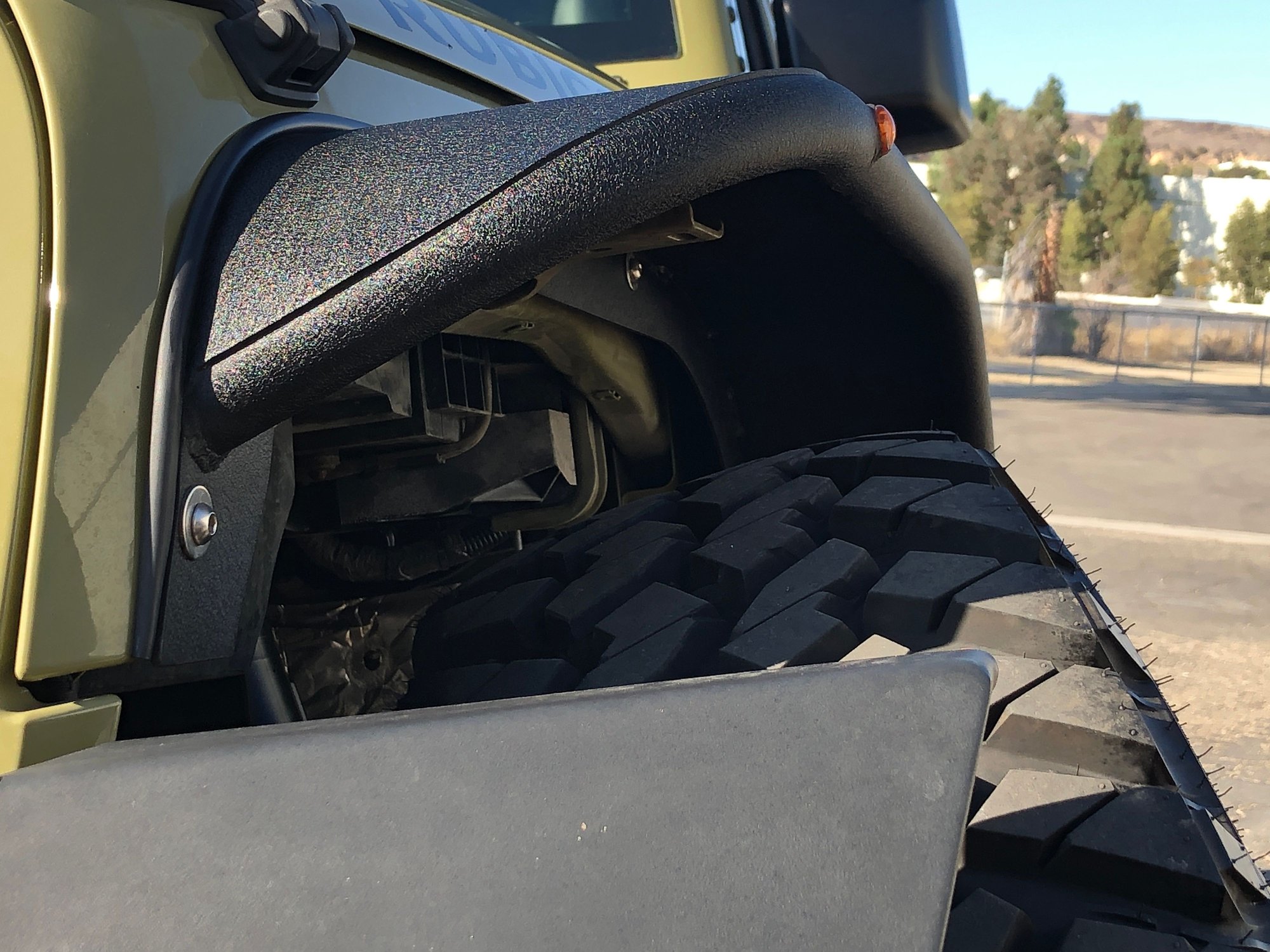

Did you powder coat or paint the fenders with duraline or did they come with that finish? Nice build!

What is everyone seeing height increase wise with the 2.5 game changer lifts? I know they advertise 2.5” but they generally are taller than advertised. Thanks for any help!

I got overall about 3 inches with it...until I:
-Added a HD bumper and swing gate +two 5 gallon gas cans
-about 200 lbs of underbody armor
-all of the camping /emergency stuff I took out during the lift install.
Now it's more like 1.5 inches. With all the added weight it's tougher to accelerate and brake.
If you keep it light, I think you'll maintain the org lift amount.
