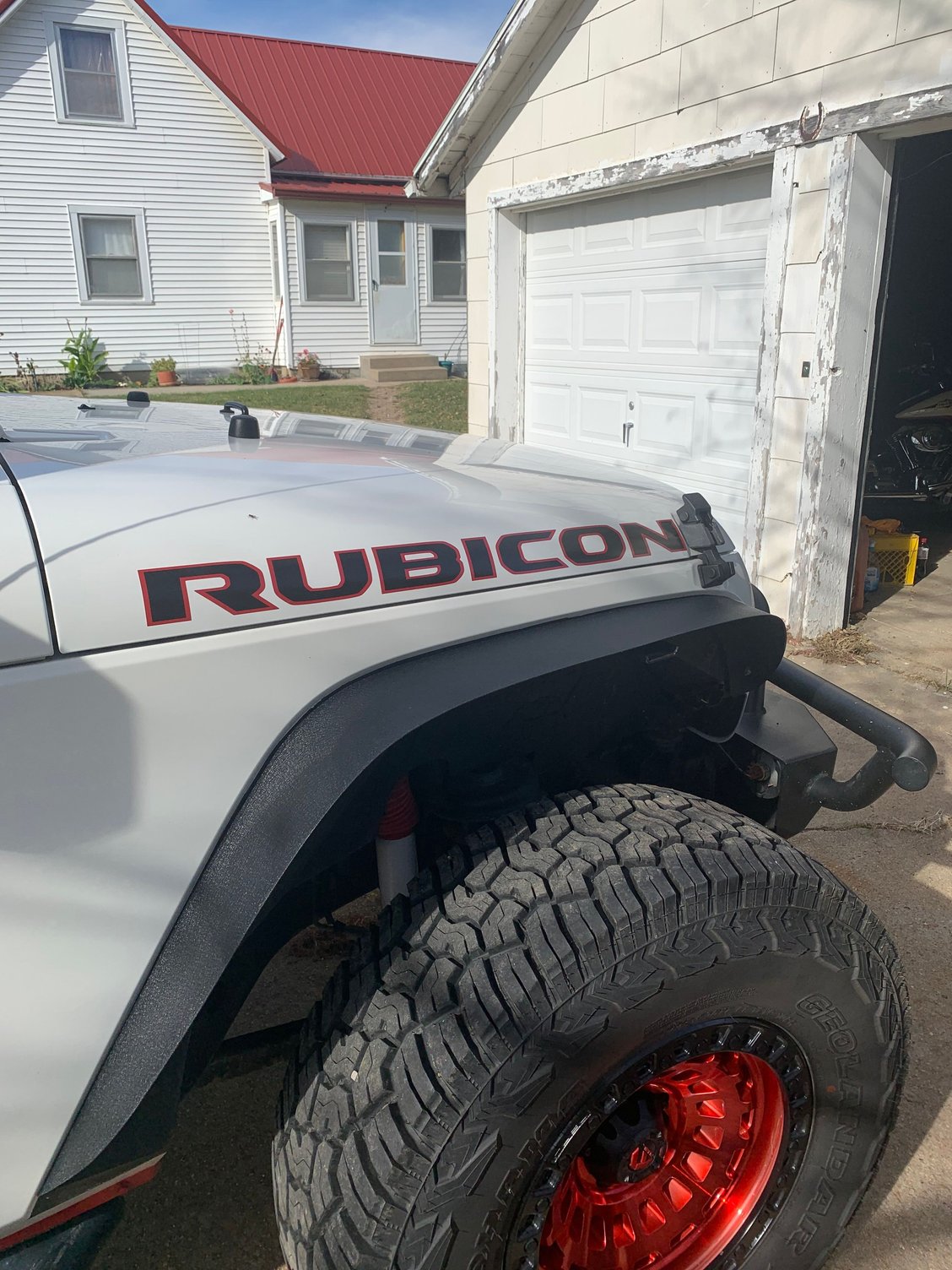

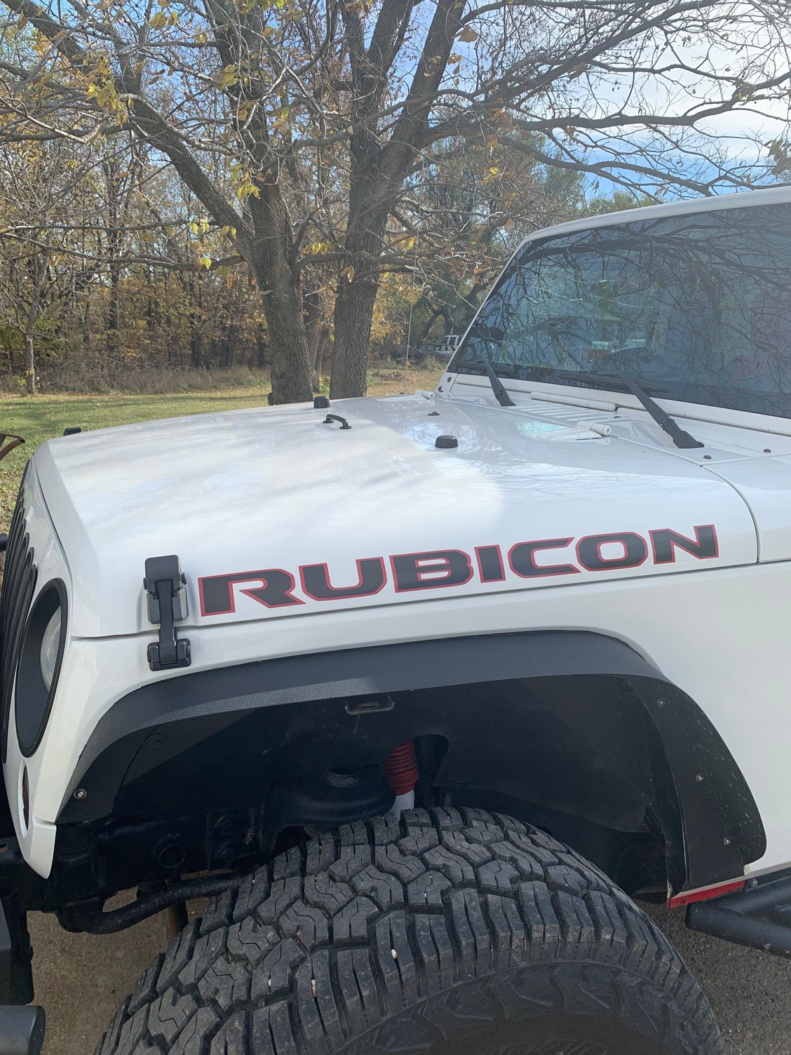

Since the previous owner had debadged my JKR, I added new Rubicon decals today

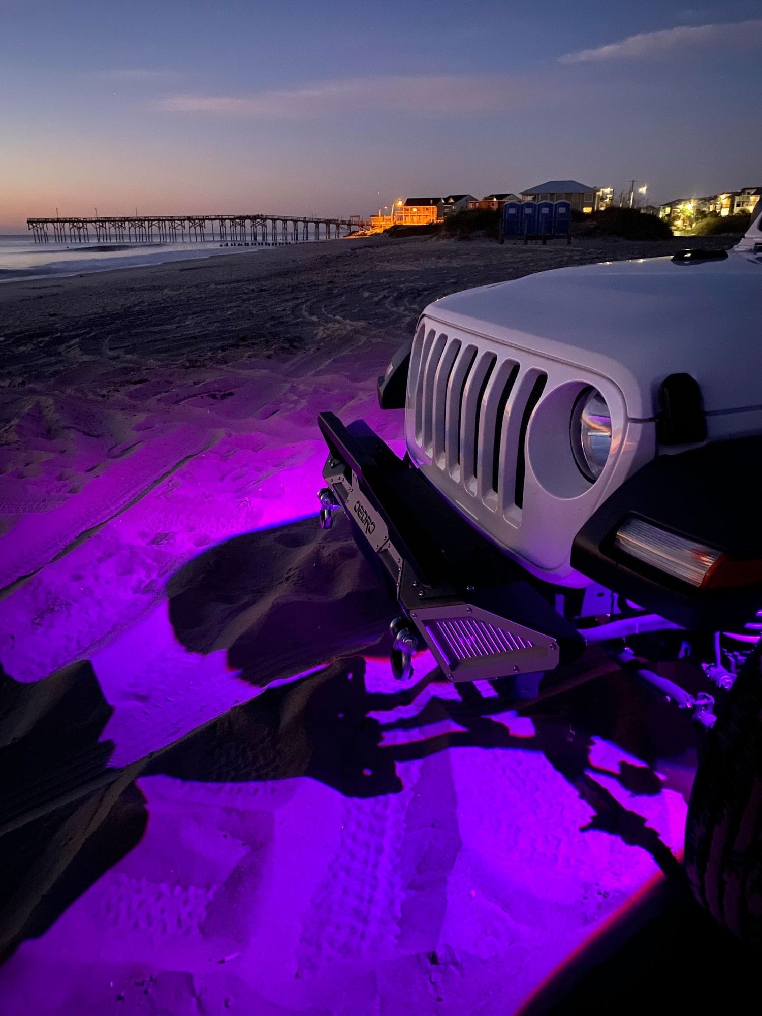

bought this bumper front off road style premium COD Edition to replace our old bumper. cant wait for it to arrive!
