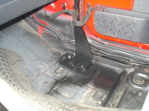

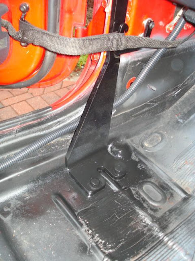

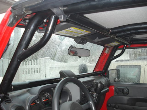

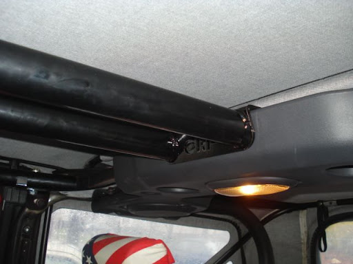

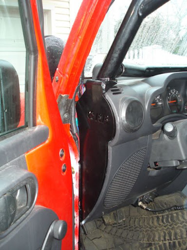

Finally got the OR-FAB cage pictures uploaded. Damn weather these past few days.
Fitment is damn near perfect. I forgot to fully trim the passenger side plastic on the upper dash so it sticks out a little past the dash, but I don't care since it doesn't interfere with anything. Boxes came fully sprayed in foam, but you do have to rip everything apart to get to all the parts. Powdecoating was very very nice, although did knick and scrape a few times here and there getting the cage in. SOLID! All brackets, bolts, and welding are SOLID. This cage isn't going anywhere. Still need to find a way to get the GPS bracket on there and Aux. CB speaker bracket on there. Floor mounts are THICK.
BTW, you DON'T need to assemble everything as one unit and drop it in. We tried that, SUCH A PITA to get in. Slid BOTH sides down the dash, THEN connected cross tubes. There's enough give of the dash to slide them in. Took about 7 hours between my friend and I to get in. All in all, a GREAT cage.
