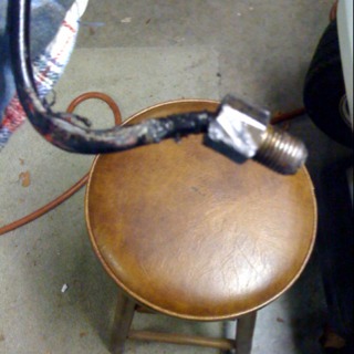

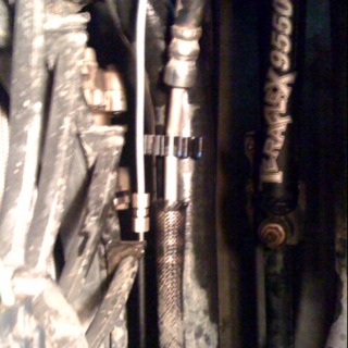

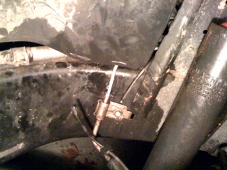

Had a rock jump up in the right front wheel weel in between the inner fender and the tire and it sliced/crushed my right front hard brake line. Had to pound it flat on the trail to stop the fluid from completely draining out. Thanks to JackMac for help getting it done to get me off the trail.
Pic of the rock in the wheel well.

Pic of the damaged line once removed
Pic of the temporary new line in and spliced pressure fitting until I can get a full new solid line done. It also severed my abs line so i'll have to repair/replace that too.
