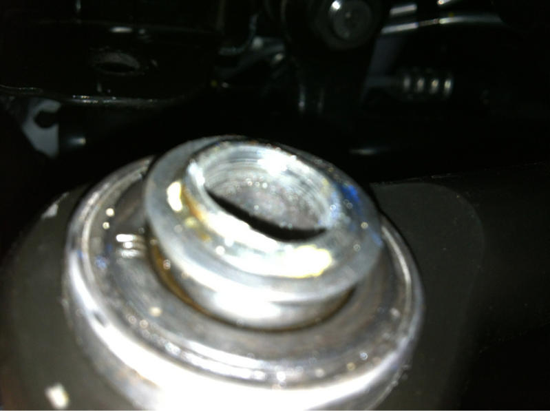

I was hoping for new track bar&control arm bolts

Yup, I replaced my track arm and bolts at 1400 miles. The factory sleeve on the frame side had cracked. Went 9/16's all the way around while I was at it.
What sleeve?

The sleeve that the frame side bolt goes through. Those sleeves are REALLY thin at the flange. Maybe the factory over torqued it. I doubt the sleeve holds one ounce more than 125ftlbs. The flange cracked and allowed the sleeve to go into the frame bolt whole and start to wallow out the hole.
^^^thats with 700 miles on the jeep.
^^^this is the good side of that sleeve next to the JKS. Note that the half metal you see on the factory sleeve is a flange and does not continue through the whole bushing. The JKS sleeve doesn't have a flange, I'd say it's four times thicker than stock. It was a good piece of mind upgrade.
