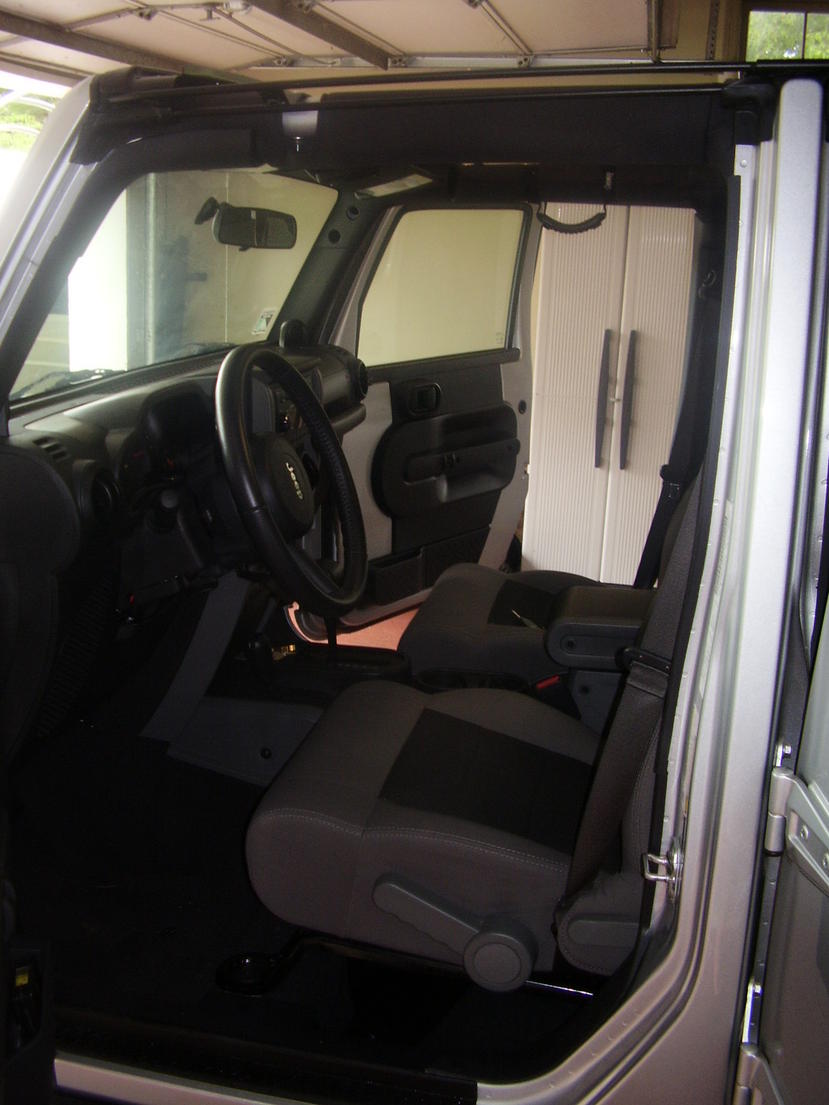

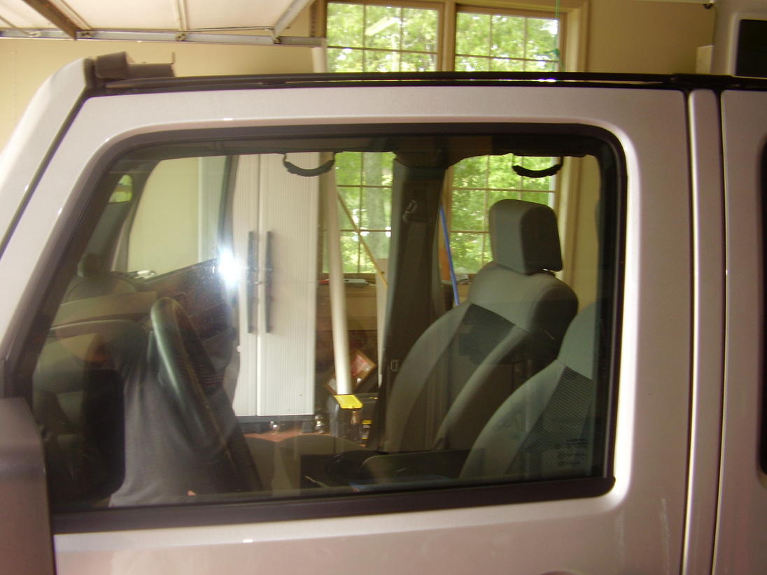

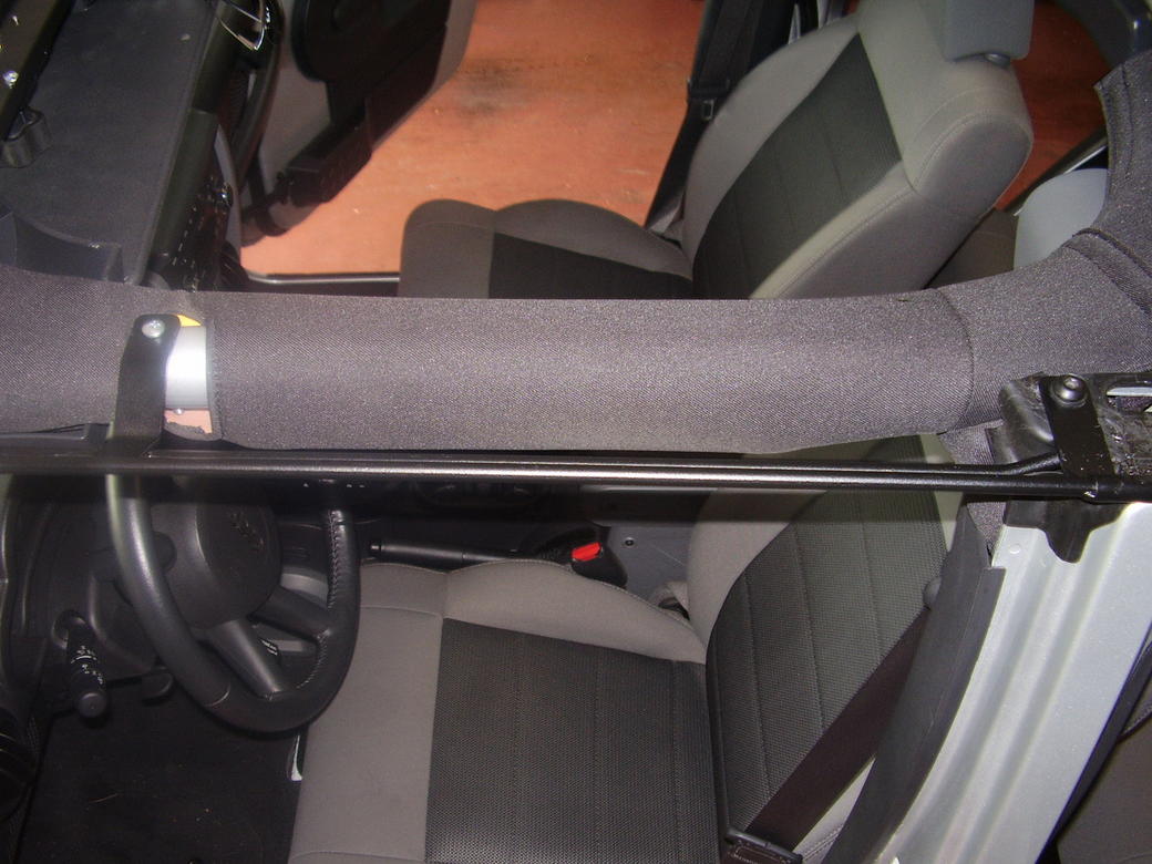

I'll try to post some pics today of the surrounds installed with the top off if some of you are still interested.
For the top to fit correctly the front surround must be installed as in the pictures. The upper must rod must be to the otside of the lower rod. This makes for a better fit aroun the door also.
The is another post with much better pictures, but it appears he has the surrounds on the wrong side, just as I did on my first try.
