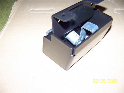

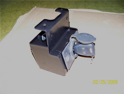

Originally Posted by ronjenx
MOPAR Hood Lock, part number 82210464 $130
To those who can remove the key when unlocked: Did you go through the key matching sequence?
I sure did! I expected fireworks or at least a solid click or something but I did encode it before riveting it in. Additionally I have tried other keys once it was locked (how I discovered the screw driver trick) and it appears to only unlock with the ignition key. If it (allowing key to be removed in unlock position) is a malfunction I will take it.
