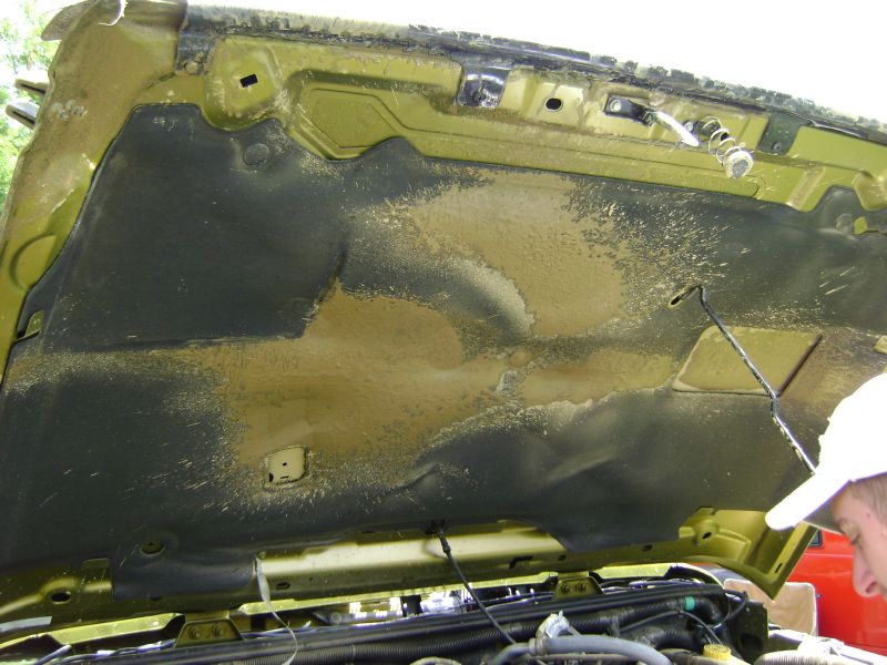

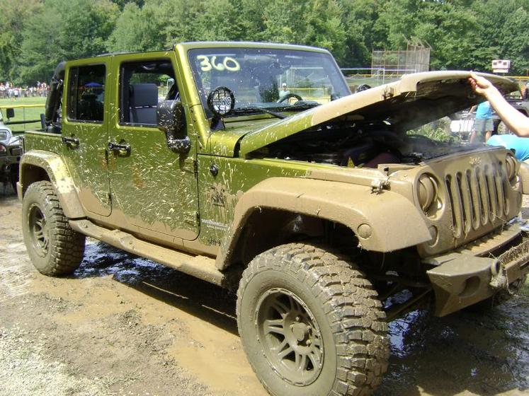

The underside of the hood after.
You can clearly see the clean space where the CAI is.
The dealership kept saying it prolly came through the muffler which is really hard for me to believe. The air filter was a little moist and had small specs of mud on it, I didnt realize this little bit of dirt and moisture would so easily come through into the engine.

Originally Posted by HITMONEY
Running a CAI and the looks of the mud splash over the hood... I'ld say more than likely that's what did it.

I have to ask why are you guys running cai intakes and running thru anything deeper then a puddle on the street from rain? Sorry but you are just asking for trouble. The way that mud is up and over the hood and flares I would say you definately got enough thru that filter.
When you bogged down the fan could have shot water up right past your filter, I've seen it come out between the fender and hood right where the stock intake is.
