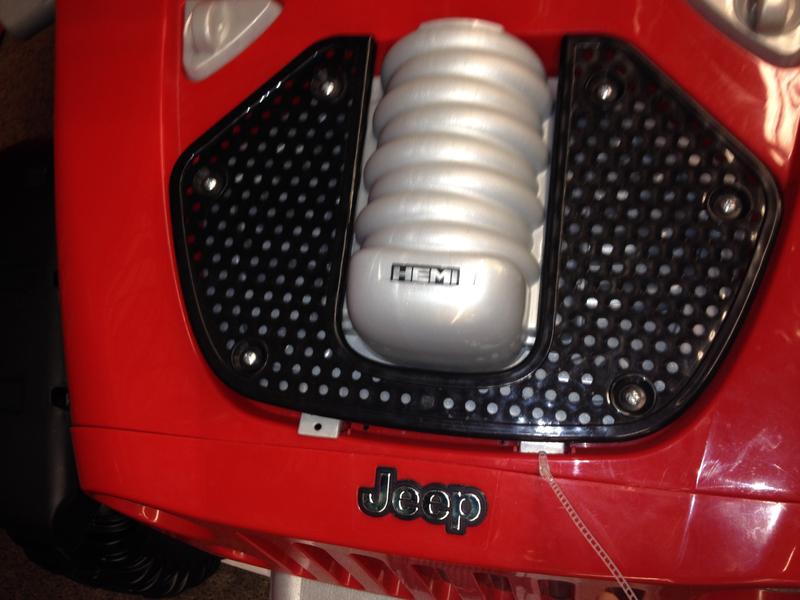

Originally Posted by jaker t5
Like I said option and no way can you compare a raptor to a jk , well unless you put a v8 in it and that is a still maybe
But I still think it would be a good option and it would open up the buying field even more and put more jeeps on the road
Here ya go IFS and a V8 Hemi........
ID:	499804   Click image for larger version
