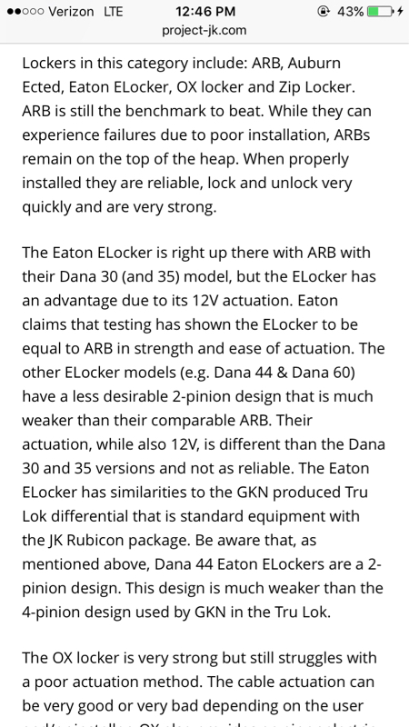

I'm just interested in the front 44 for non rubicons that will take the full 30 spline eaton elocker. The rubicon 44 elocker is a weak 2 pinion design and it's a smaller housing.

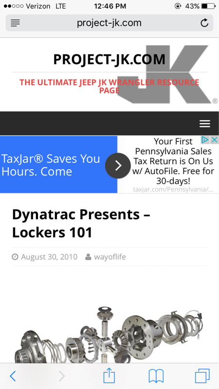

Originally Posted by jonathan_jk
i'm just interested in the front 44 for non rubicons that will take the full 30 spline eaton elocker. The rubicon 44 elocker is a weak 2 pinion design and it's a smaller housing.
.. Fyi

All 2012+ Dana 44 Eaton Elockers are now 4 Pinion. I know because I made sure I had the right part # when I got the 44 E-locker for my rear. I believe Dynatrac is one of the few companies that makes a Full blown true 44 front for non rubicon's. The rubicon front dana 44 is a smaller housing from what I'v been told.
