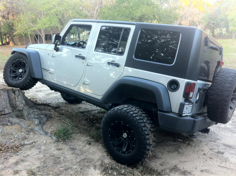

You'll be fine. These are 305/65R17 with only a leveling kit.
Rims are 17x9 with basically 4.5" BS
