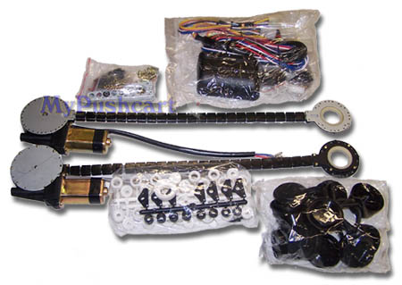

here's a rough draft....as I recall, the motor blocked part of EACH access hole for the window, so this is definitely not an accurate locator. You just need to mount the motor, with cable exit going straight up, then it curves toward the crank stub
red lines are places that require a cut, slot....whatever.
The lower red cut, is to accomodate the very bottom of the motor, where the innerliner flange prevents it from sitting flat against the panel.
this is your pic James, in case it looks familiar!!
the actual kit, looked like this:
