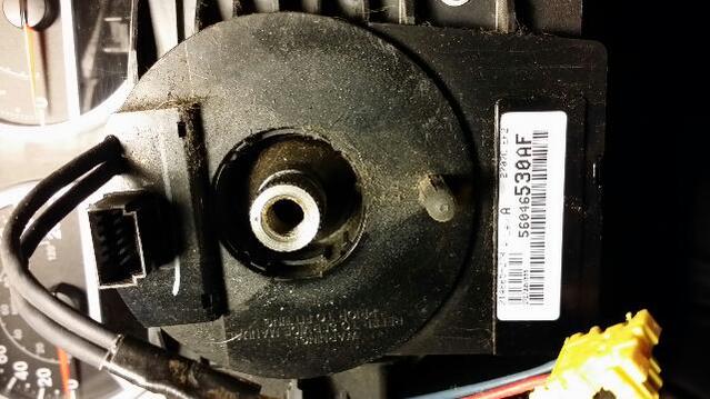

Replaced mine today with this write up. Thanks OP. Here's a pic of mine. Pretty dirty. At least there's no more seat belt light or chime (knock wood). It's gotta be that the contacts get dirty.
Just a couple pointers I found when doing this. For some reason my steering column didn't lock so when i went to tighten the wheel nut bolt the wheel turned on me. Make sure it's locked before you undo the battery. Also the screw on the right side of the top of the clockspring is a bitch to get at bc of the angle of the steering column. The T10 screw driver didn't work - too long. Had to use a 1/4" ratchet and T10 driver with a 1/4" socket. The head still hit the instrument cluster. Also stuff a rag into the hole in the dash over the column. Stops the screws from dropping down in behind lol.
