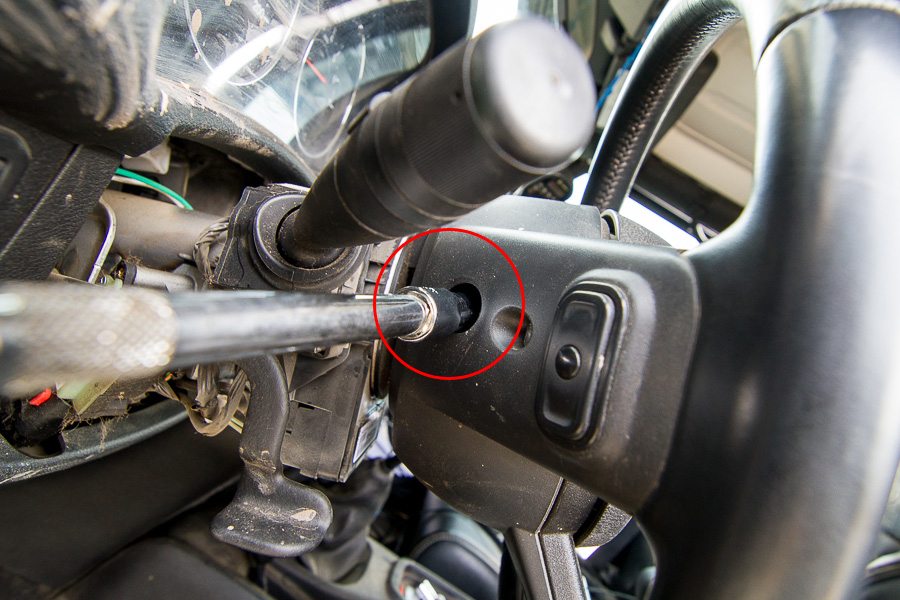

I would guess that's true but the wheel didn't exactly move since the tires were on the ground and the punch was where it needed to be. I've tea about this being a hard 3hr job but it's not hard.
And this helps removing the airbag.

Many thanks for this write up. Having seen the airbag light for almost a year now, I finally set myself to the job of replacing the clock spring. I managed to do it in just under an hour, a large part of this spent on finding the right tool to get the airbag out of the way. I bent an old screwdriver and that worked like a charm.

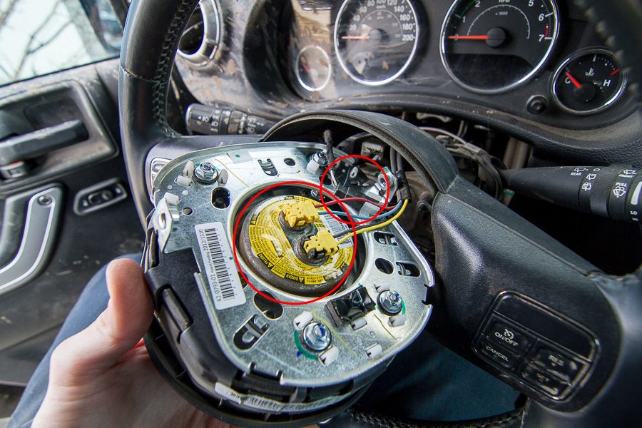

For the '12 + interior the method is the same with the exception being the airbag removal.
If you have the one with the steering controls your are in luck and it is very easy. There are two 10mm bolts that hold it in. One at the 9 clock and one at the 3 clock position. They are on the back part of the wheel.
Once the bolts/clips are removed. The center portion of the steering wheel containing the airbag can be removed. There are three electrical connections to undo. Two on the airbag itself and one for the horn.
