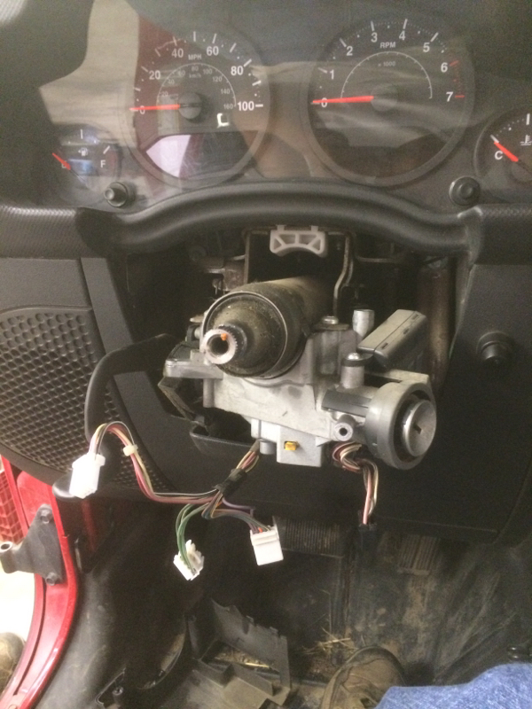

Thanks for the write up! Dealer wanted $500 but I found the part on Amazon from Mopar for $175 and with the help of this thread, installed the part within an hour.
