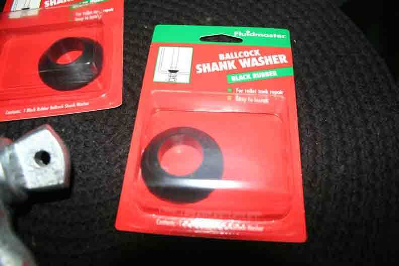

One of the annoyances I have when wheeling in the mud is the D-ring/Shackles clanking around. With this clanking, you will not be able to here any loose or broken part problems with your Jeep.
Well thanks to the BallCock Shank Washer, (LOL) I was able to prevent the D-Rings from clanking. Sorry for the bad camera pix...
You may need to file them down a bit, but they work and look great!

wow... that looks great... i just keep my tow strap up front and that prevents the clanking... nice mod!

I have nearly the same setup on mine, my stepfather was a plumber/pump repairman so i have stacks of old plumbing stuff, found some old rubber grommets that look very similar and have them on mine. (Only difference is i have my pins ziptied so they wont rotate out and go missing)

I used an old set of mountain bike handlebar grips and cut them to fit. They work perfect.

With these, do the D-rings still clank when you hit a bump? I have been using rubber washers I got from the plumbing dept. at a hardware store (about $0.40 each so $1.60 per shackle mount). It stops any side to side clanking but not the up/down clanking, which really only happens when I hit speed bumps.
But I'm curious to know if these stop all clanking.
