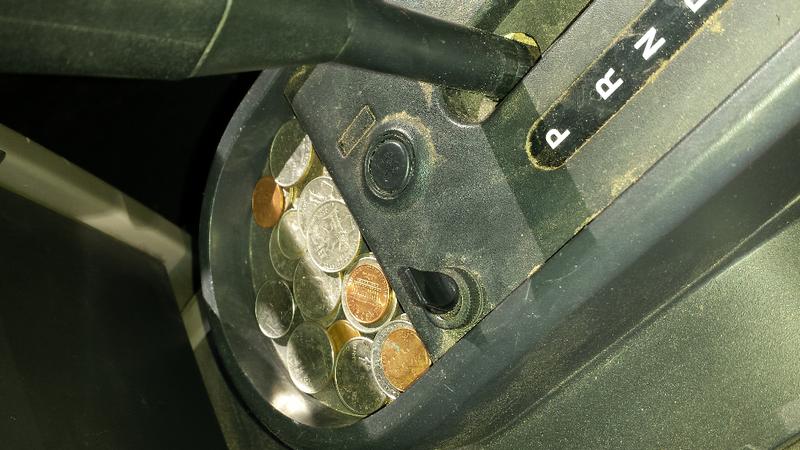

Here is where I mounted my switch. Its always off.

Iv done a lot of reading on this, and I still need some clarification..
So to get this straight.
Doing this mod WILL also cut off my BLD and ABS in 4lo 4hi and 2wd.
Correct?
Old Oct 15, 2014 | 08:37 AM
  #104
Philip *AZ*'s Avatar
Posts: 518
From: Page, Arizona
It completely disables the ESP system. My ESP is always off, unless Im driving on the highway. I will turn it back on. Once back in town I flip my switch off just like my E-Locker. Its great..lol. You will have 3 lights on your dash that are constantly on. I ignore them. Im used to them now.

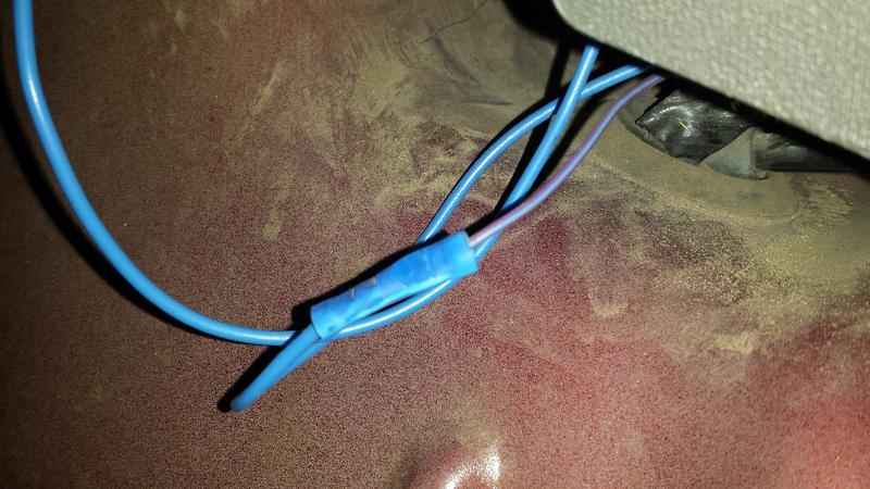

This thread shows two placements of the switch, one on the center console cutting the purple/light blue wire and one on the dash. Which wire is cut when installing on the dash? It is also mentioned that the original post had a ground wire but others are saying it only needs the wire to be broken. Does the system need to see ground or is just open circuit ok?
Old Oct 15, 2014 | 01:29 PM
  #110
Posts: 518
From: Page, Arizona
The purple wire with the straight light blue line. There is another purple wire with a light blue line that "twists" around the wire. I just spliced into the with the straight light blue line. Its up to you where you mount the switch. This is the wire to cut.
