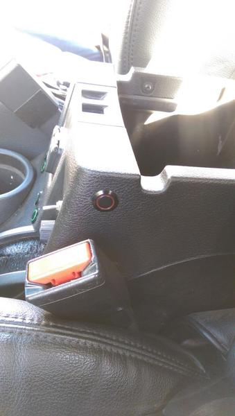

I used the flush-mount anti-vandal switch for sale on superbrightled.com or oznium.
