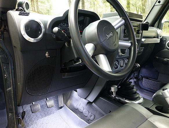

I'm using a very basic single throw toggle switch. Above driver side dash speaker.
Attachment 411868
Where do you splice into the wire if you want to install on the dash instead of the center console?

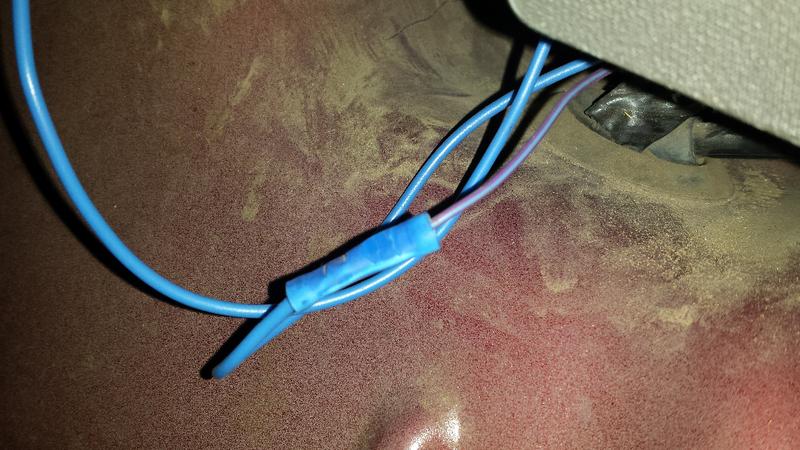

The same wire is behind the center portion of the dash. I pulled the carpet away from the drivers floor to find the same wire under there in a cluster. Easy to spot really. There are two that look the same. Make sure you get the right purple wire.

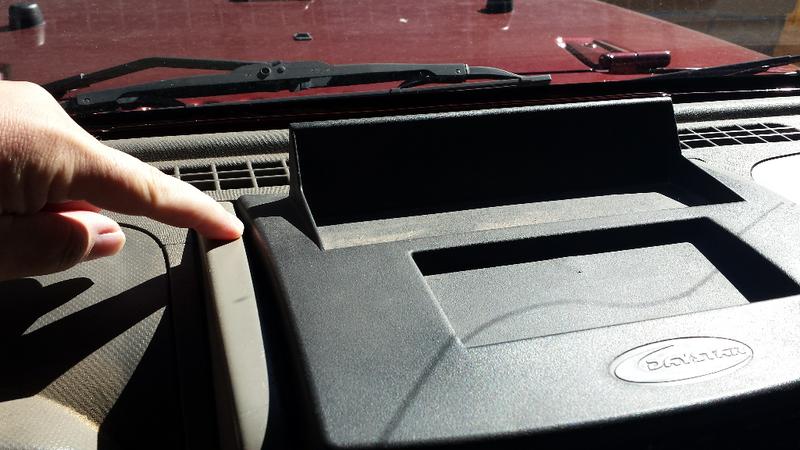

Right where my finger is, there is a clip on each side of the dash cap.

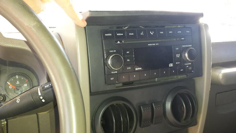

You will see 2 bolt head screws holding the dash plate in place once the cap is removed. Down by the shifter is a blank panel. Use your screw driver to gap the top of that panel. It pulls out easy, just be careful. Under that panel you will find 2 more bolt head srews. Then gently pull from top to bottom to pull the center dash portion out. The top bolt head screws are about where my finger is pointing

There are two purple wires that look similar. The one you want is purple with a straight Light Blue line on it. The other wire looks the same except the Light Blue line twist around the purple wire. DO NOT CUT THAT ONE.
