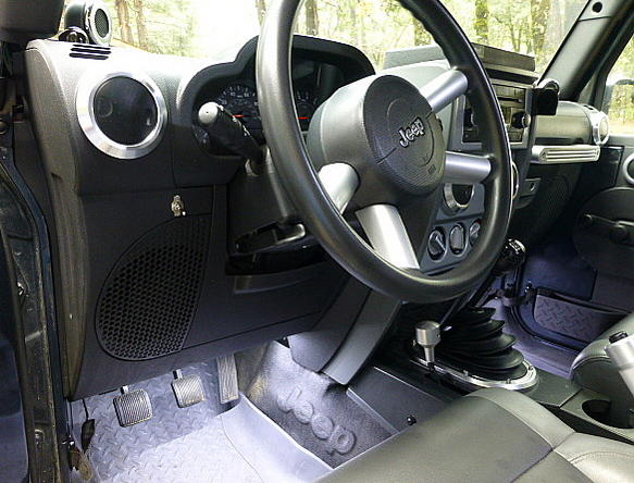

Originally Posted by 12HTownSahara
What kind of switch are y'all using for this?
I'm using a very basic single throw toggle switch. Above driver side dash speaker.
