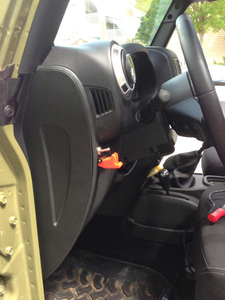

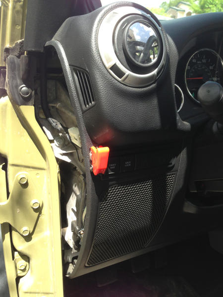

ESP Kill Switch Writeup
The reason the Steering wheel steps are done is because the Steering wheel angle sensor is part of the ESC system and to make sure it is calibrated right and not do it's job , if not for these steps, it could falsely think the wheel is in one direction and other sensors readings and cause you to have a major flip over, maybe during High speeds....That wouldn't be fun...LOL...
To Disable the system, not just Off, 100%:

Of course it does anytime, when you cut the line and install a switch, you are cutting the Can Bus comunication for all that the ESC consist of

The Switch use to be Labeled ESP which is all of the above as a system and the switch allowed to control just the ESC without effecting other features of the system.
So i would think by disrupting the switch completely will effect more then what some are thinking it does. Be Safe to any and all that have or are doing this Hack.

From what I understand, cutting the wire shuts everything off (as this mod was intended).
