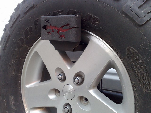

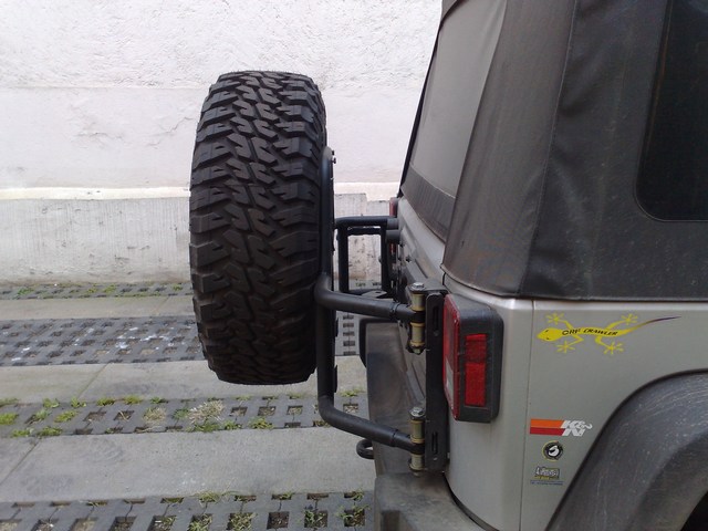

Fixed and welded my OrFab tire carrier and made my third light brake mod

How'd it work when you need to get the spare out???
