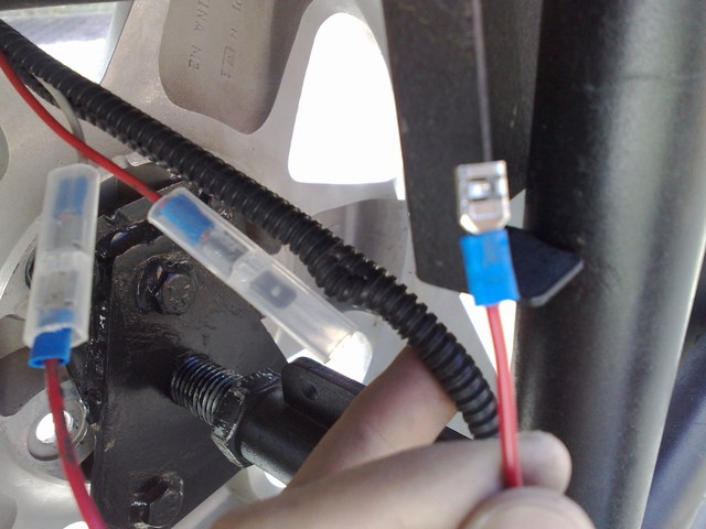

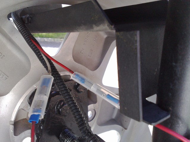

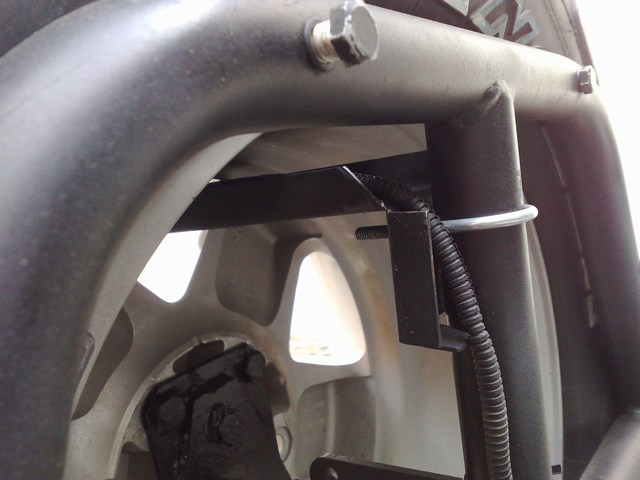

Originally Posted by interceptor_1972
How'd it work when you need to get the spare out???
It is not quickly but it is easy only unplug two wires and disconnect two nuts.
