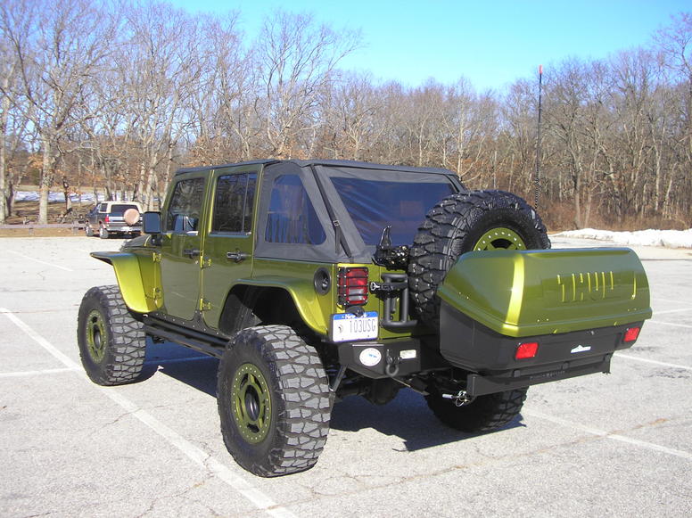

Great write-up. I installed an Or-Fab tire carrier and I tell you it took me a long time. To make your life easier, you must have a angle drill and a little luck to drill some of the holes they want you to drill. But I took my time and it came out great. I also attached my Hilift jack to the back. Hard to see with the Tule Carrier.
