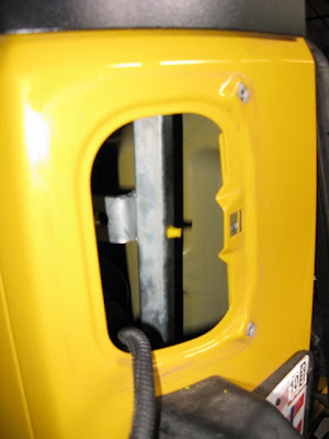

Everything went a-ok. I did it solo, no major problems. I was concerned about hitting the driver side holes correctly for the brace, so I put the support in with the tip of a yellow (of course ) crayon:

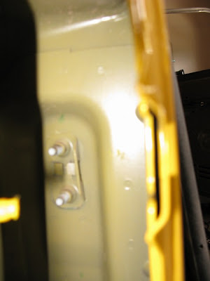

Which showed me where to drill in relation to the rivets for the top mount (this is a picture inside the driver's tail light and you can see the mark not quite 1/2 way up and off to the left between the rivets:

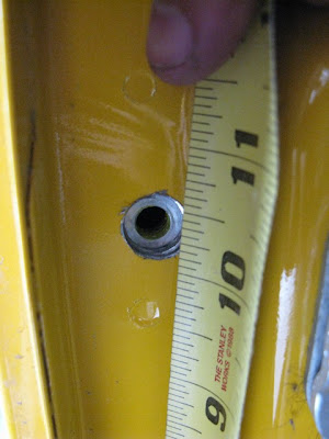

So I drilled from where I judged the hole to be, and bulls eye (turned out to be at 10 and 3/8:
I measured down 7 inches and hit the bottom hole.

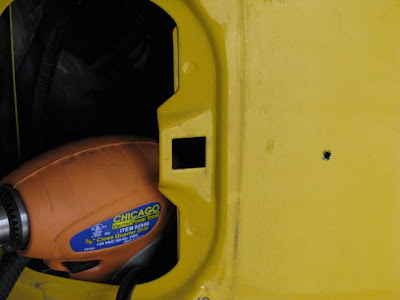

You can see the cheapo drill I used and the pilot hole. One note I'd like to make is be 100% sure you drill in the middle of the brace hole. I was off about a 32nd of an inch which caused my 1'in body hole to be off just enough where I had to take a manual file and file that amount away on the bottom of the hole. PITA! Not a big deal, but will save you some time.
