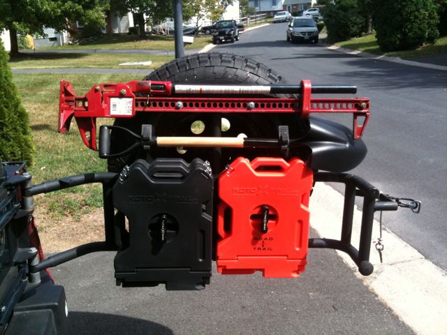

Default This is what i did m y my Or-Fab
Hi-Lift
Shovel attched with 2 Quick Fists
3 RotoPax Storage Cans
this thing is solid!

Originally Posted by stevedolce
Hi-Lift
stevedolce,
How are you attaching the RotoPax brackets to the cage. I am running military Scepter cans on my OR Fab carrier, but would really like to run the RotoPax setup. Any photos or a description would be awesome.
Old Sep 17, 2010 | 06:09 PM
  #130
stevedolce's Avatar
Posts: 1,300
From: germantown, maryland
Default Mounting Rotopax
you'll need the Polaris RZR plate from rotopax. it hangs down off the tube of the carrier. believe it's a 1.5 inch curve..attaches with a hose clamp. i needed to cut maybe 1/4 inch off the bottom of mounting plate so that it would fit right in the lower lip that supports the jerry can. i ran a bead of silicone along the edge to prevent rust. i can email you some pix if you would like.
i'm currently running 2 black storage containers for my tools(stacked back to back) and one ugly orange container for my recovery gear..
there not 100% waterproof, but better then any other solution i came across..
steve
