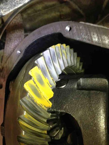

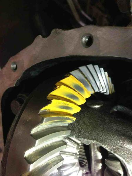

Did the rear today Click image for larger version

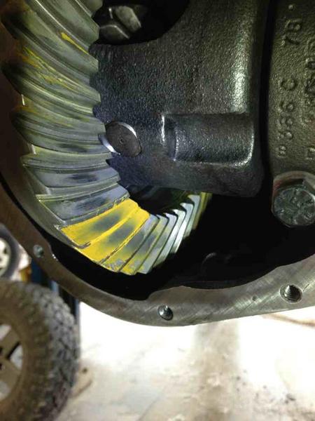

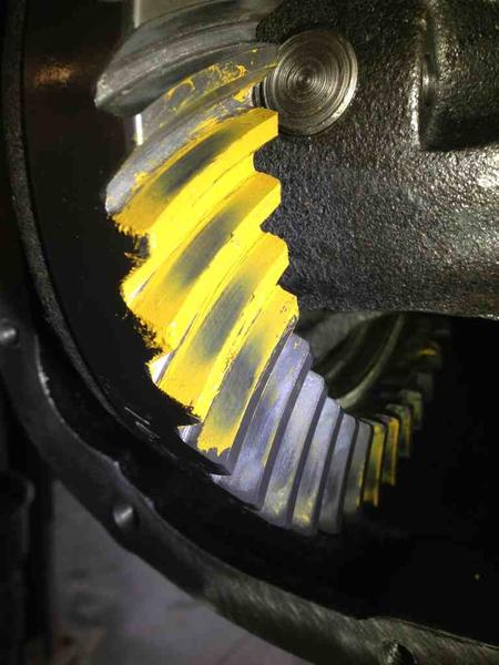

Front 30. The pinion bearing is larger then the pinion gear.

Did you replace the bearings or use install kit and not the master kit?
Old Feb 16, 2013 | 06:05 AM
  #100
XJ Jay's Avatar
Joined: Mar 2010
Posts: 189
From: peg,mb
I bought Motive master kits from northridge. They all have Temkin USA bearings but i only used new pinion bearings cause i was to lazy to replaced the carrier bearings.
And now the joys of doing your own gear installs, NO warranty
Not sure what or when this happened. Just changing the oil after break in and i guess i really broke it in. I was gonna take it on its first wheeling trip tomorrow but i guess ill take my XJ. Not to sure how much success ill have with warranty.
