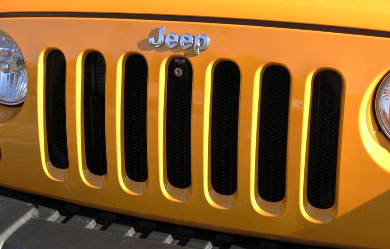

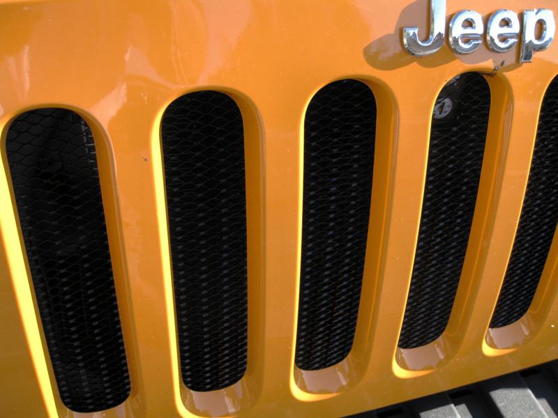

I wasn't able to find the same material from what I could see in the previous posts... the stuff I found (at Lowes) is called Gutter Guard but I think its a lighter weave. Anyways... I've posted pics of the finished results. Same basic principle... I used 1" tie wrap anchors, removing the 2-sided adhesive tape, then using Gorilla glue to adhere them to the back of the grill. I did find the threading of tie wraps to be a pain until I came up with a method by using a narrow straight blade screw driver to guide the tie wrap thru the anchor and then back up through the mesh.
ID:	338042Click image for larger version
ID:	338043Click image for larger version

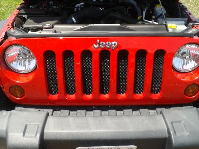

Just did mine.
