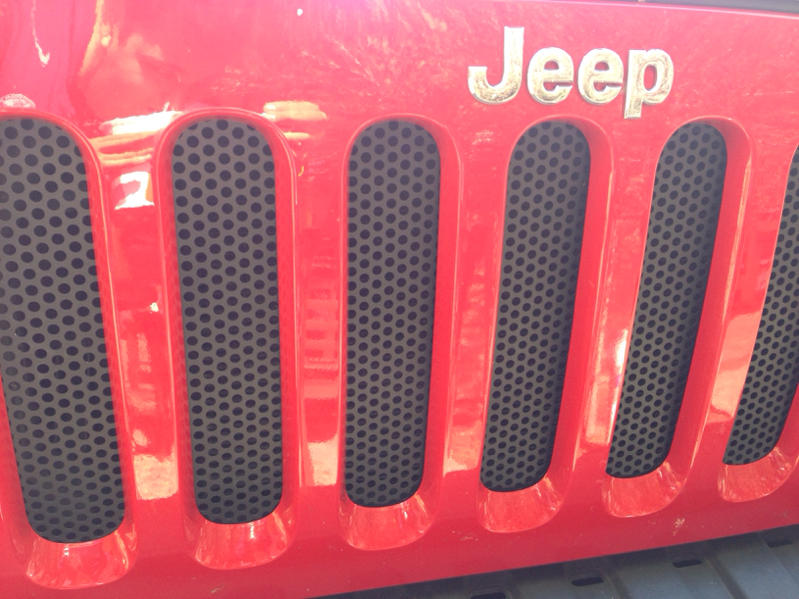

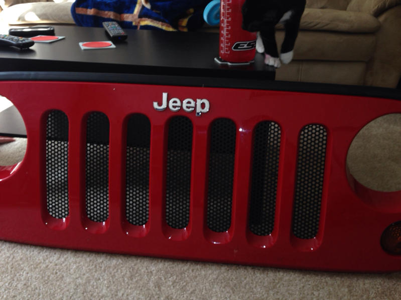

Used 1/4 20 ga aluminum for mine, plasti dipped it black. Pretty sure it did flatten the grill out once I re installed but not very noticeable. Just has to push a bit more to clip it in. Pretty easy install with tin snips and some patience on the zip ties [center=32.748677,-117.152028&zoom=14&markers=32.748677,-117.152028&size=400x300&sensor=true[/IMG]

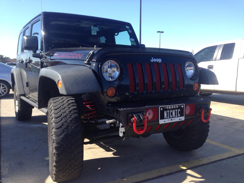

Completed my version of this mod with the plastic bumper removal mod as well.

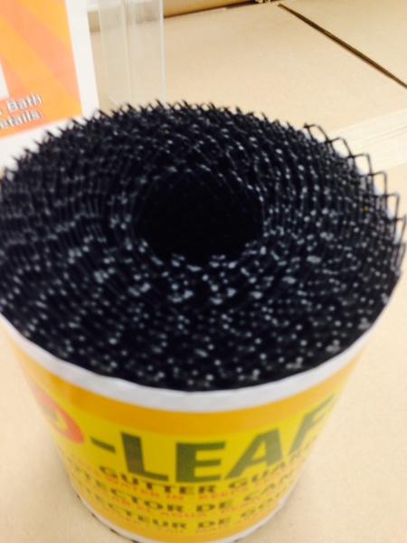

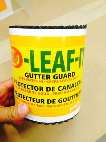

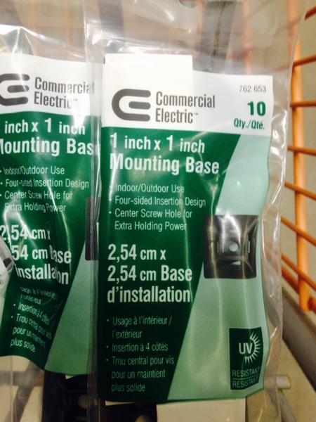

SO i got everything i needed for this Mod from Home Depot.
Ill document it with pics but here are the parts i got, total $20.

I used the lock tite epoxy, plastic gutter guard, and square wire tie holders. Removed the double sided tape from the square wire tie holders, and scuffed the holders, and where the are epoxied. I have no problem pressure washing it and it is holding up without problems.
