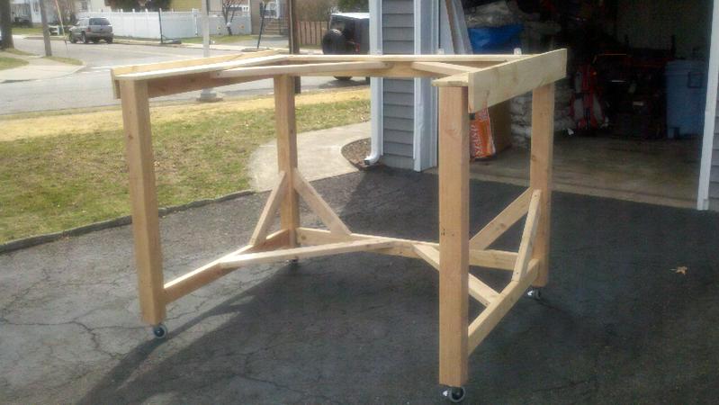

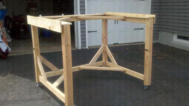

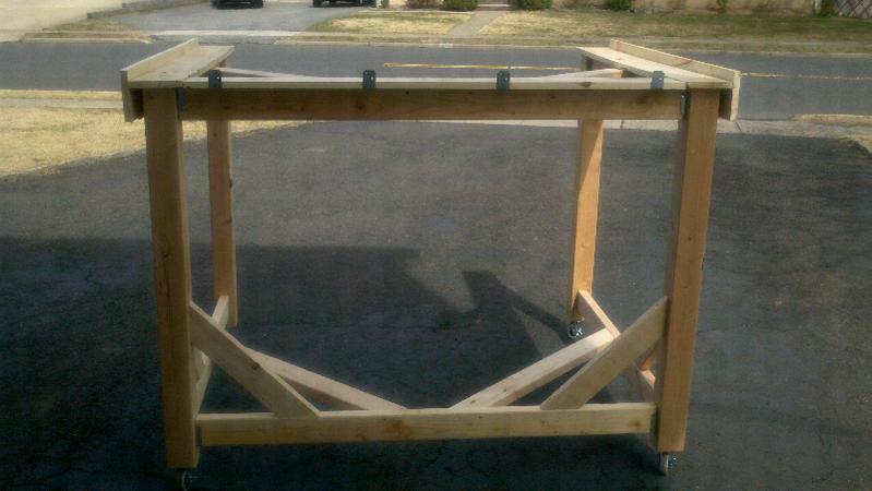

I just made mine....put side rails and a backstop....also added 3" locking casters so I can move it in the garage if need be....now just need some nice weather here in jersey to actually use it...
ID:	149900   Click image for larger version
ID:	149901   Click image for larger version
Ohhh, I like the side rails. Will be doing that very soon to mine!

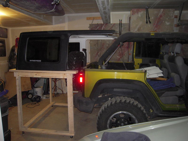

I whipped one together last night using 2x4s and a 2x6 for the top even added some scrap 2x4 for a lip after the top decoded to widen a bit while sitting on the, um, "rack".
got it on casters too so I can move it in the garage. need to change to all moving casters as its interesting trying to manuever this thing with two fixed casters!
the thing is super easy to use! cost about $25 in supplies (wood, casters, screws) about an hour to put together and maybe 20-30 min to take the top off.

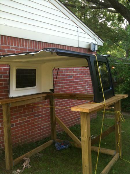

Was nervous taking it off, but wasn't that hard at all, just took my time, my wife spotted me.
Putting I back on was even easier. Wife wasn't there.
This thin is a great help'
