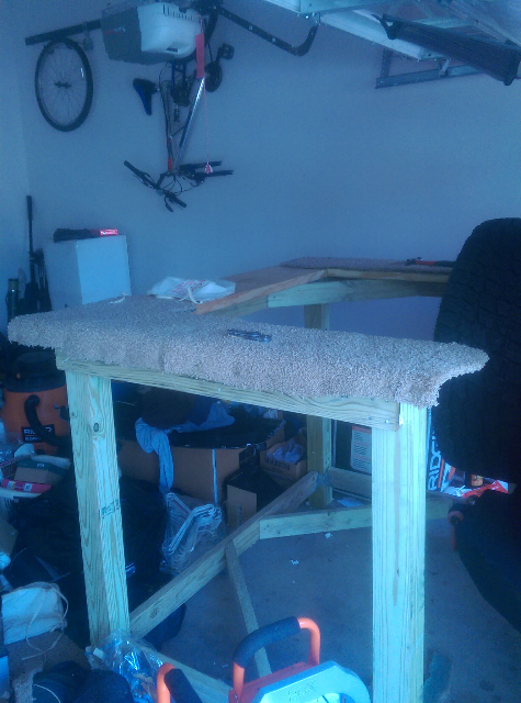

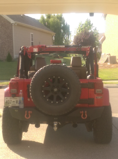

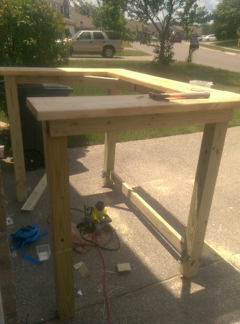

Just made mine this weekend. Thanks for the post. So nice to finally get to take the hard top off for the first time.

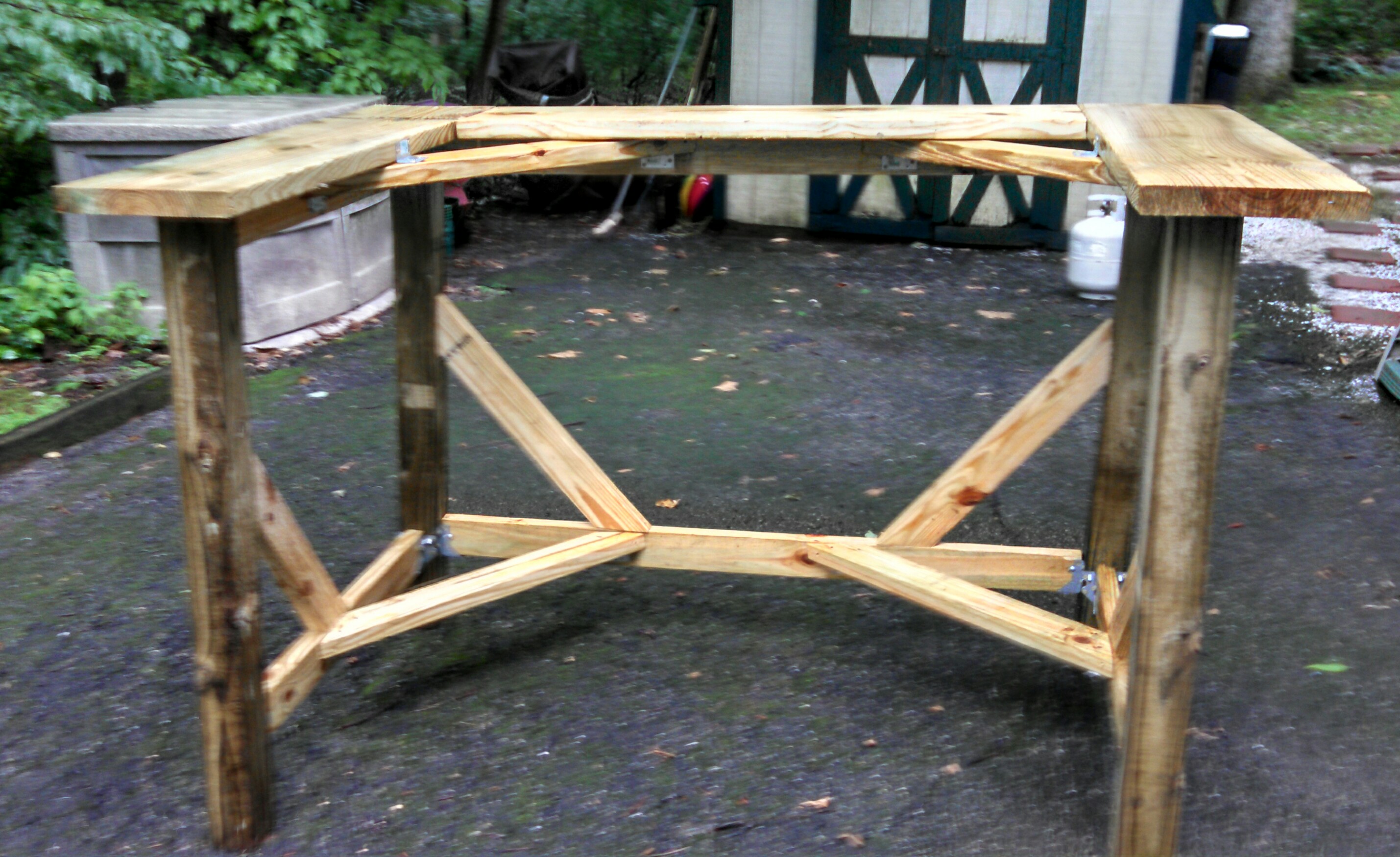

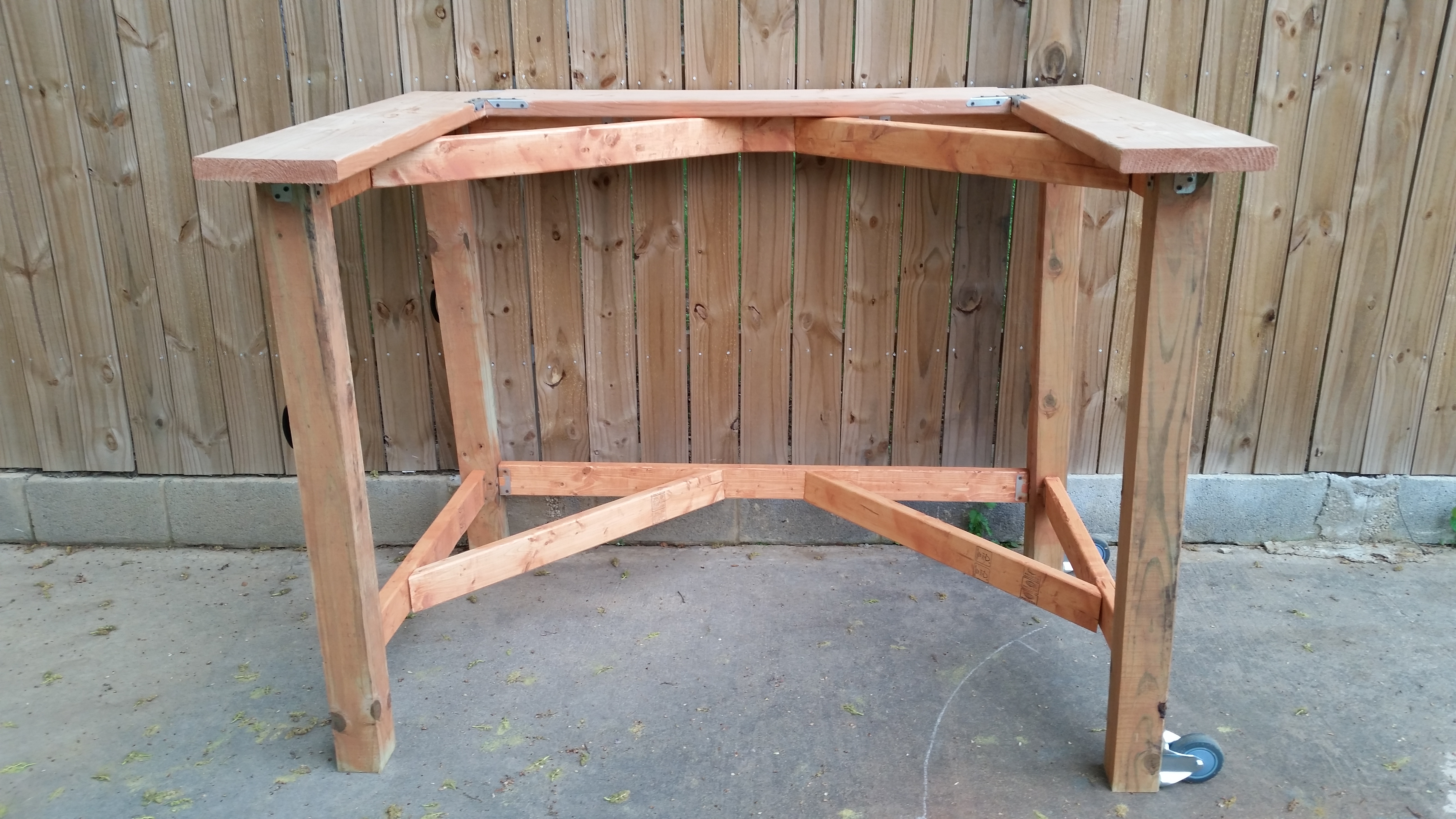

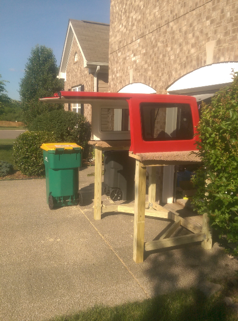

First thanks to the OP for sharing this idea. Made one today. Took about 4 hours with my almost embarrassing carpentry skills and cost about $80 for all materials and a saw blade. Added a few extra braces and its rock solid. Once all the screws were out it took only a minute to slide the top off. Haven't put the top back on yet and am wondering how hard its going to be to line up the jeep to the stand and get close enough.
Any suggestions?

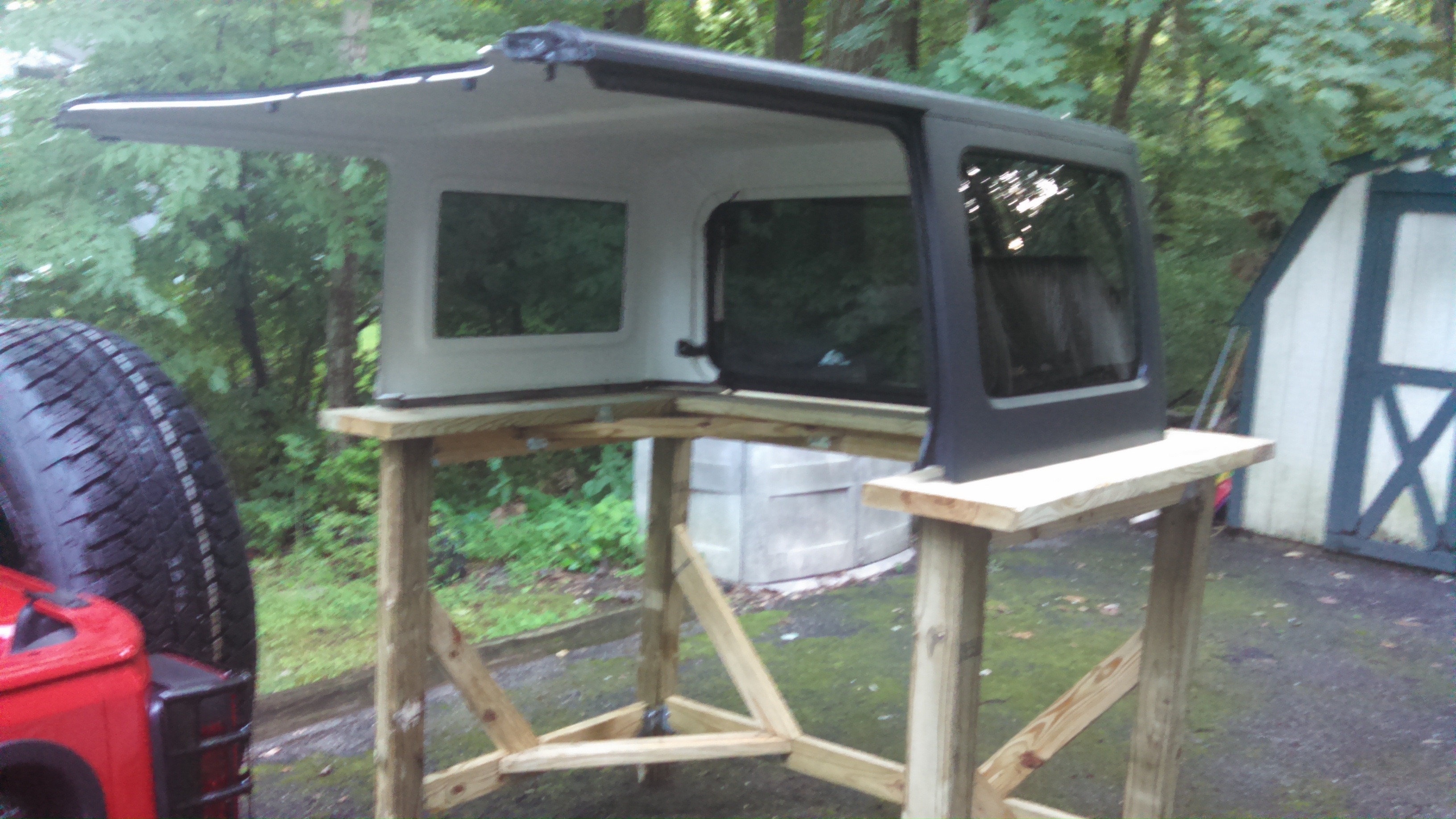

Put the hardtop back on. Backing right up to the table was no problem. Just lined up the highmount middle brake light with the middle of the top and was dead on center. I couldn't believe how super fast and so easy it was. The hardtop slide effortlessly along the table and right onto the jeep.
Thanks again to Sgt P. Any time you can get a top off easier it's a good thing.

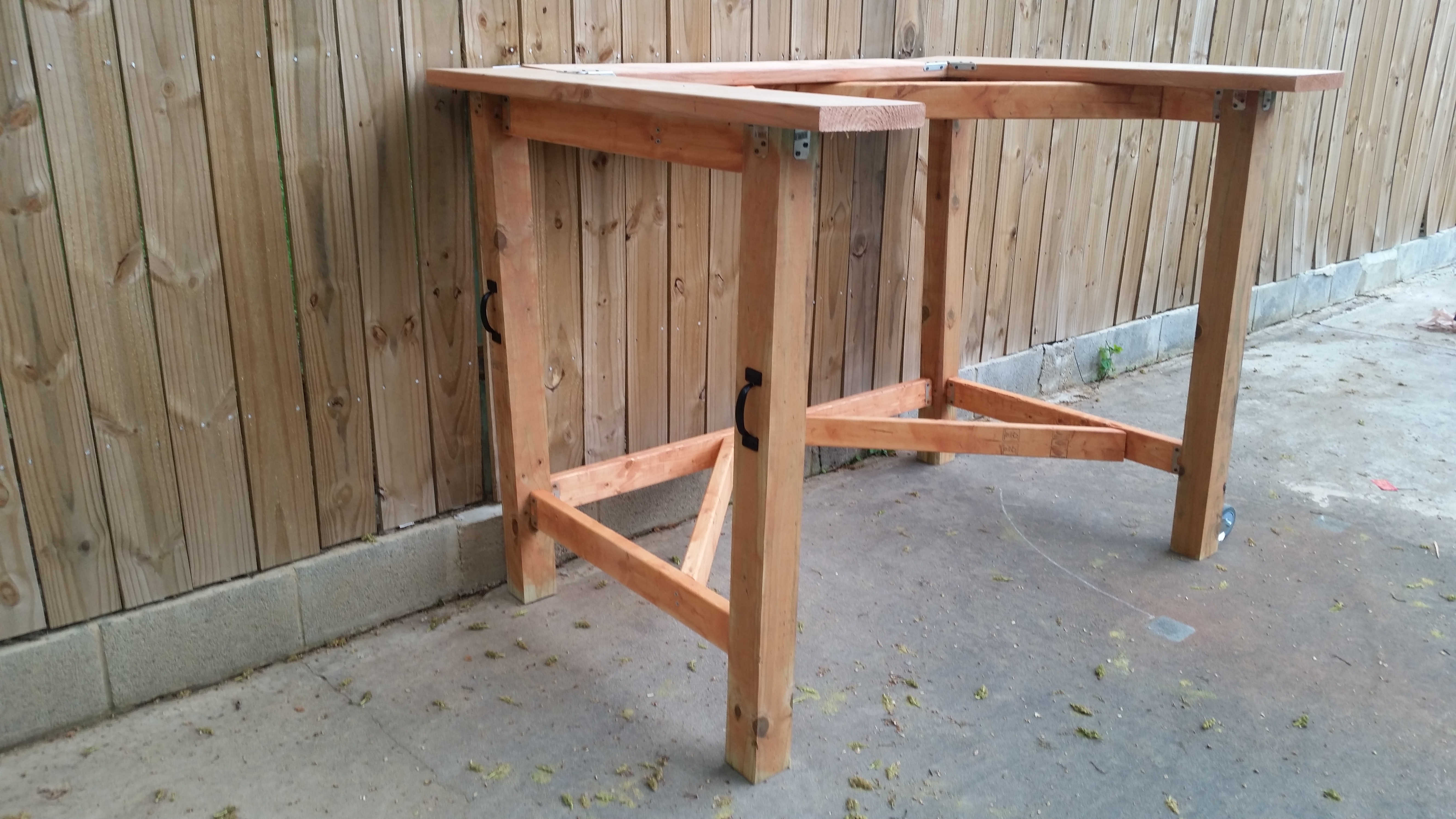

I added the wheels to the side and attached handles for easy lifting

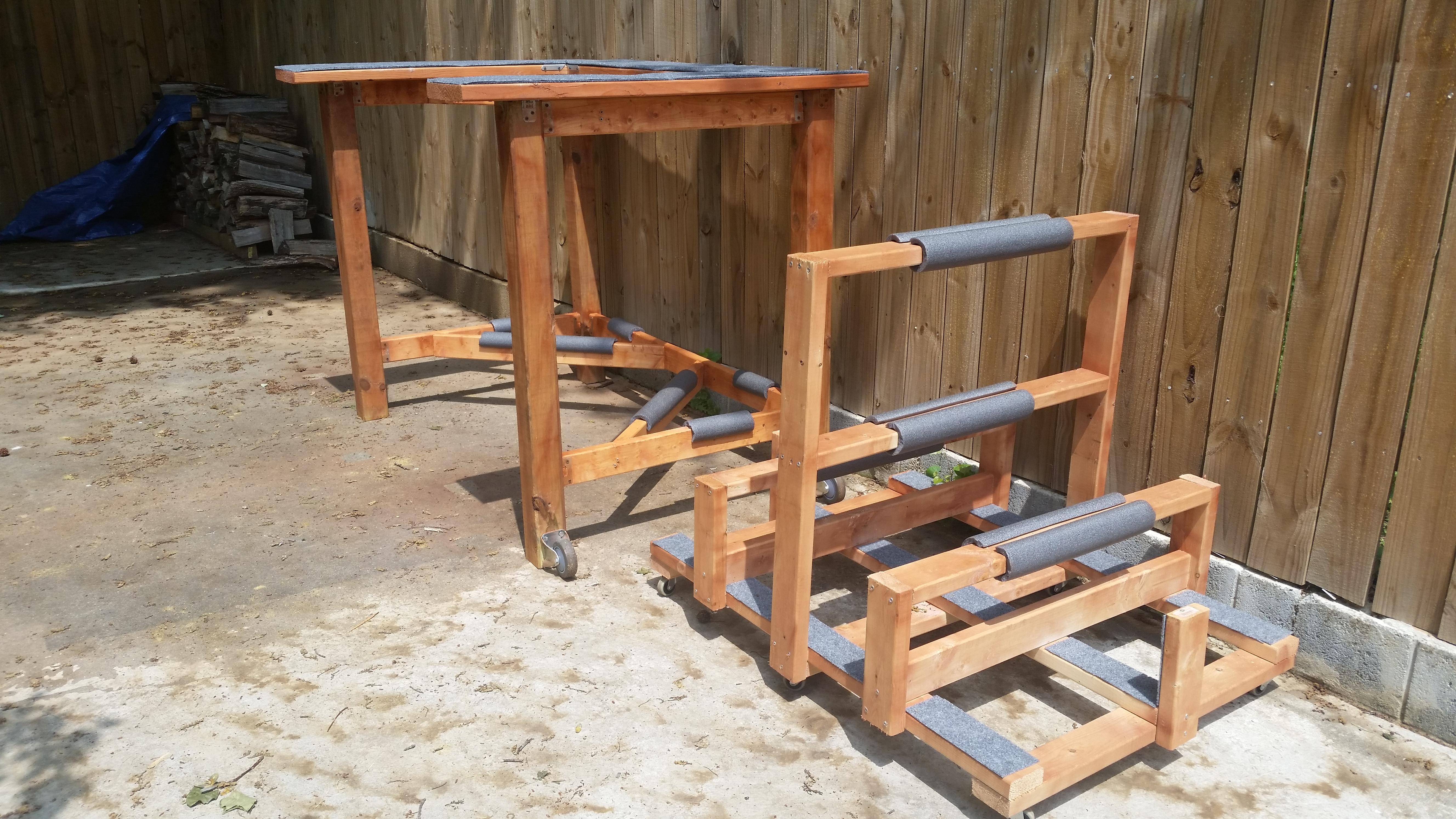

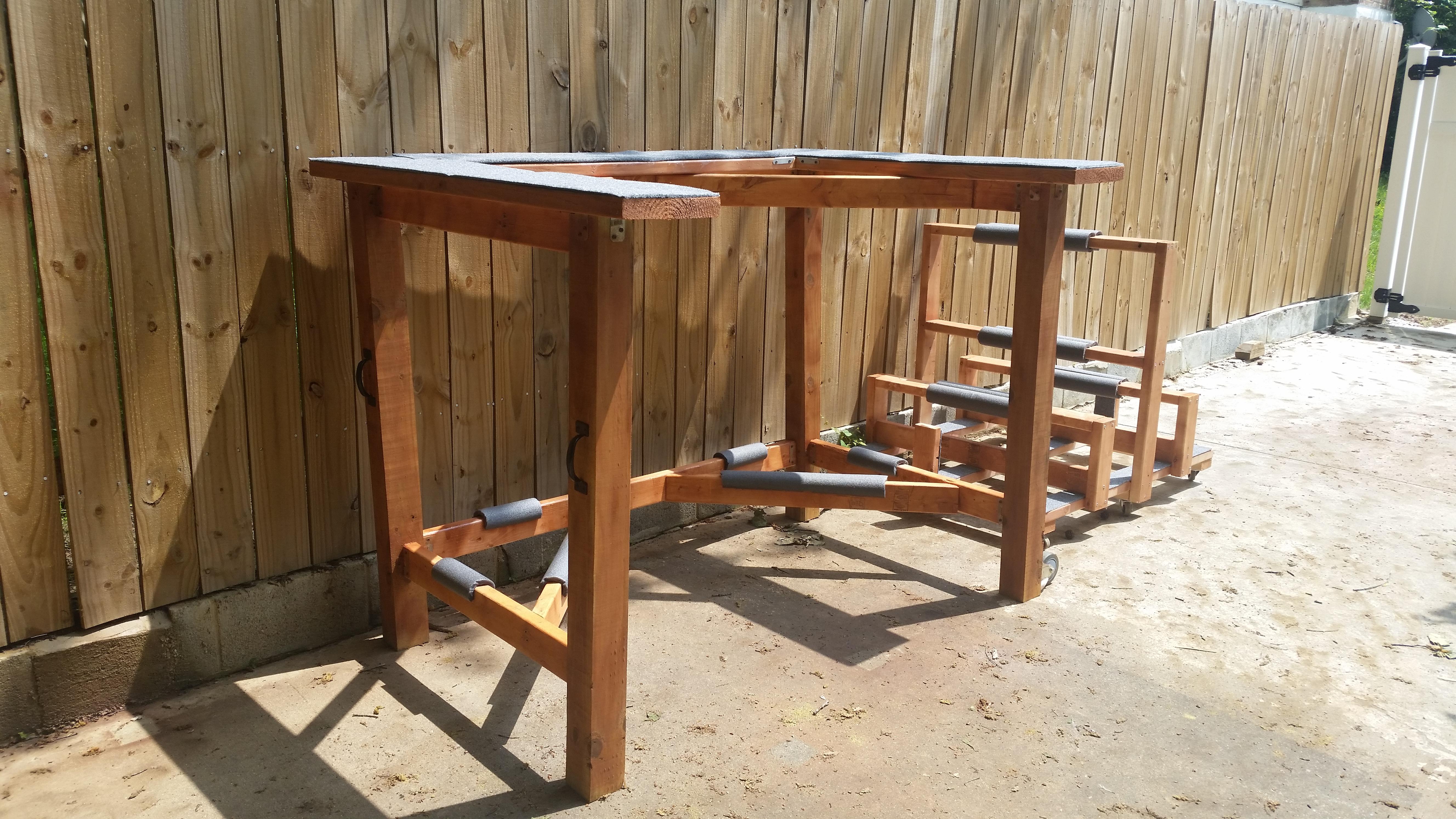

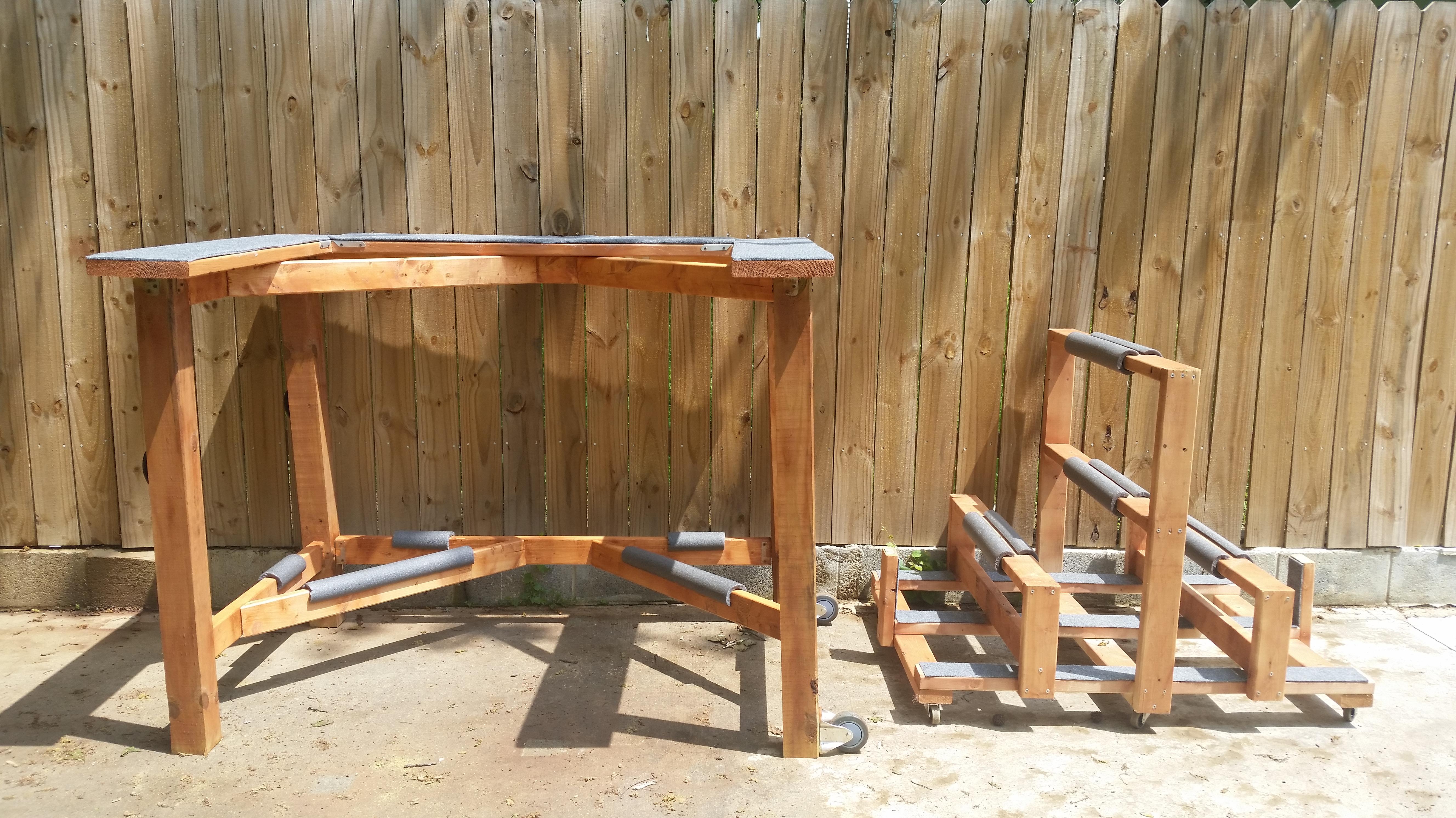

Finally completed it with a few modifications. I no longer need help removing the hardtop! So easy to take on and off. Decided to make a door cart too. Took the top and the doors off for a drive and was able to put everything back on in no time. Awesome idea!

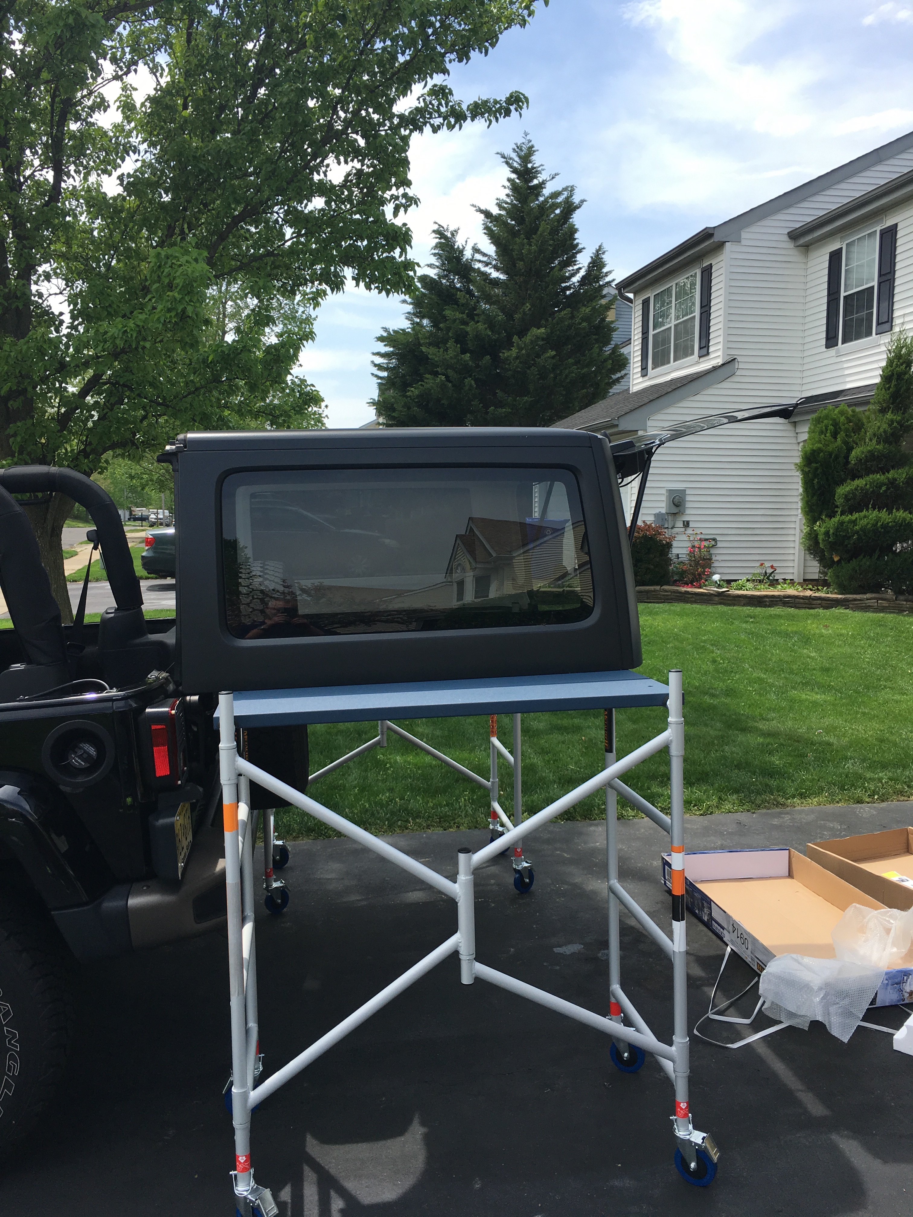

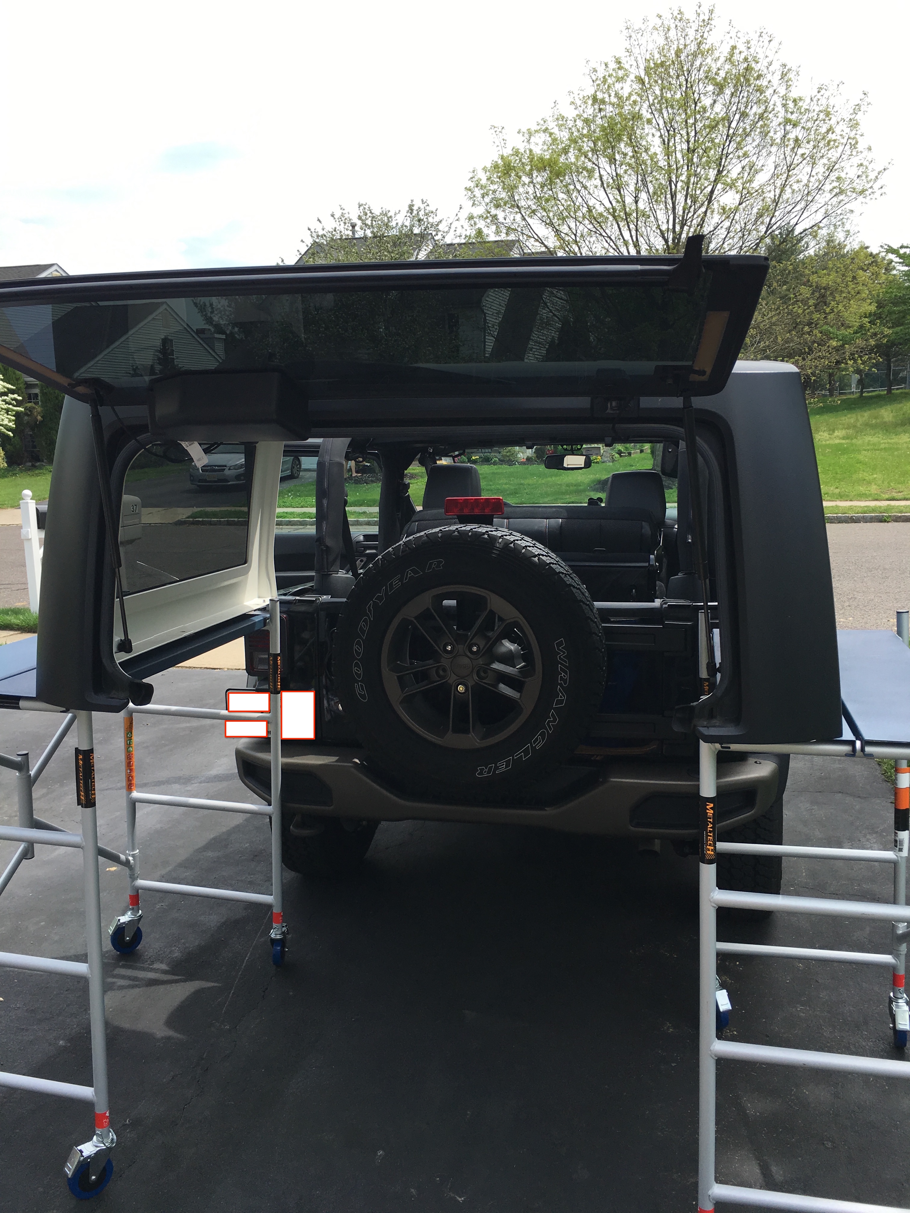

This scaffolding from home depot works perfectly. And its extremely portable. Can be used for other things around the house too.
