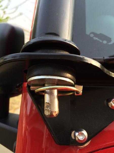

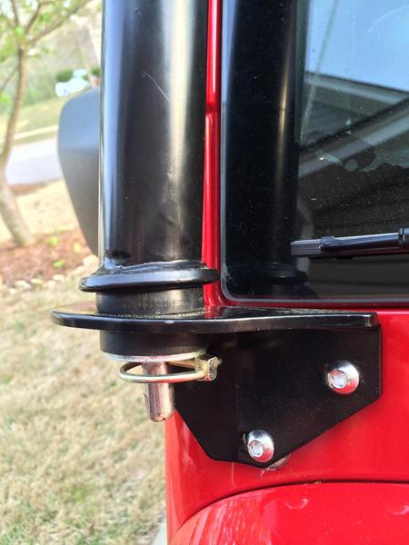

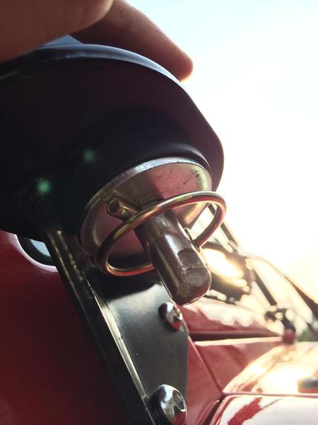

Smile Wind noise issue is quite annoying
Hey Folks!
So much good information on the thread! I bought a KM Congo cage for my 2014 JK 4 Door about 2 weeks ago, and the install was as people described, not terrible, but required some creative interpretation of the instructions.
I am happy with the cage quality, but also had the alignment issues with the front bars as well as the wind noise. I ziptied a 2 foot long piece of Aluminum angle iron to the front which took care of the hum, but the rushing sound sounds like a jetliner following me above my roof at any speed over 55. I ordered the KM 60161 wind deflector and it should be here on Friday - will let you know my experience with that, but I pray that helps because right now it is not workable.
In terms of releasing the front of the cage, I didn't like having to remove 2 bolts every time, so I fabricated some quickreleases for myself, and they are working great! Here are some pics:
