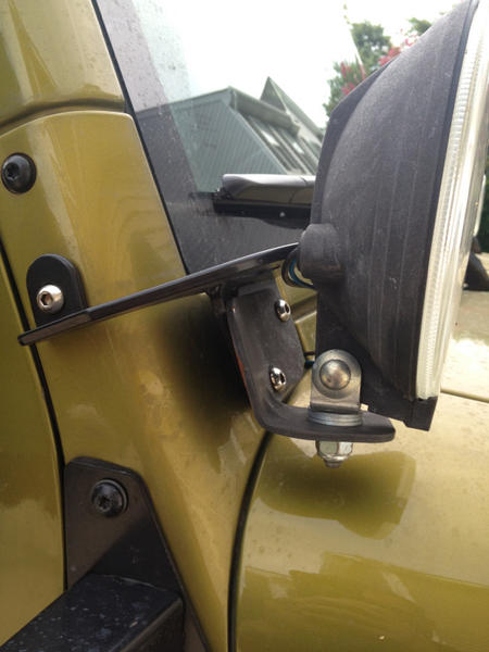

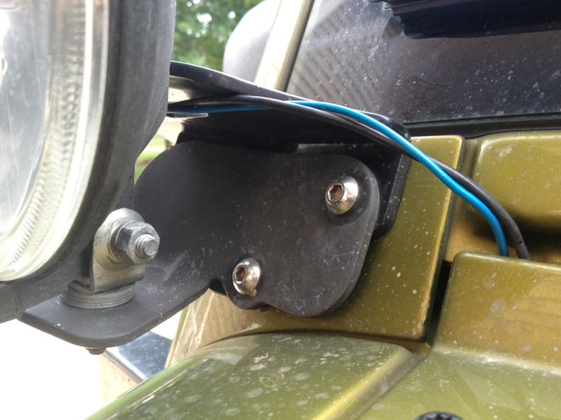

I did the same as Batman and it's been over a year now with no issues. Just took a mallet and a vice and bent the Smittybilt mount just enough to sit flush with the rack mount and then bent the light mount tab down a little for a better angle of light.

Just snapped these. Hopefully they'll show you what you need. It's a little hard to get a good pic but if you need others, just let me know. I have taken the rack off for a little bit because we were moving but I'll have it back on shortly.

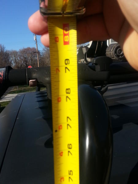

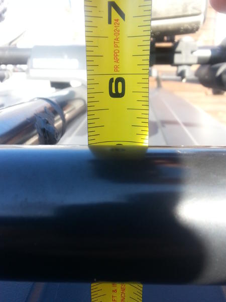

Not the best. Rack itself sits 5inches above hardtop front center and back. Stock Sahara no lift here's what I got.
ID:	542166Click image for larger version
ID:	542167Click image for larger version
First is the front, not great but measures at 74 rear is 78, 79 i think. Hope this helps

So, the 5" measurement you noted is what I was looking for, so thanks again! That is pretty uniform across the top from front to back? And that is as tall as it gets before adding accessories or Thule/Yakima rack on top of it?

Yep, 5 front to back. Just ran out to confirm, front is little less, call it 4 and 7/8ths. Enjoy if you pull the trigger it is a solid rack. Do the rope wrap trick to cut on wind noise and some of the other tips people suggested. Have fun!
edit: yeah that's pre any rack attachments ie yakima, saddles, etc etc.
