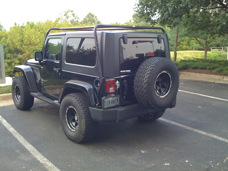

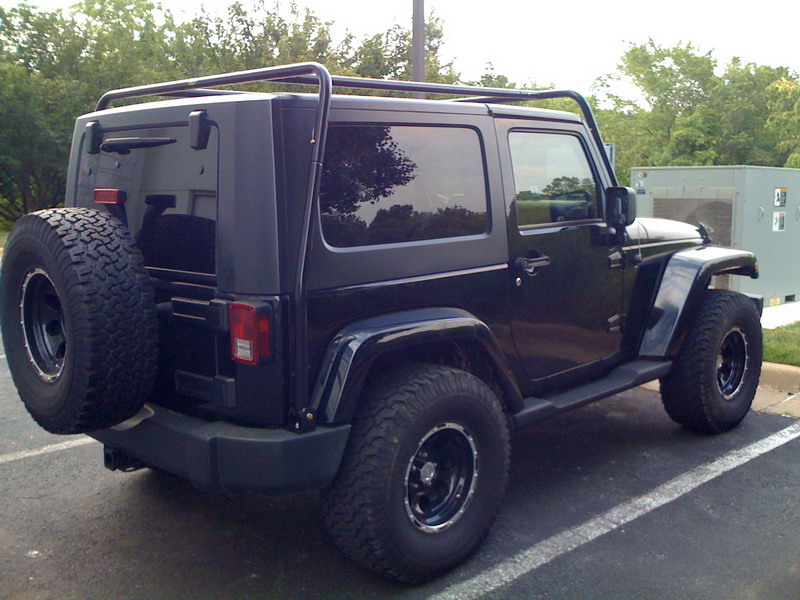

I just about have mine installed.
I have found three problems with my rack so far.
1. The silicon was dried out and useless.
2. Where is says to use bolt D in the first section of the instruction should have been bolt S. I think I destroyed the nuts inside of the windshield.
3. The spacers (part M) for the rear bumper were not made correctly and as a result the I couldn't put them in place correctly.
I just have to get the rack set in place on the brackets and then bolt everything in place.
x2, or more, on the instructions.
Somewhat vague, and, in places, flat-out incorrect and misleading.
. It definitely takes a personal interpretation and a bit of thought, but it will go together with a little work.
I definitely didn't follow the instruction steps, but put the supports on the Jeep, then attached the U-bend bars in the front and back, then added the longitudinal bars that cover the roof last of all.
I did 99% by myself, and had my wife (in a skirt and heels, no less
....ya, I was making us late in leaving) assist with the last step of connecting the front supports to the back supports with the long roof-tubes.
I'm attaching my Yakima bars shortly, and will be loading up a few canoes for a 4th of July float trip, so I'll report when I get back. The Yakima bars are because I usually carry bikes in the summer and skis in the winter, and I hope to supplement with a locking roof-box of some sort since I like traveling with my dog, but he takes up entirely too much luggage space at 190lbs.
So far, it seems amazingly stable, and didn't move much at all even when I was flat out jumping on top of it (I'm 175lbs). I anticipate that the Yakima bars will add further stability as they will prevent further movement. Finally, while it does make the Jeep a little louder, it seems loudest around 40-50mph. Below 40, it doesn't make much noise, and above 50 the Jeep's flying-box aerodynamics take over to ensure that ultimate gas mileage and that quiet for which we all purchased our lovely 'little' toys.
Hey, at least I can park on top of other people's cars.
Overall, I guess I should be grateful that my silicone didn't explode, huh?
. It definitely takes a personal interpretation and a bit of thought, but it will go together with a little work. I definitely didn't follow the instruction steps, but put the supports on the Jeep, then attached the U-bend bars in the front and back, then added the longitudinal bars that cover the roof last of all.
....ya, I was making us late in leaving) assist with the last step of connecting the front supports to the back supports with the long roof-tubes.I'm attaching my Yakima bars shortly, and will be loading up a few canoes for a 4th of July float trip, so I'll report when I get back. The Yakima bars are because I usually carry bikes in the summer and skis in the winter, and I hope to supplement with a locking roof-box of some sort since I like traveling with my dog, but he takes up entirely too much luggage space at 190lbs.
